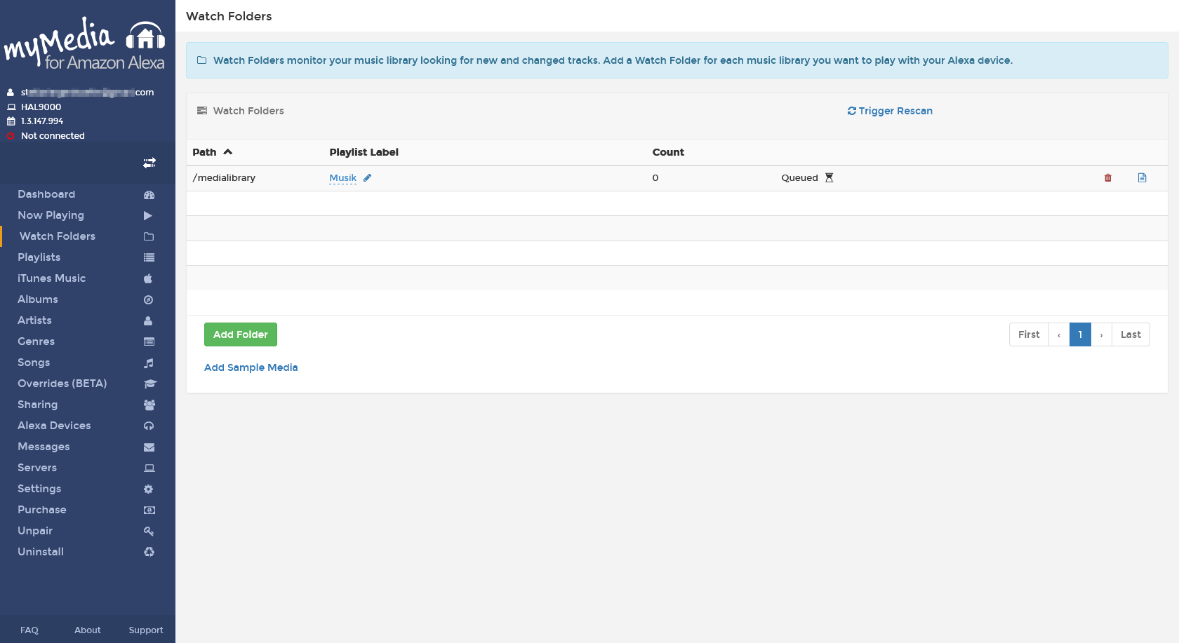

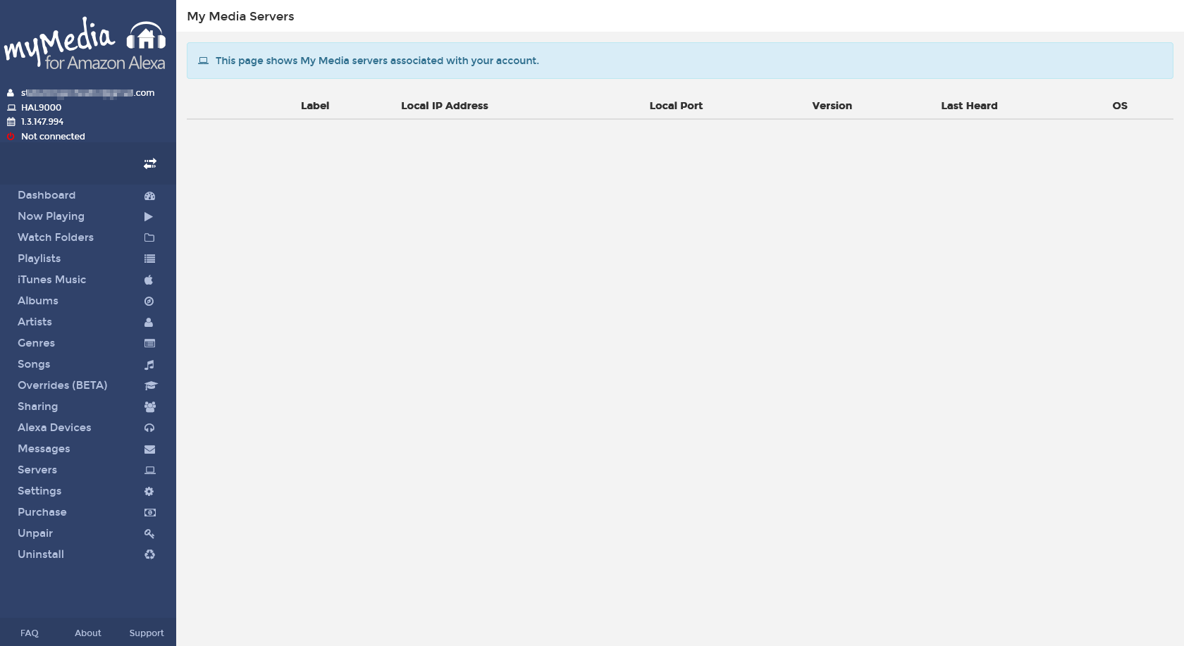

Aloha *.*'s,
I am sorry, but I can't get this off the Ground.
I installed the Container and got the Alexa-Skill. I can access the WebGUI and paired it with my Amazon-Account BUT I can see in the WebGUI that my watchfolder is "queued", and on the Servers page there is no Server. Furthermore in the upper left of the WebGUI I can see my correct Email-Addres, but directly below a "not connected".
What I am doing wrong? Any Ideas?

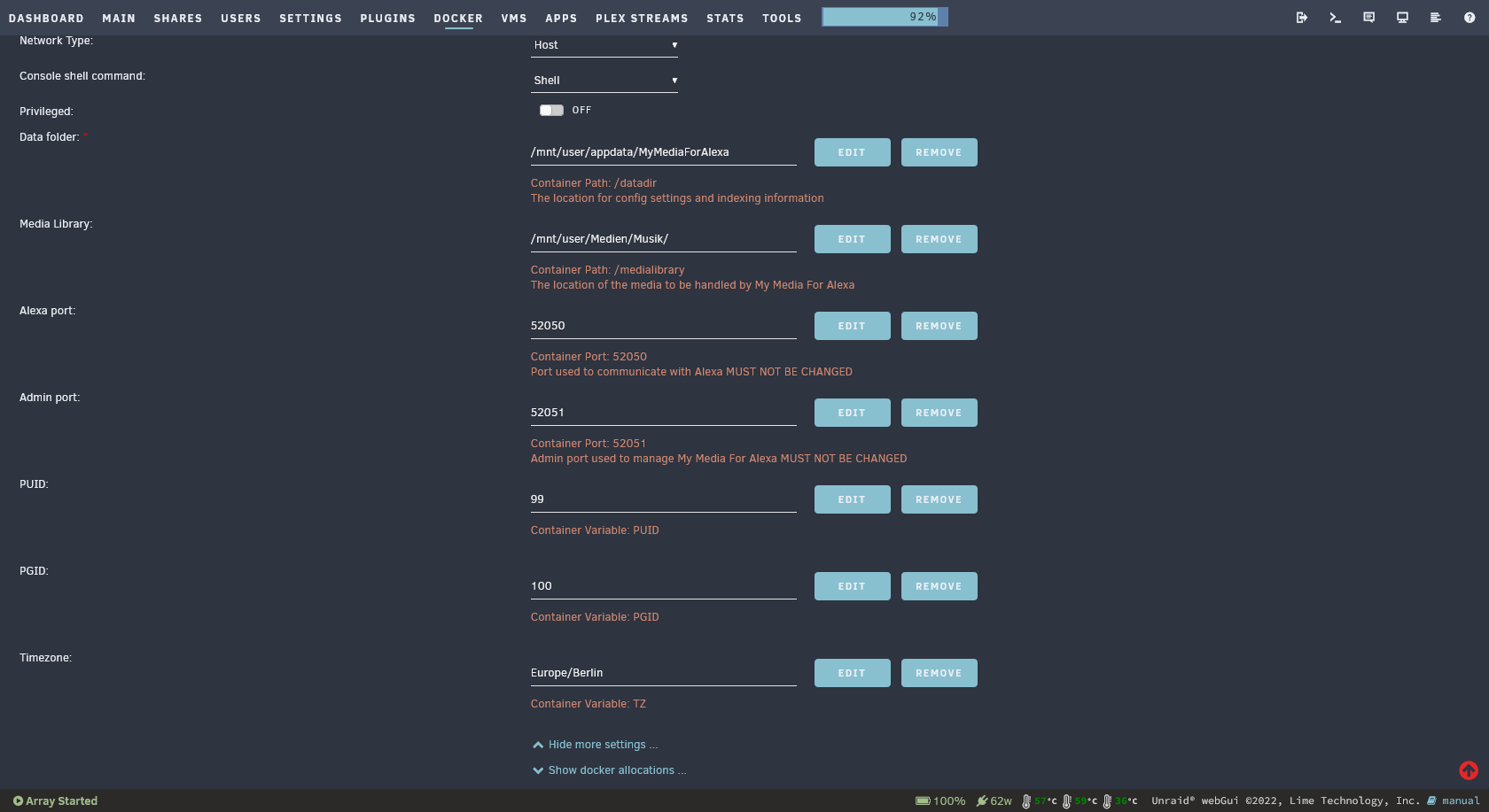

Not quite sure what might be going wrong - for me it “just works”.    Maybe post a screenshot of the docker settings you are using for the container.   You should be able to get the server component working regardless of whether the Alexa skill is installed.
Here are the Screenshots. I've only added the PUID, PGID and TZ manually for troubleshooting.

On 9/21/2022 at 1:21 PM, Moppen said:
Aloha *.*'s,
MyMediaForAlexa.log2022-15-21-011514.zipUnavailable
Not sure what is going wrong for you, but you should be able to get the server side running irrespective of whether you actually have the Alexa skill installed on a echo device.   In particular you should be able to get the server to show up in the Servers page.
You can try asking on the MyMediaForAlexa site to see if they have any suggestions.   The docker container is exactly the same one that is deployed on other platforms - the only Unraid specific part is the creation of the template that provides the parameters that would otherwise to be provided via a docker run command.
It looks as though the docker instance is not connected to your Amazon account :)  Have you tried unpairing to disconnect from your Amazon account and then repairing to link the server to your Amazon account?   This should clear the Not Connected status shown in your screenshot.

I am also running into the the issue as @Moppen
Response status code does not indicate success: 500 (Internal Server Error)
during pairing.
Any idea why this is happening?
UI says "not connected" and folders are stuck on "queued" :/
EDIT: completely unlinking the skill from the alexa app and relinking fixed this problem :)
