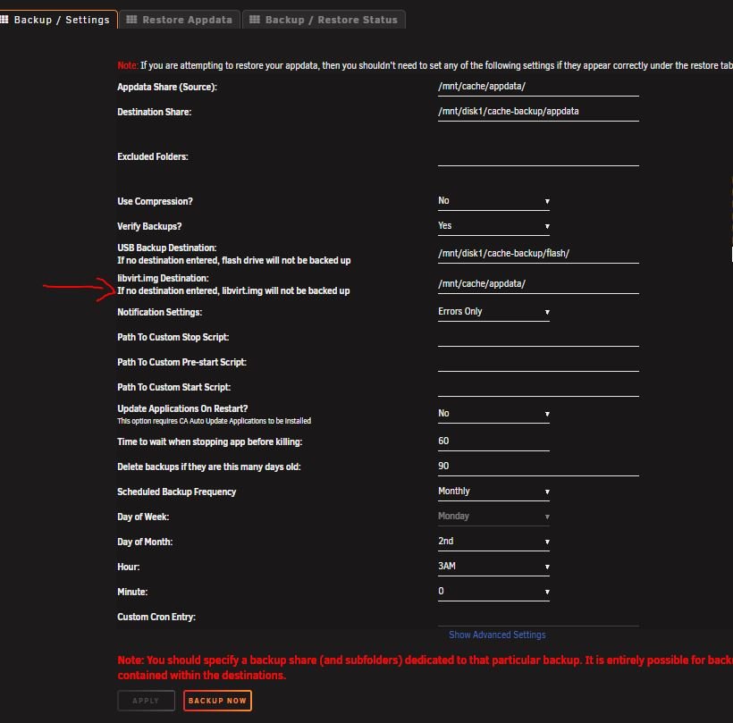

October 20, 20205 yr Hello, Hope this is not an 'out of line question' What is the purpose of the libvirt.img? Is it created when you ONLY deploy VMs within the UnRaid environment? I am using CA backup plugin, and have this set to backup, yet I am not seeing any libvirt.img in this location I currently do not run any VMs on my UnRaid array. Any clarification would help. Thanks. Edited October 20, 20205 yr by bombz
