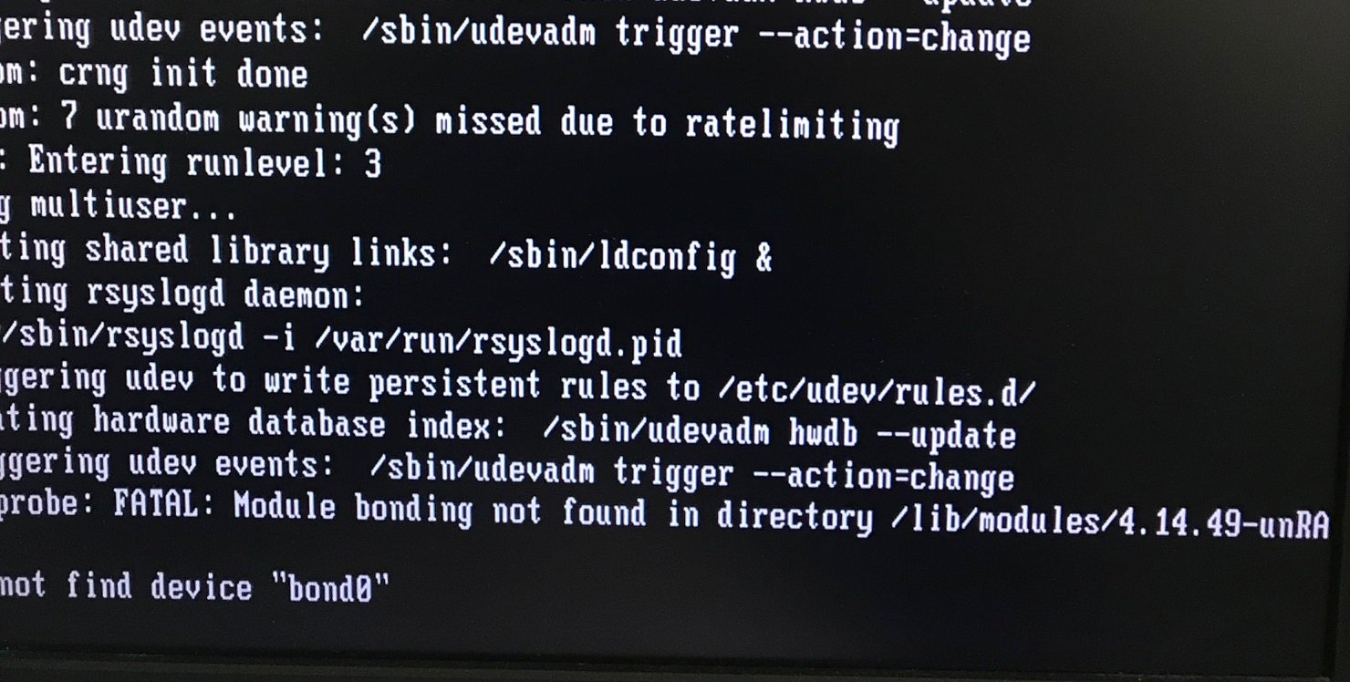

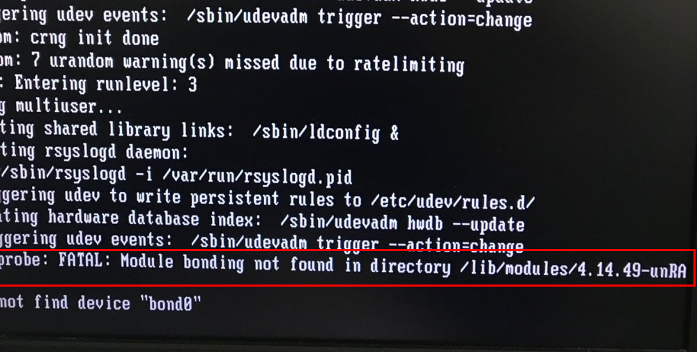

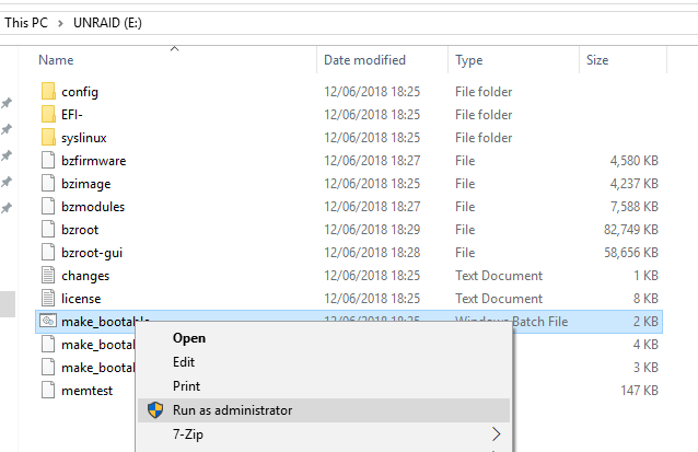

I formatted a flash drive using FAT32 and named it UNRAID, downloaded the unraid zip image, unzipped and copied the files as per the instructions video on the site. also followed the instructions to right click on the file make_bootable do as needed. that did not work, so next, i formatted the USB drive and used rufus, but still no luck. each time i boot into image, it boots up and ends up with the following error (attached a screenshots)
probe: FATAL: module bonding not found in directory /lib/modules/4.14.49-unRAID
not find device bond0

U n eed to run the make bootable as admin, u say its n ot working. What exactly is not working?

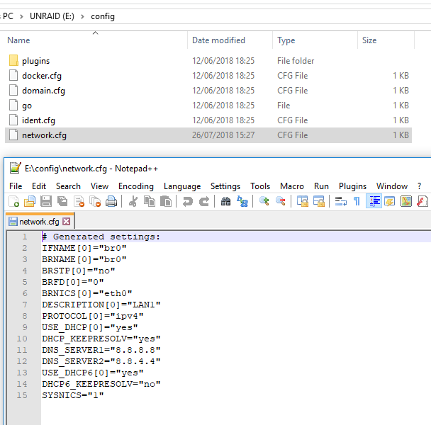

Also try to replace your network.cfg with
# Generated settings:
IFNAME[0]="br0"
BRNAME[0]="br0"
BRSTP[0]="no"
BRFD[0]="0"
BRNICS[0]="eth0"
DESCRIPTION[0]="LAN1"
PROTOCOL[0]="ipv4"
USE_DHCP[0]="yes"
DHCP_KEEPRESOLV="yes"
DNS_SERVER1="8.8.8.8"
DNS_SERVER2="8.8.4.4"
USE_DHCP6[0]="yes"
DHCP6_KEEPRESOLV="no"
SYSNICS="1"

Hi, thank you for the prompt response.
i wish i could tell you what the issue is. but i don't know myself what is going wrong at the moment, all i can do is relay the error messages i am seeing.

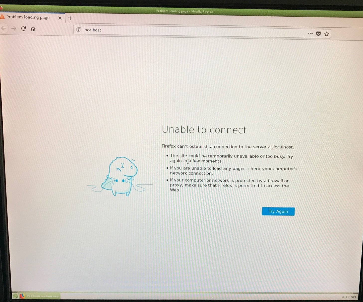

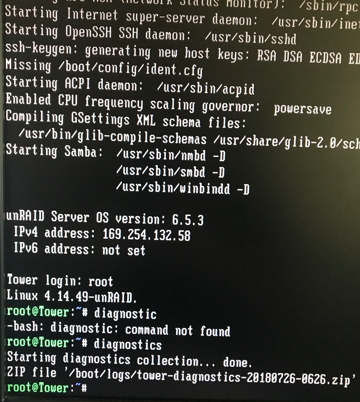

I have carried out steps 1-5 (please the screenshots) and plugged the USB in and boot the server up. the installation completes, but when i login using root and no password, i get prompted with a web browser (see screenshot 6), which has the address "localhost" but no page.
System boots obviously, so no need to do this.
Can you upload that diagnostics file?
I guess there is a NIC driver issue with your onboard NIC.
Syslog will hopefully tell us more.

Your flash device contains the bzmodules file which is mounted during startup, but not accessible here. Usually happens when there is some problem with the flash device.
