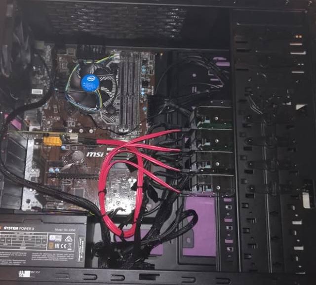

I've got another 3 questions.
First question / issue :
Today I swapped out the MSI H110M Eco for the MSI Z170A Pro because I got a really good deal on the Asus Maximus VIII Hero Alpha and Corsair Vengeance DDR4-3000 2x8GB Red LED for 110 euros. Mobo is from the 1st of August, everything's sealed and works fine. Somehow I even get 5 degrees Celcius lower on my i7...
While doing that I also added the RocketRaid 2720SGL with a SAS to 4x SATA cable to my NAS.
I put some games on my NAS to boot off from on my 2nd gaming rig (since it's only got a 120GB ssd).
I noticed that the files, like for instance the gameplay I record from the gaming rigs, ( HDMI port -> HDMI Splitter -> HDMI switch -> AverMedia HD Lite -> NAS ) play as they normally would. When opening ETS2 it was freezing so bad that I just decided to stop. Like normally only the boot up, till you can select a profile, takes a bit longer, but that's it without cache drives.
Doing a parity check just to make sure, normally it takes an hour to an hour and a half, now it's saying that it would take 2 days? Obviously I'm just going to let it do it's thing.

Copying the game, ETS2, 5GB more or less, going at 1mb/s.
CPU usage about 50%, ram constant 29%.
If you want help with something about your systems behavior, status, etc. Go to Tools - Diagnostics and post the complete zip.
See here:
Just put an order on ebay for a LSI00137 for a whopping 20 euro's including shipping on ebay. 4 SAS ports up to 3gb/s which is fine for HDD's. Looking at other posts about LSI cards etc I only issue I can run in is that I gotta flash this one, right?
