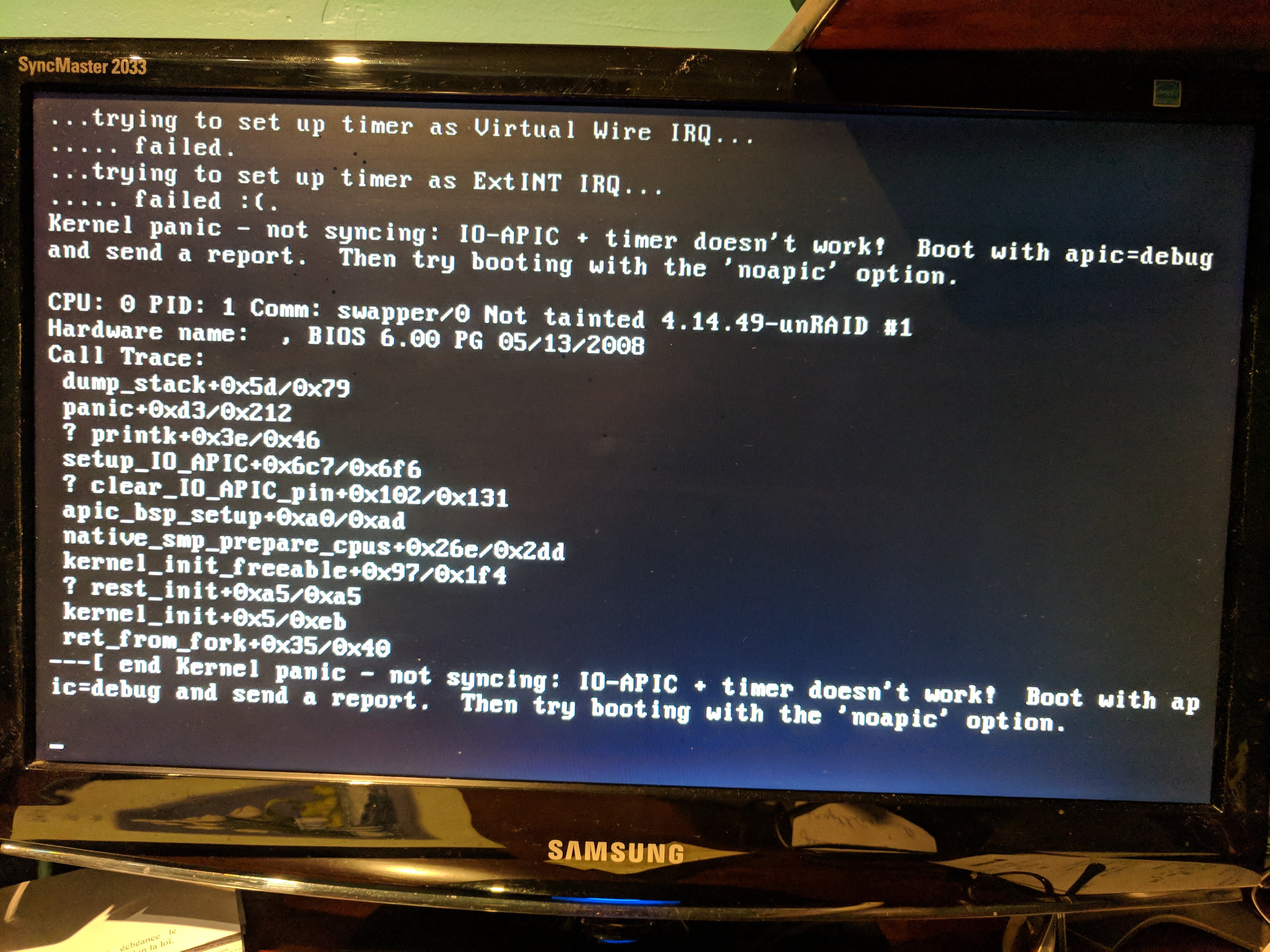

Ok, I ripped a graphics card out of another computer. I'm seeing a bunch of 'trying to set up timer... Failed" errors, then "kernel panic not syncing: IO-APIC + timer doesn't work!"

I don't think that would matter here - this seems to be a kernel printout during the early boot. So before unRAID starts to worry about plugins etc.
I guess I would try as the message on the screen suggests and add the ‘noapic’ to the kernel boot and see if that makes any difference.
i haven’t done this myself before but I think you need to add it to the ‘append’ line for the relevant entry in the syslinux/syslinux.cfg file on the flash drive.

Alright, so I added
  append initrd=/bzroot noapic
And tried booting. That managed to get me to the GUI! Excellent. I much prefer resolving the issue than reverting without resolution. Thanks for pointing me in the right direction.
