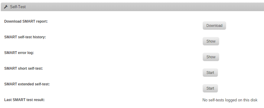

Where do I see this?  Here?
Also, the extended test is to be run here?
The SMART status is shown in the Attributes section. If you don't know how to interpret it then download the SMART report and post it or, better, post your diagnostics zip, which includes SMART reports for all disks and a wealth of other useful information about the health of your server. Tools -> Diagnostics.
Yes, click the Start button next to SMART extended self-test.

@trurl, thanks for the clarification.  I've attached my preliminary smart diagnostic report.  I've since replaced the cable, and did an extensive test, that isn't finished yet. smart-20180826-2147.zip
The results of the extended test came back.  It shows completed without errors.  Do I need to download the report?  Where can I find it?
The Download button is on the same page where you started the test.
