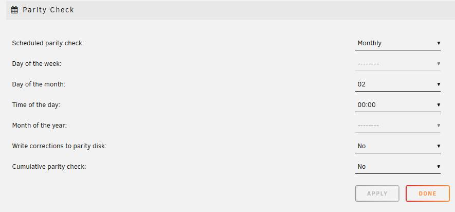

This is what my setup looks like for the monthly parity check on my Testbed server:
This provides a monthly parity check that runs on the second day of the month (that day was my choice) rather than the first Sunday.  (Yes, I realize that Sunday could be a more convenient day...)  But it does work!
One more thing, it is recommended that the periodic parity check to be a non-correcting one.  It is not expected that this check will find an error.  If it ever should find one, you want to check things out to see if there is a hardware issue that should be addressed.   It may well be that a correcting parity rebuild may be required but the delay will allow you time to make that determination.
