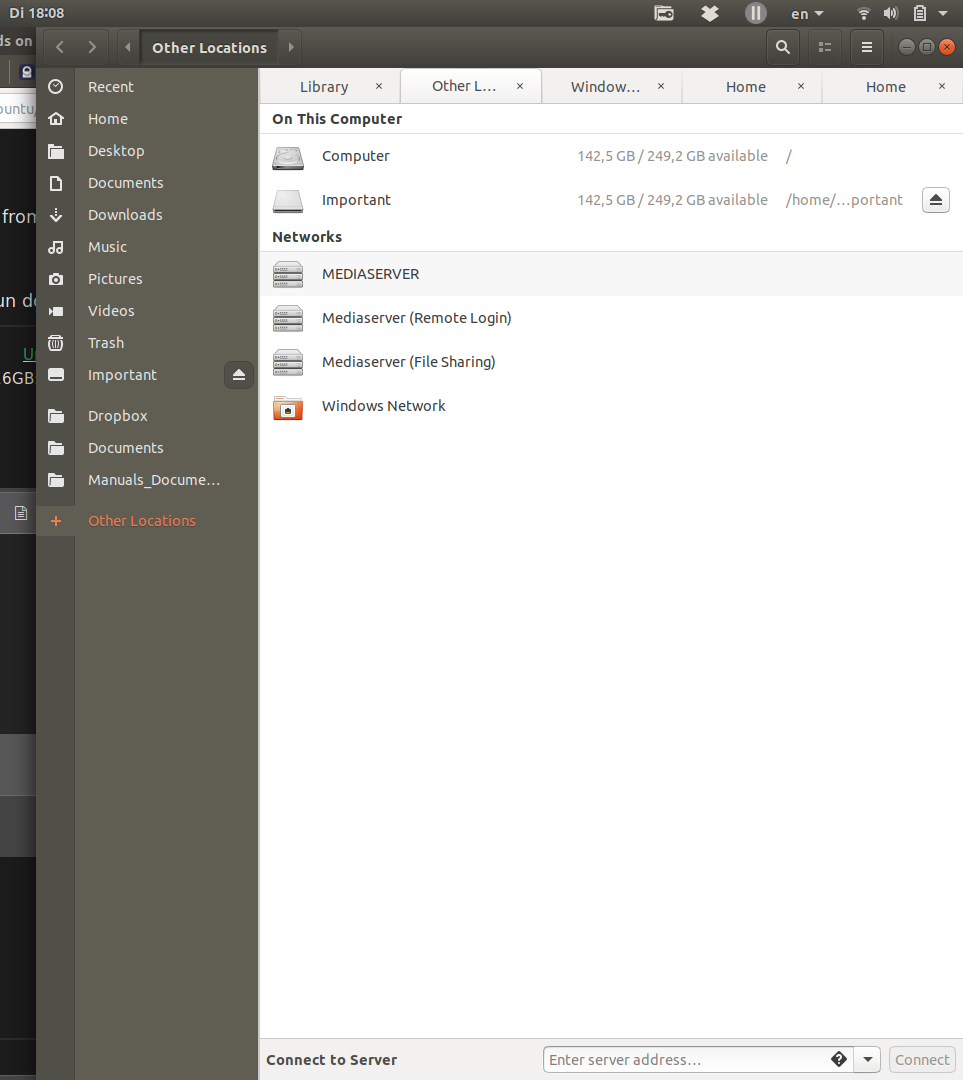

For future reference, on Ubuntu 18.04 when going to Other Locations you get presented with the options below. Sometimes I've noticed there's no distinction between Remote Login (sftp) and File Sharing (smb), but you want to use sftp which is significantly faster. I also installed Dynamix Cache Directories and span up the hard drives, but that didn't have as much of an effect.
Thank you for the help!
