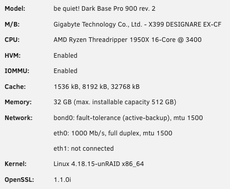

@everyone: Would it be helpful if I post my rig's specs here?
I'll update accordingly. I feel like I'm so close to getting this GPU to work.
P.S. - I made a backup of my VM image after doing a clean install and got most of the performance tweaks set. This way you shouldn't have to be re-installing Windows each and every time you need to wipe the slate clean. I just delete the VM template, but leave the image file where it is; useful when trying to test OVMF VS. SeaBIOS.

Here's my setup:
#Gigabyte #designare #x399 #Threadripper #1950x #Nvidia #GTX1060 #EVGA #Ryzen
