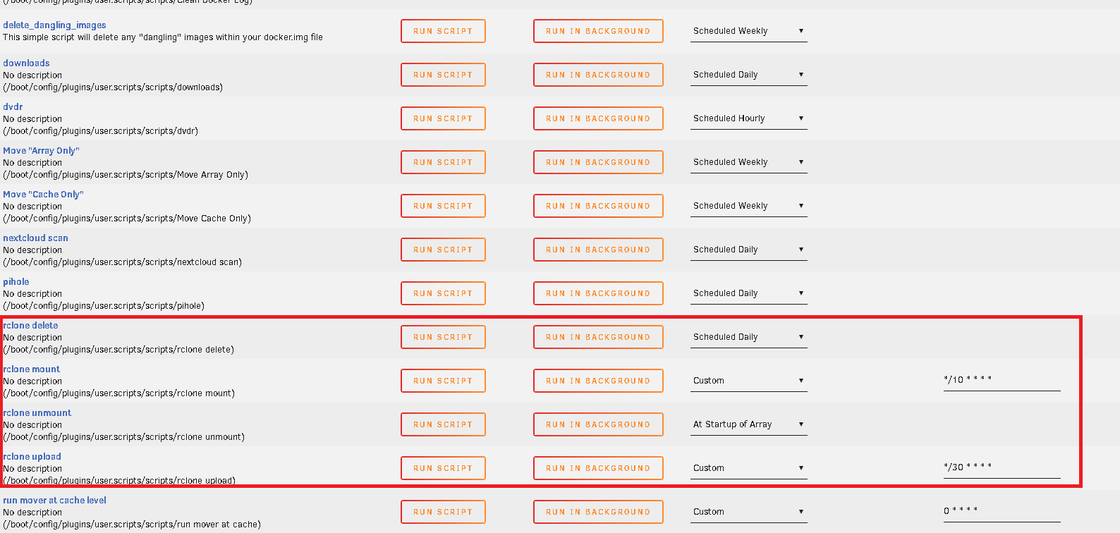

Can you please check my picture if i understand it correct?

scripts look good - have you uploaded anything yet to test?
