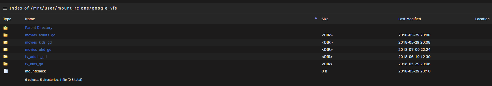

The mountcheck checks for
/mnt/user/mount_rclone/Gdrive/mountcheck
But i only have
/mnt/user/mount_rclone/google_vfs
why?
DZMM has google_vfs I use Gdrive. So in your case you can change it to google_vfs if use the file structure of DZMM.
Ah sorry, you see, im already confused. xD.
So that upload command for mountcheck on the first page is working. BUT it doesnt appear in the
/mnt/user/mount_rclone/google_vfs directory.... why?
After the mount the mountcheck file should be created if the script is working. When mount again it would say you're already mounted. These checks are more for a server that is running well. If you are still first getting the mount/upload to work you can remove the check parts from the script and just use the rclone commands.

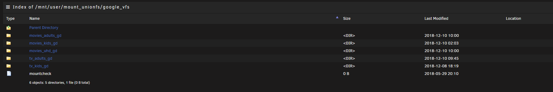

If im correct the moutncheck file doesnt get created via the mount script, it gets created the first time u install this manually....?
I can manually use the command to upload it, but it doesnt appear in that directory where the scripts are looking for it. so something on this part must be the problem.
How can i check the unionfs log or something?
Legendary would be if someone could put this together in a plugin or docker....
2.       Create Mountcheck files
This blank file is used in the following scripts to verify if the mounts have been created properly.  Run these commands:
touch mountcheck
rclone copy mountcheck gdrive_media_vfs: -vv --no-traverse
Edited by nuhll
yes, the mountcheck file is created outside of rclone by running these two commands which creates the file and then moves it to the root of the rclone mount:
touch mountcheck
once done you should have something looking like this when looking locally at mount_rclone and mount_unionfs:
1544084406_FireShotCapture5-Highlander_Browse_-https___1d087a25aac48109ee9a15217a1.thumb.png.43d1c4408d118e8f4e455ae91900fc94.png
1548065931_FireShotCapture6-Highlander_Browse_-https___1d087a25aac48109ee9a15217a1.thumb.png.7ca8a06fa7547149af40e30156e96ba1.png
and on drive the mountcheck file is encrypted so it will have a funny name.  I went back through this thread and your rclone remote names are the same as mine, so running the two commands above in terminal will definitely do the job.
Edited by DZMM
