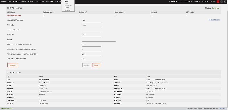

I have an unRaid server running version 6.6.4, it's been plugged into a Tripplite SMART500RT1U UPS for awhile just as a dumb unit.  Lately we've been experiencing some power issues in our area and after the fourth hard shutdown in two weeks I decided to try and use the smart features to try and setup auto shutdowns.  I was hoping it would be fairly straight forward, plug in the USB cable, change some settings etc but no such luck.
I've fiddle with some of the settings but best I can come up with is a status message that says "lost communication."  I saw mention by someone using the same UPS of running NUT, but can't find any other reference to it and don't know what it is.  I've looked at the online manual and it hasn't gotten me any closer.  Here are my current settings:
I've tried various combinations of different UPS Cable types and UPS types to no avail.  Is there a plugin I need to be running?  Any other suggestions?
