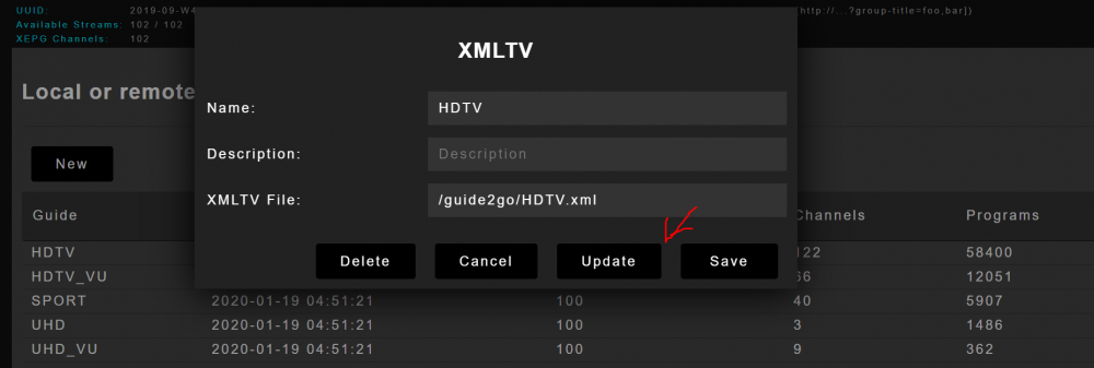

  • Quick guide on what I did.  Works and looks brilliantly.   I'm running alturismo/xteve in Host mode.   XTeVe Install XTeVe in Unraid Launch XTeVe Click on Playlist and add yo

    ok - I got it working by using and XMLTV feed as you can't channel map if using emby's EPG.   what a bloody palava - who knew simply filtering and channel mapping an m3u feed was going to be

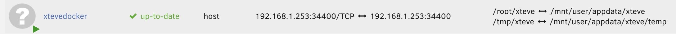

I configured it as a host, like you, and when I connect a WebUI ... HTTP ERROR 404
Any idea ?

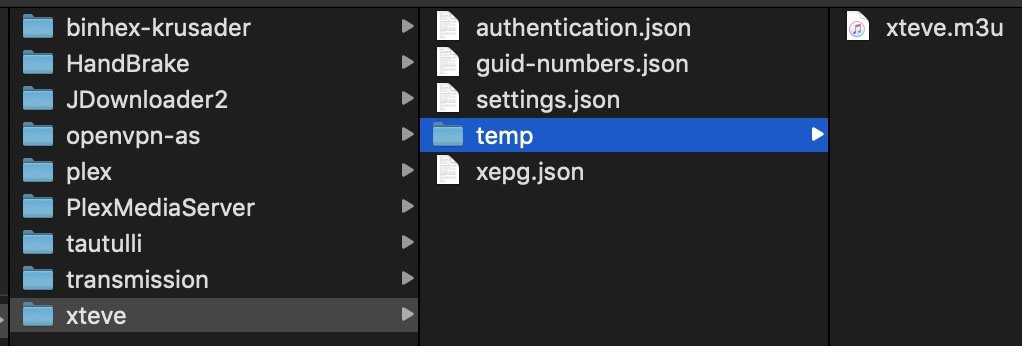

You have a directory like above setup?
If you physically go to the location do you have that folder?
Don't hide your ip address I see it on the other picture :)
Maybe try restarting the app i suppose?
Did it have the conf's done for you already?

oops use this think... Change your IP address to yours of your server!
http://192.168.5.180:34400/web/   You need the web part
