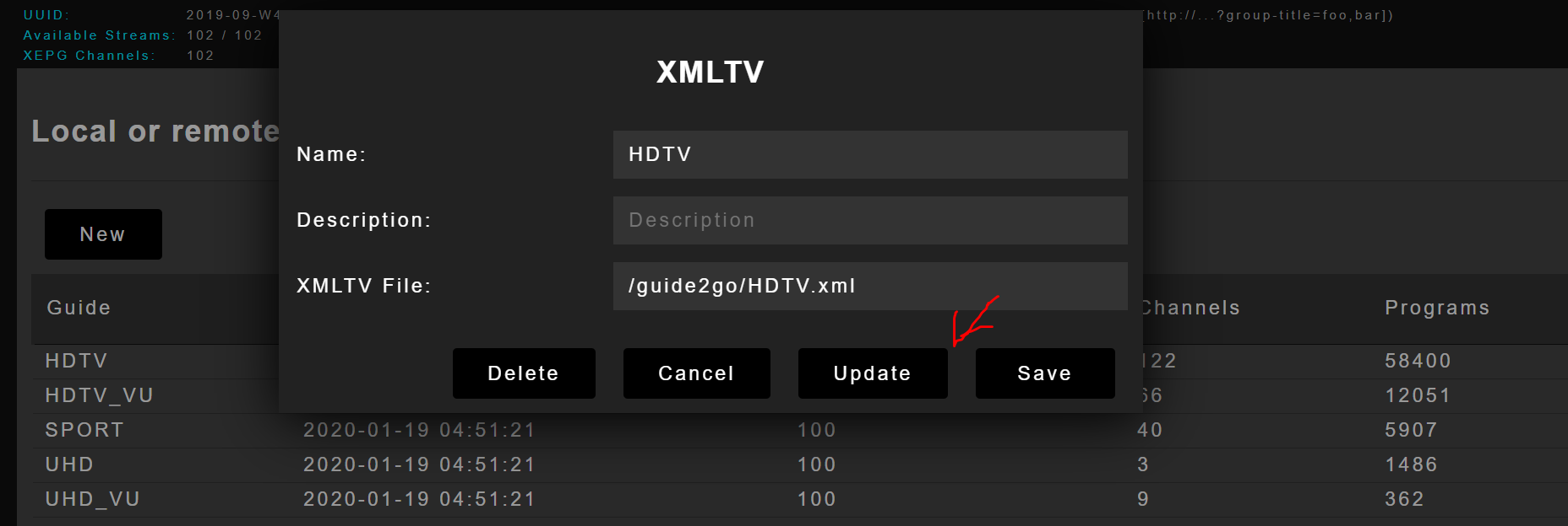

Anybody know how to force xteve to rebuild xml?
simply restart or
in settings under files u set the time schedules when xteve does it auto ...
