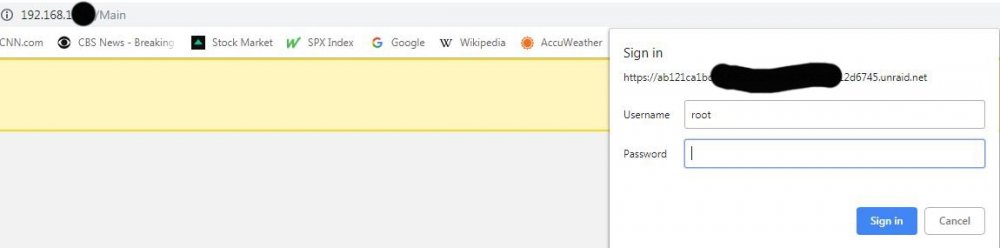

Are you seeing something like this is Chrome?
yep
Including the alphabet soup https:// address?
And after you click "Sign in", you see what on the screen and in Chrome's URL address bar?
Edited by Frank1940
no, just 192.168.x.x
Nothing, the browser keep loading in white screen.
