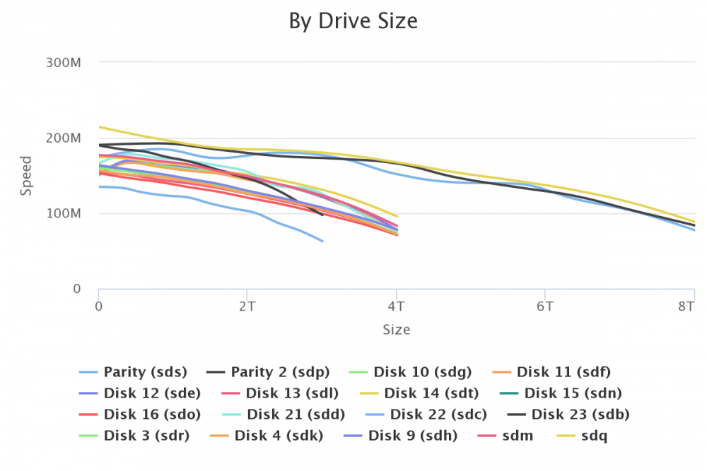

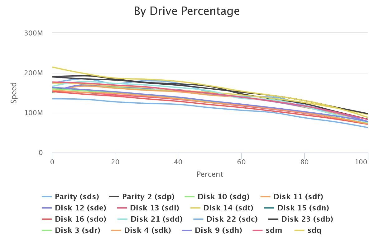

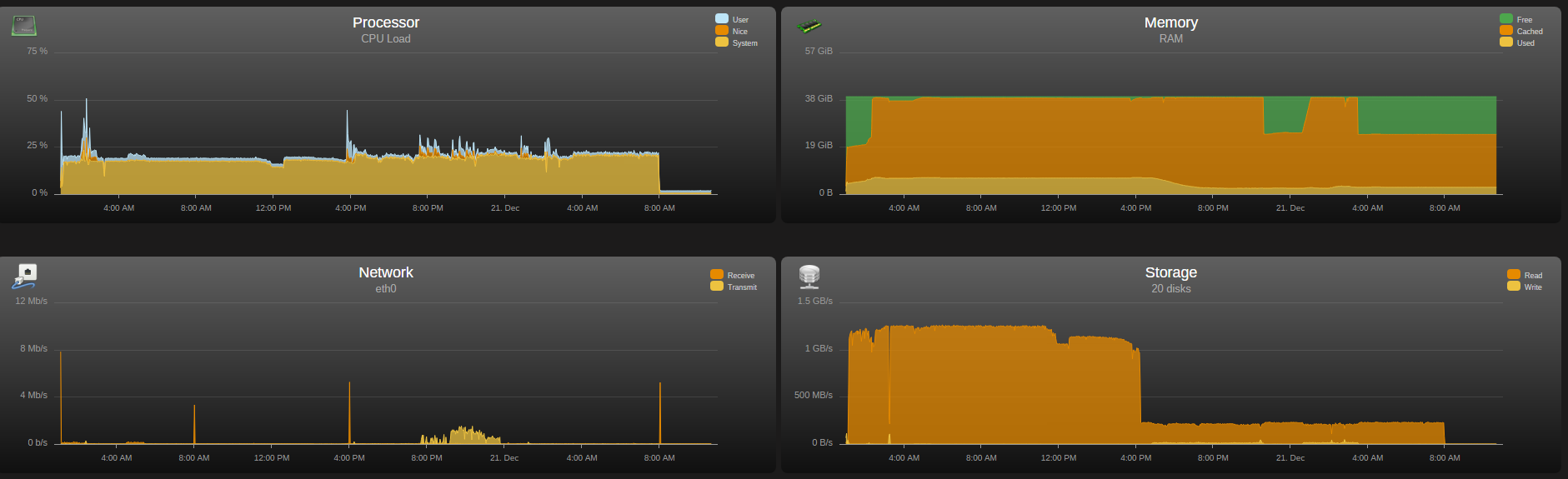

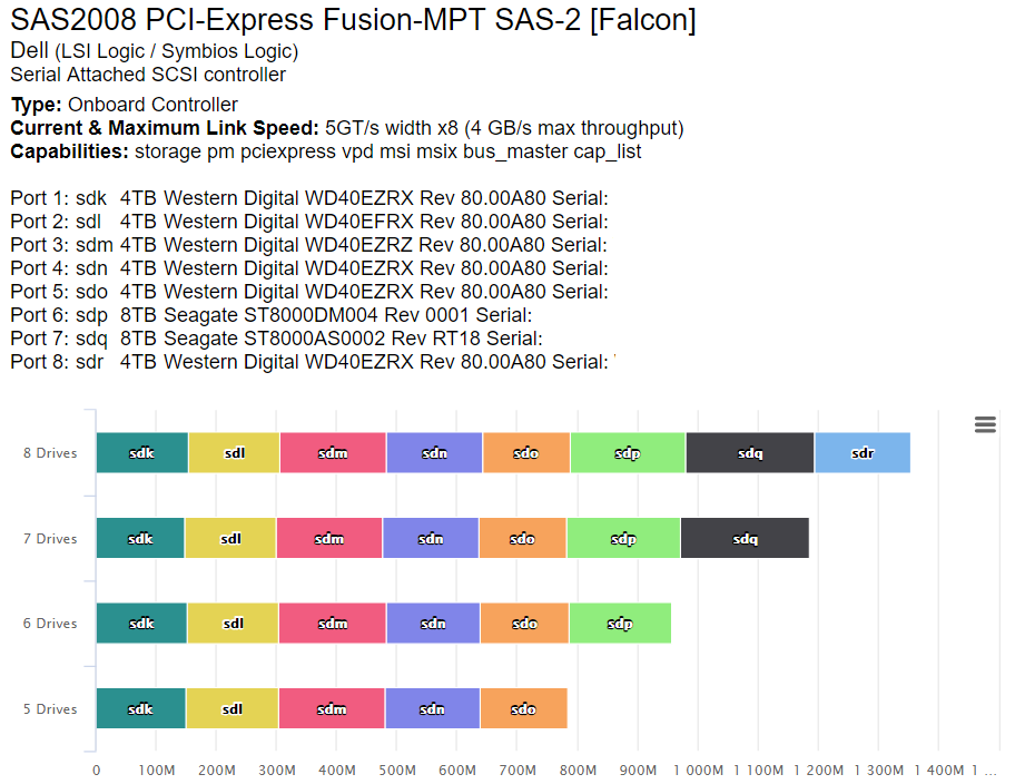

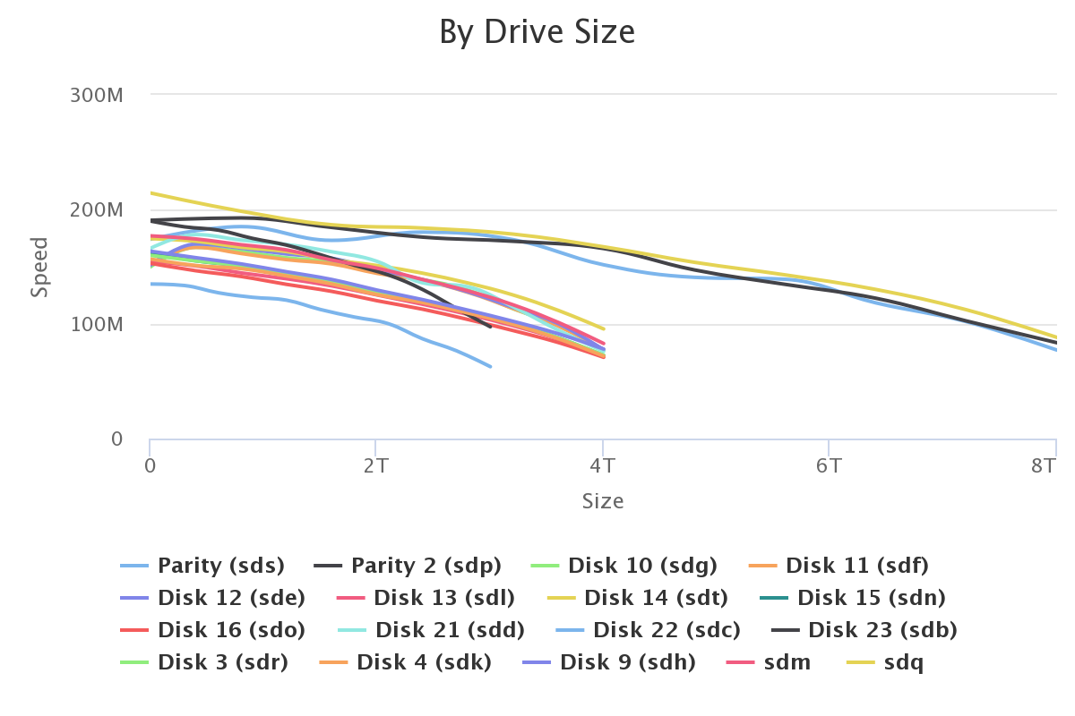

Better yet, look at the attached pictures from the DiskSpeed docker.
This is my history of parity checks. I don't have any idea why some are so fast.  For example 282 MB/s happened once and I have no idea how. There has been some hardware changes over time. Replaced a failed disk or two, changed my parity 1 and 2, added another HBA.
I was expecting to see maybe something in the diskspeed tests but unless I'm not reading them right I don't see any bottleneck.
I am aware and not surprised that my two 3TB drives are the slowest but until they die or I have a actual need to upgrade them they will stay.

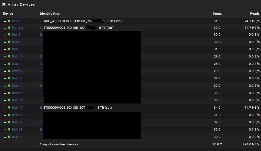

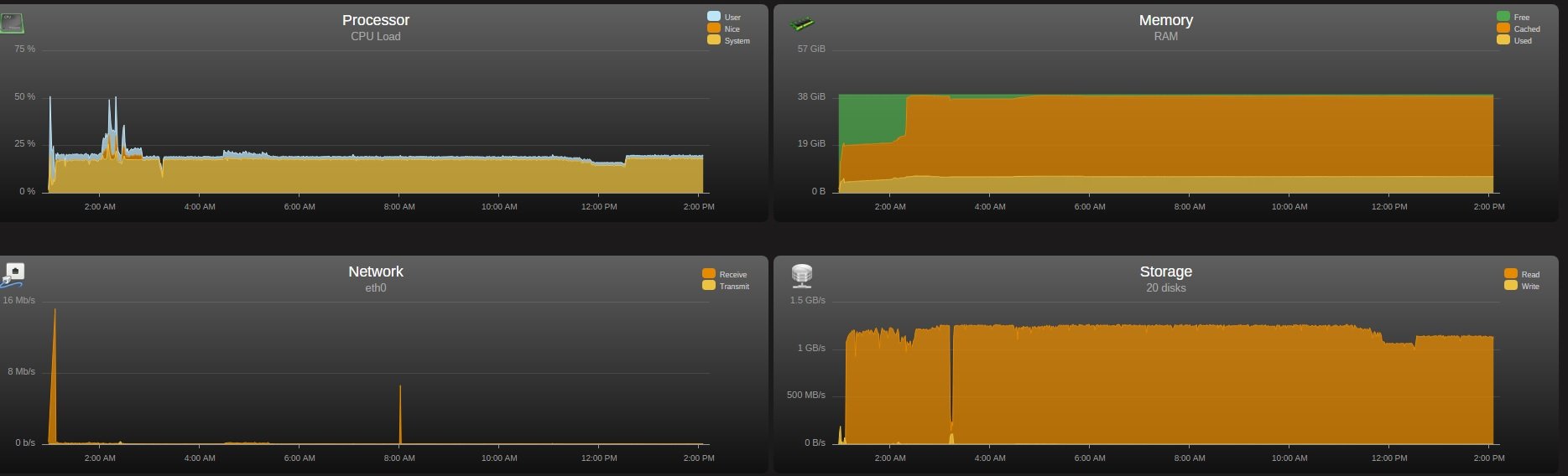

This is from the start of the parity check, while all disks were being read simultaneously.
This is after the parity check finished.
This is the speeds I'm getting on my 8TB drives, after the parity check is done with the 4TB drives.
When all drives are being read for the parity check, all my drives report a max speed of 74.7 MB/s (with very small fluctuations from that speed)
So that would make it seem like the parity drives are the bottleneck but I don't understand why drives that are clearly capable of sustaining over 100 MB/s don't ever even get to the speed.

If all going thr north bridge, then bottleneck will exist, pls further check the northbridge/PCH spec. BTW modern Intel platform PCH should have more bandwidth.
Your graph was abnormal sharp cut after 4TB, the celling was 75MBx3 ~ 225MB, pls trace those 3 disk connect to which controller.
225MB bandwidth like a PCIe gen1 in x1 lane. May be focus more on HBA3. Anyway the celling 1.27G also match 75MBx17

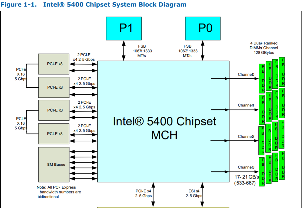

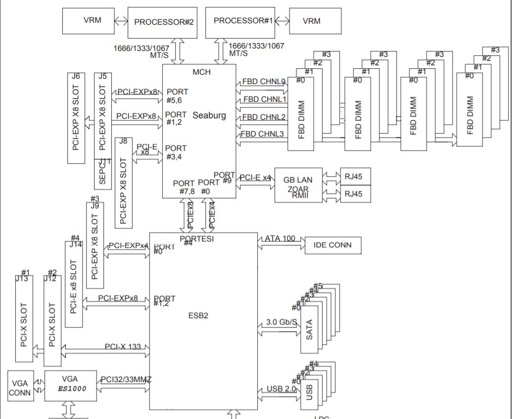

As I was just about to post the following I finally figured it out. The max bandwidth of my northbridge must be 10 Gbps.
10 Gbps = 1.25 GB/s
10 Gigabit per second = 1.25 Gigabyte per second
I can't believe I messed up the Gigabit/Gigabyte thing (I always remember it when talking about networking/internet)
So it all makes sense now, why I'm limited to 1.25 GB/s overall. I am bus/chipset limited.
1.25 GB/s /17 = 73.5 MB/s
Thanks for kicking me into figuring this out.
Except it does leave one question, why doesn't my speeds increase when the parity check is only accessing my 3 8TB drives. Shouldn't the speed of the 8TB drives go way up after its done with the 4TB drives?
I'm having a hard time finding a concrete answer to the the max bandwidth the northbridge/MCH has. This is the block diagram from intel:
Which makes is seem like the MCH should have 2.5 Gbps x 4 = 10 Gbps
Here's the supermicro block diagram. I have a HBA in J8, J5 and J9. The HBA in J9 should obviously be moved to a x8 slot, not sure why it is not but I do know at one point it was due it not fitting in a different slot due to physical interference with another card. Which also means I guess I was wrong to say all are attached to the MCH as J9 goes through the southbridge. I would have to confirm what's going on with HBA3 as I haven't been inside the server in a while.

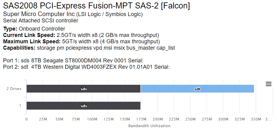

Either way, HBA3 only has 1 disk on it currently, that being the one 8TB data drive.
The 3 8TB drives are on the following HBA
Parity 1 and 2 are both on HBA2
Disk 17 is the one and only disk on HBA3

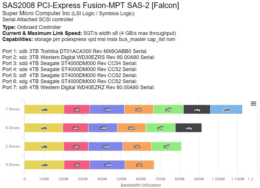

The disk speed docker is reporting
HBA1 = Current & Maximum Link Speed: 5GT/s width x8 (4 GB/s max throughput)
HBA2 = Current & Maximum Link Speed: 5GT/s width x8 (4 GB/s max throughput)
HBA3 = Current Link Speed: 2.5GT/s width x8 (2 GB/s max throughput)

So the new question is why doesn't the speed of my 3 8TB disks increase after the bus is freed up by not reading any of the 4TB drives.
It looks as if the 8 TB drives continue at the "capped" speed of 74 MB/s even after the bottleneck is removed.
It doesn't make sense. Because while all the drives are being read, HBA2 which contains both my parity (8TB) disks and 6 other drives can easily do ~ 592 MB/s (74 MB/s x 8). But then drops down to 148 MB/s (74 MB/s x 2) (on that HBA) when only 2 drives are being read from. It almost seems like a bug??

You're likely CPU limited, parity checks are single threaded and your CPU has a rather low single thread rating, dual parity with that number of disks is likely maxing it out, and that explains why speed remains low after 4TB, since those disks are still included in the calculations until the end (as zeros obviously).
Well a bug might actually explain it. Unfortunately I don't have good record keeping of when I did updates to unraid. But if you look at my parity speeds, they took a hit beginning in december. I know I installed my first 8TB drive as a parity drive on 2018-03-13. The system had been running dual 4TB parity before that time. I know I had a 4TB WD black as parity 1 and either a blue or green WD 4TB as parity 2. So the for the most part my limit was due to the blue/green WD. When I added the 8TB, it replaced the blue/green. At that time I then had 8TB seagate compute and a 4TB WB black as parity drives. Both should have been decently fast. Add to that, that there was only the parity itself that was larger than 4TB, which means when it built the last 4TB of parity it wasn't limited to any other disk speed. Which would likely explain the very fast average speed of that parity sync (282 MB/s)
When I upgraded my second parity drive to 8TB I think it was then when I noticed my speeds were lower. I had tried a few different things at the time, though never let the parity sync complete as I was fixated on getting about the 74 MB/s which I now know would never happen.
@johnnie.black would that explain what I saw then with running a single 8TB drive? Since the parity calculations were only having to be done on 1 of the 2 parity disks, after 4TB? What I'm trying to say is if I am CPU limited then I would be less limited with only one drive having parity calculated over 4TB. As soon as I added the the second 8TB it split my limit between the two drives and therefore lowered my speed after 4TB.
I didn't realize parity checks were single threaded, I had sworn I thought I saw all my cores active and not just a single one maxed out but I must have been mistaken. (I had nothing else running at the time)
Awesome !!
Edit : But 17 disk nor 3 disk will limit to same 75MB each ?? This seems no sense.
That let me remember my Celeron J1800 ( retire ) got same problem if running 2 parity, both (J1800 or G3250) should be ~12 or 13 disks, but G3250 haven't got slow down.

35 minutes ago, Benson said:
Awesome !!
I had 2 problems. Chipset/northbridge/bus limit. The max my board will do is 10 Gbps = 1.25 GB/s /17 disks = 73.5 MB/s per disk
CPU limit. Since parity calculations are single threaded, calculating parity for both my parity disks maxed out the CPU and therefore it can't write any faster then 75MB/s, its waiting for the CPU. At least that's how I understood it.
It is odd that the bus limit and the CPU limit end up being the same number of 75 MB/s though.
New hardware will defiantly remove my bus/MCH/PCH/northbridge (whatever it's called) limit as the new board has a ton of bandwidth. Not sure the minimum requirements to insure the CPU isn't limiting the speeds though.
