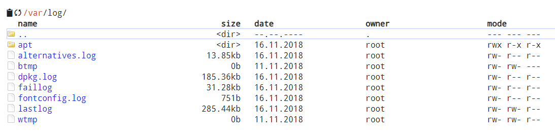

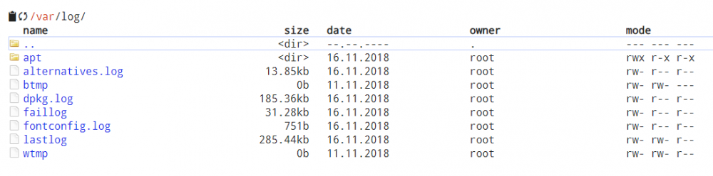

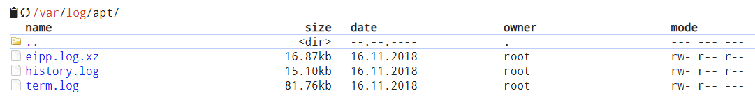

and have rebooted the system.  The contents of the folder, though, 1) haven't updated in quite some time, 2) there's not much in there:

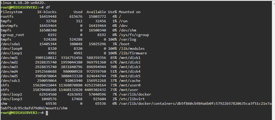

What is the output of
df
Filesystem         1K-blocks        Used   Available Use% Mounted on
rootfs              65832552      833328    64999224   2% /
tmpfs                  32768         368       32400   2% /run
devtmpfs            65906112           0    65906112   0% /dev
tmpfs               65986988           0    65986988   0% /dev/shm
cgroup_root             8192           0        8192   0% /sys/fs/cgroup
tmpfs                 262144        1564      260580   1% /var/log
/dev/sda1           15170560     2221744    12948816  15% /boot
Yeah - I had copy/pasted the comment from an older thread previously about increasing the size.
here's the df output:
Well, Fix Common Problems isn't lying. Your /var/log is 100% used.
