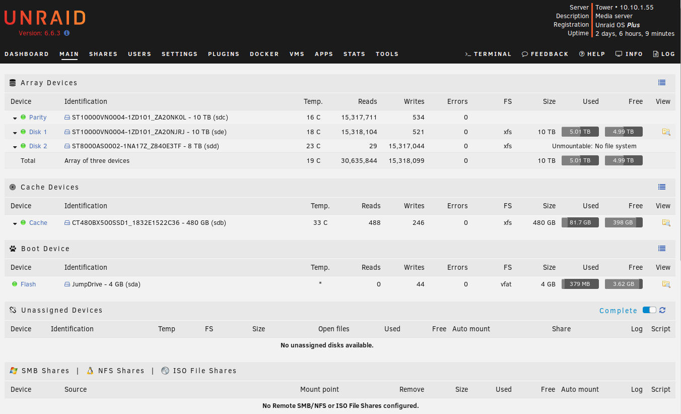

Ok this does not look fun.   Parity sync is complete.  0 errors.   8tb disk now has an unmountable file system.
Here we go:
Event: Unraid Disk 2 message
Subject: Notice [TOWER] - Disk 2 returned to normal operation
Description: ST8000AS0002-1NA17Z_Z840E3TF (sdd)
Event: Unraid Parity sync / Data rebuild
Subject: Notice [TOWER] - Parity sync / Data rebuild finished (0 errors)
Description: Duration: 14 hours, 40 minutes, 10 seconds. Average speed: 189.4 MB/s
unRaid  2019-01-22 17:35:50.png
