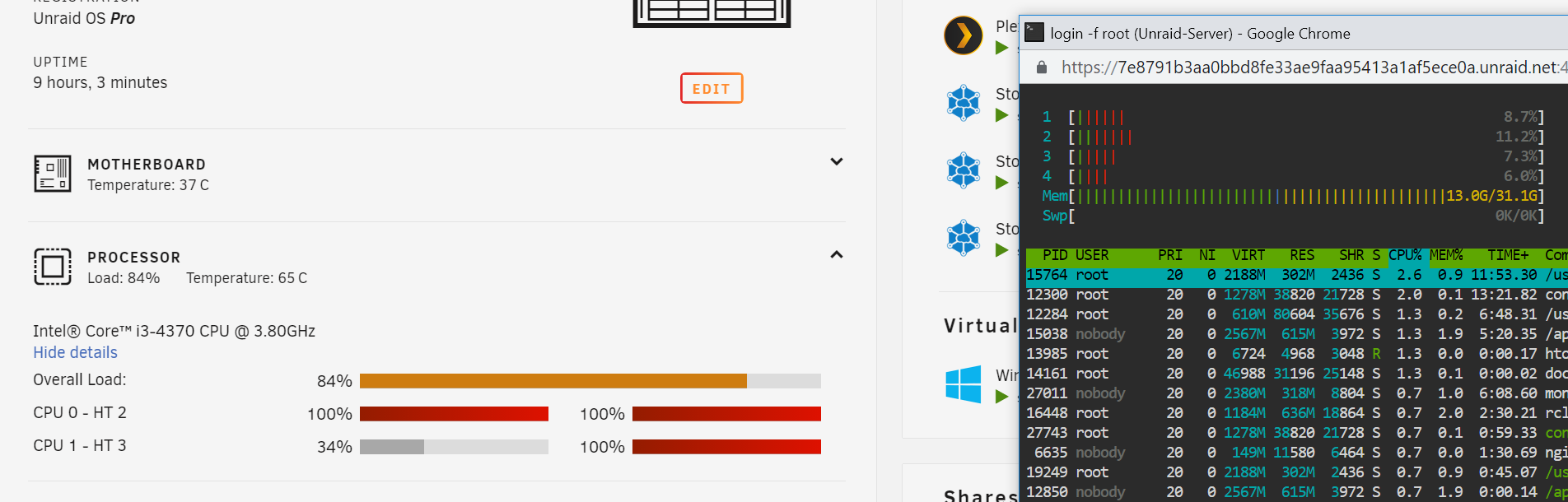

What i also wonder is, unraid shows CPU 100% nearly all time. But if i ssh into it and run htop, cpu is chilling mostly below 30% oO?
Edited by nuhll
