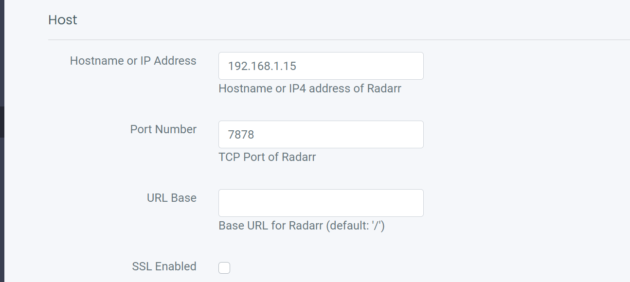

so looking at your screenshot of radarr, is 192.168.0.33 the ip address of your unraid server?.
Hi yes it is,

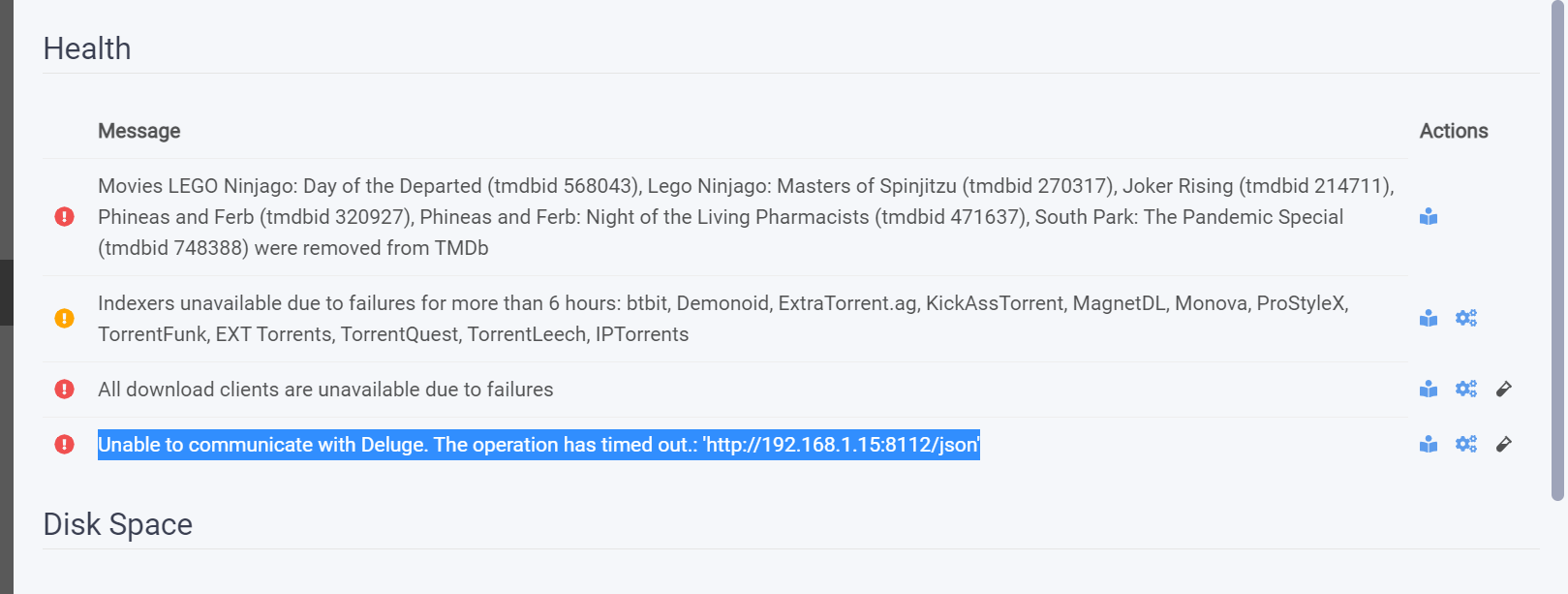

Hey all and @binhex
I started to notice that my sonarr and radarr are starting to show that they can't connect to the client.
Unable to communicate with Deluge. The operation has timed out.: 'http://192.168.1.15:8112/json'
I'm using binhex-delugevpn that  is super great and hoping there is a easy fix.
see recommended post at the top.

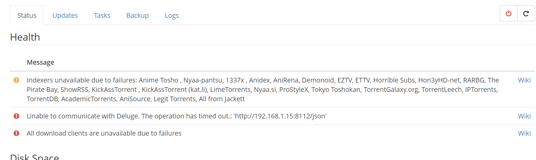

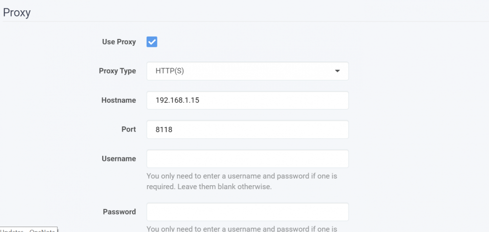

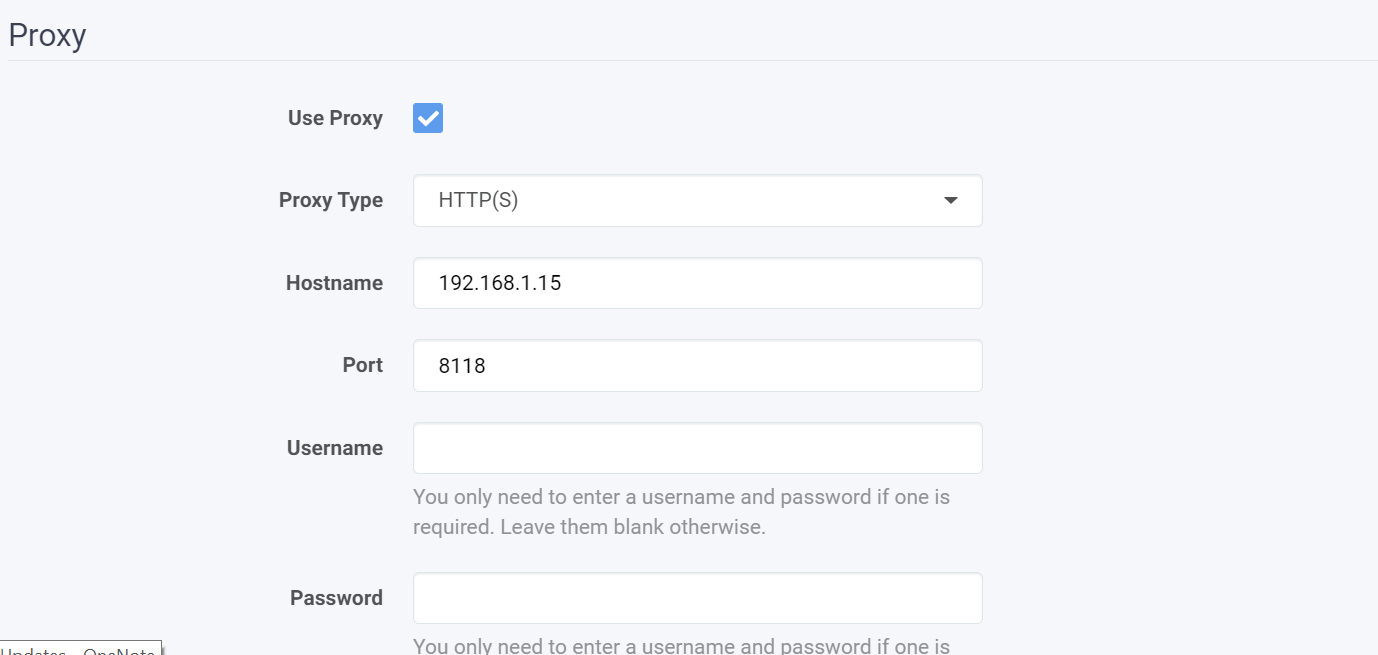

so how have you setup sonarr and radarr?, are you routing sonarr and radarr through privoxyvpn or are you using privoxy (proxy) for sonarr and radarr?, also what container are you using for deluge?, deluge or delugevpn?.

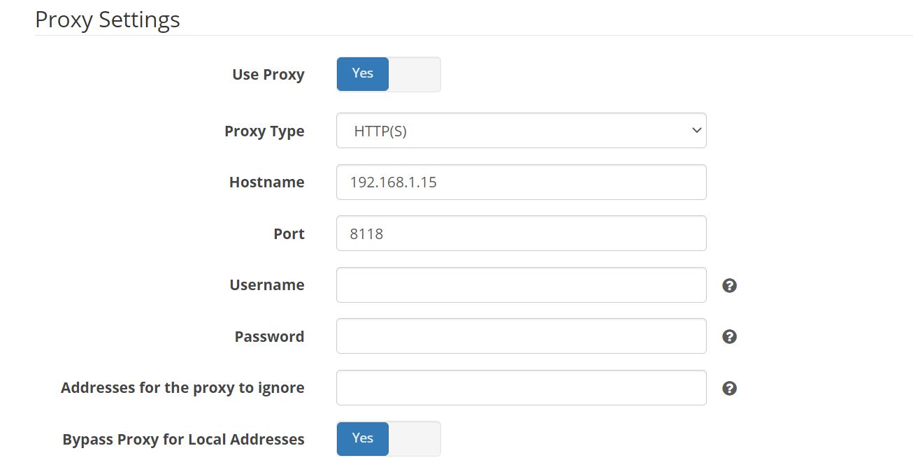

I have sonarr and radarr routing traffic through my delugeVPNimage.thumb.png.4ed5ec109a1d2cc95757cdeb91e7acb4.png
Edited by mrtech213

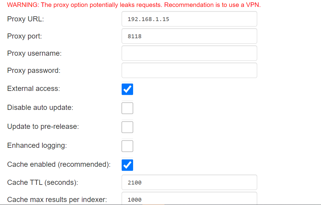

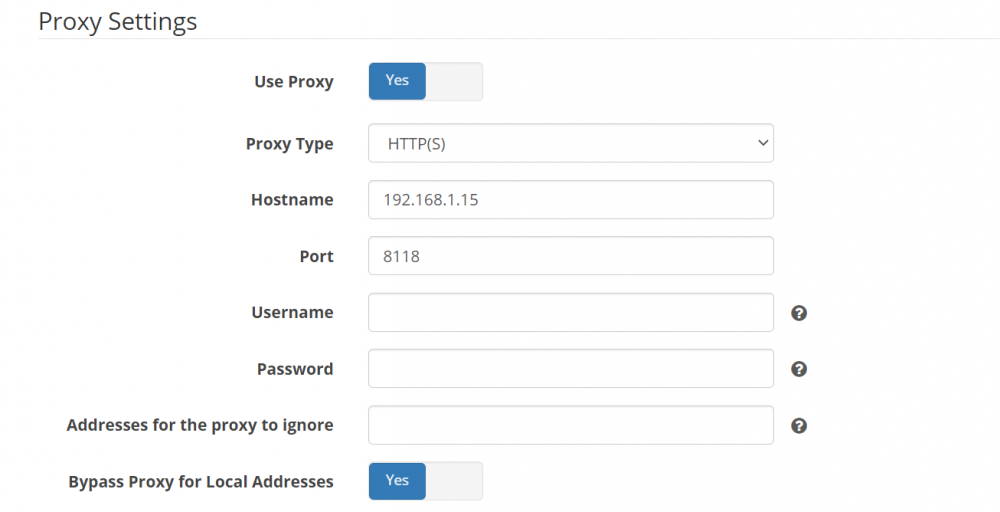

ok so you are using privoxy, from Q26.:-
A26. Due to iptables tightening you need to now bypass local addresses for proxy connection in index applications, for Sonarr/Radarr/Lidarr this can be achieved by editing the value for 'Ignored Addresses' under the Settings/General/Proxy and entering in the IP address of the unRAID server running the VPN container. This will then bypass using Privoxy (proxy server) for connections to the local server, and thus allow a direct connection to the download client.
THANK YOU SO MUCH!!!!!!   its working :)    I love your applications!     quick question:
what about my settings for Jackett and Bazarr?   These two applications are also routing through the delugeVPN
jackett doesnt talk to deluge so no worries there, Bazarr i know nothing about, does it talk to deluge?, if so check the proxy settings for the app.
ok cool   I'll check the settings out for Bazarr but yea all is working now    truly thank you so much for the creation of these apps and the support   :)
But another quick question, since I set the Addresses for the proxy to ignore to the address of my server (which is the same address I set within the proxy setting for the hostname and port). Is the traffic from sonarr and radarr still going through my delugeVPN???
Edited by mrtech213
yes, its only bypassing traffic for local network, if sonarr makes a request to https://myfavindexsite.com then it wont match the bypass and thus will use the defined proxy.
