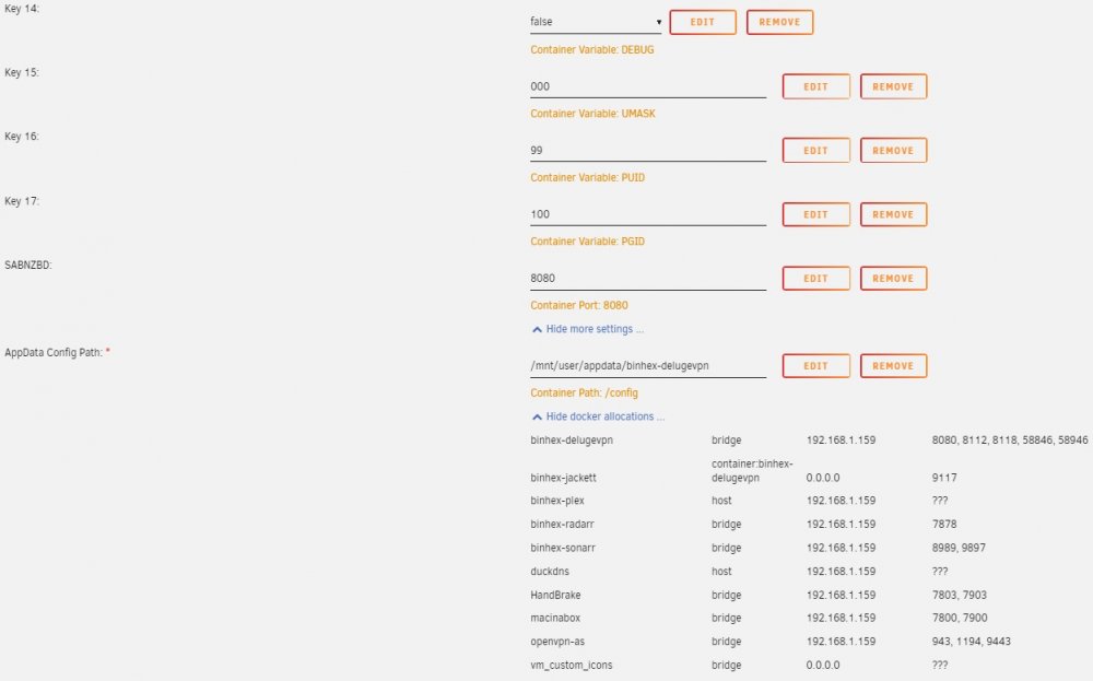

I've gone through all the setting, but for the life of me I cannot find where to do this from Q/A 25.  Everything appears to be wanting to route through the VPN, but there's no WebUI on my dockers now.
The other change you will need to do is when defining connections from an application to another application in the same container network (as is the case in this scenario) then you will need to set the host to 'localhost' and NOT the LAN IP address, this is because the applications are now bound to the same network and thus should communicate over 'localhost'.

saw the screenshots above, ok so you are routing jackett (and others, but lets concentrate on jackett) through delugevpn, i see from the screenshot you have added in port 9117 (jacketts default port) to ADDITIONAL_PORTS, a good start!, HOWEVER you are missing the port itself, you need to add the port to the delugepvn container too, without that there is no connection from host to jackett.
so add a new port to delugevpn, host port. = <whatever you want as long as its not in use> e.g. 9117, and then container port of 9117 (do not change this).
1 hour ago, binhex said:
are you routing your containers through a vpn enabled container OR are you using privoxy and setting the proxy settings for your applications?.

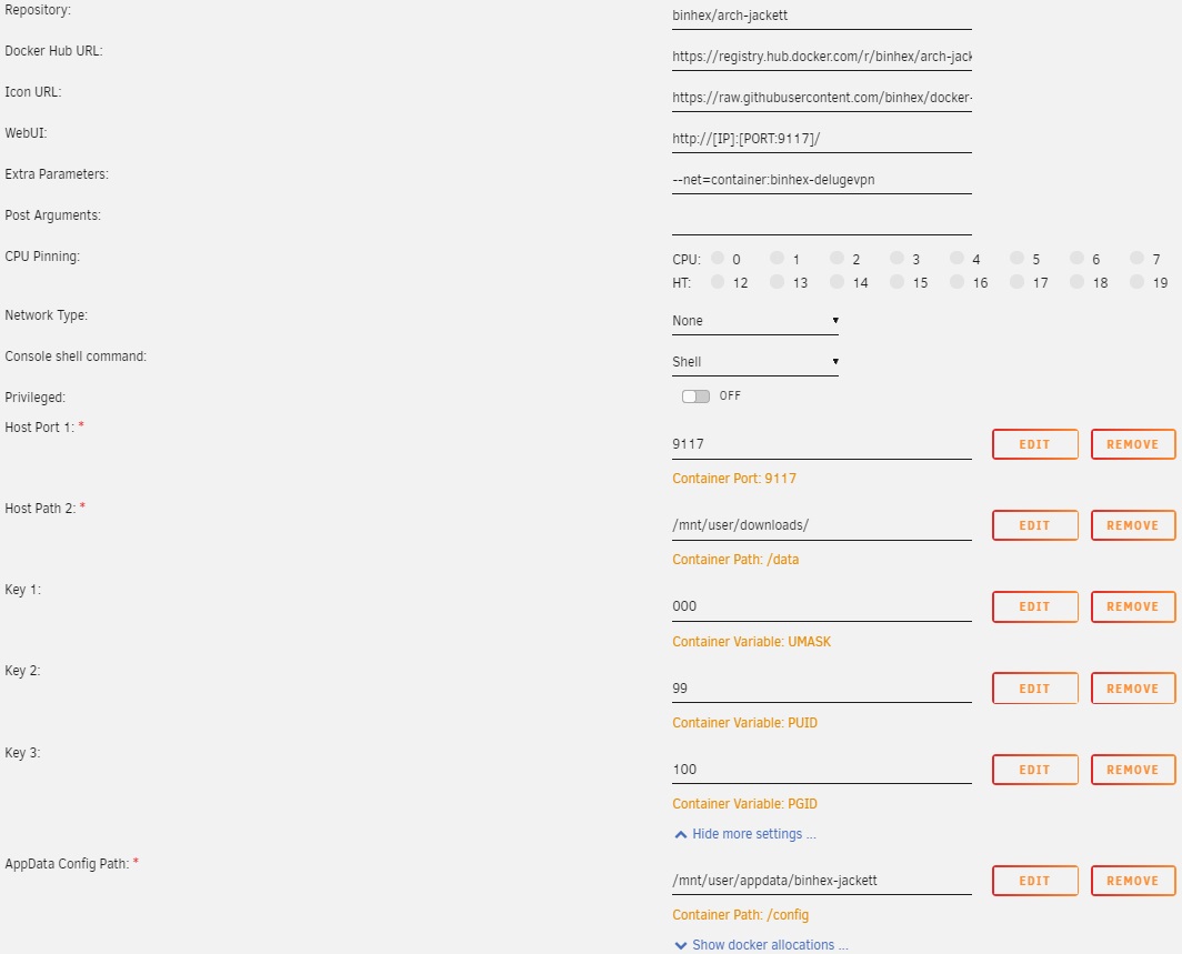

I went and removed the 9117 in Jackett.  I leave the WebUI line alone or pull that out because the instructions in A24 say to remove all the ports.
I was thinking those were 3  separate entries. They're to be two entries?  One for all the container ports (additional_ports, multiple) and  a single entry per container, like the one below.  This will route the traffic within the Deluge VPN and over to Jackett?
correct, with ADDITIONAL_PORTS being an env var - just stressing this port.

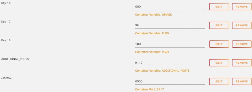

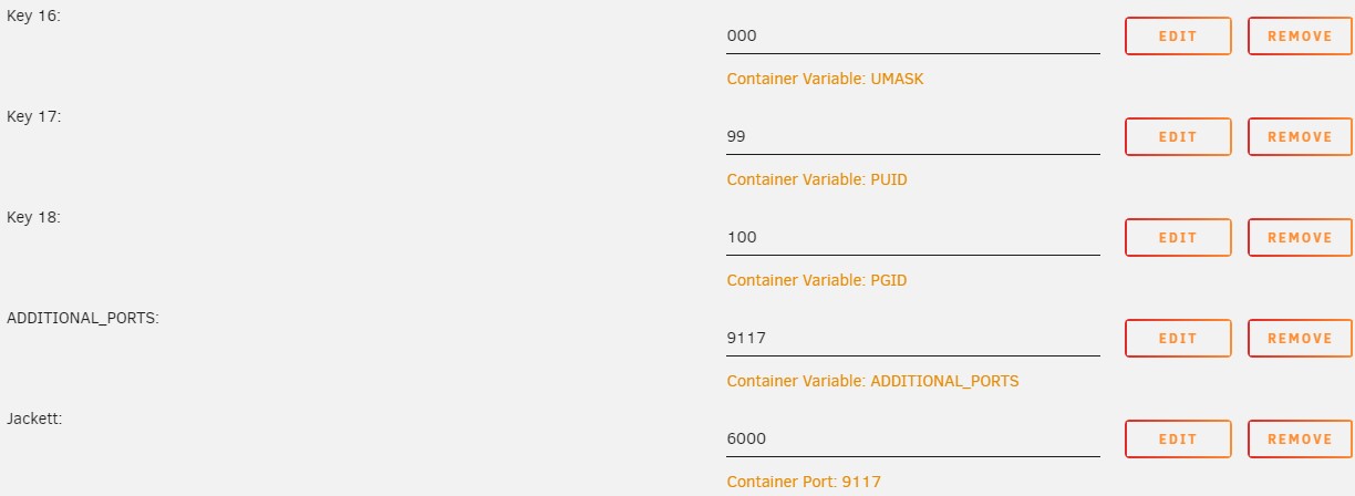

I see you stressing the ENV VAR pretty hard.  In my earlier Deluge build I had the Additional Ports already supplied, apparently in the one from last night its no longer there.  I need to add this as a VARIABLE and not a PORT with the below settings.
I have Jackett PORT entry as Contrainer Port: 9117, HOST PORT 6000
Additional Entry as below.
Save/apply all settings
Start DelugeVPN, validate its getting different IP
Start Jackett, validate its getting the same IP as Deluge
No WebUI option

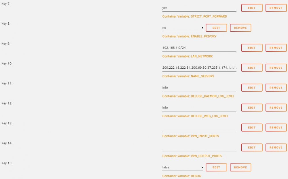

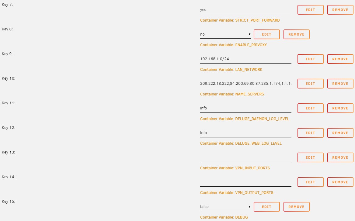

Configured the the ENV VAR as a VARIABLE as shown above, the Jackett entry as well, browse to http://192.168.1.159:6000 and nothing.  Shutdown the array and rebooted the entire system (someone said that worked for them), same thing.

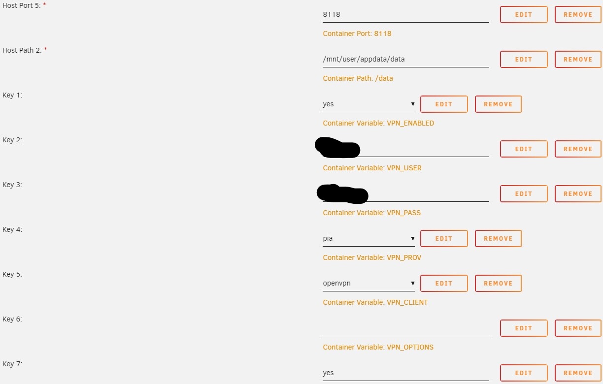

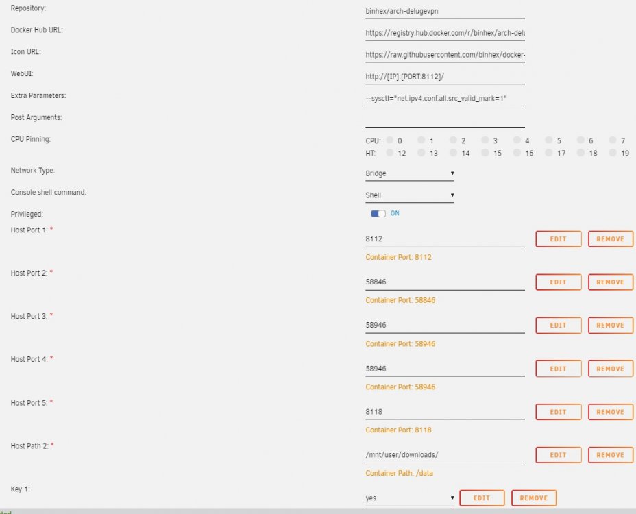

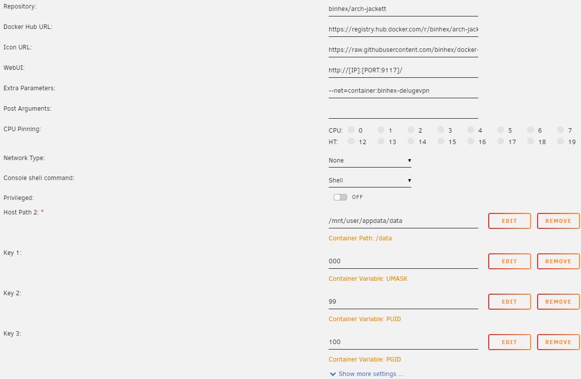

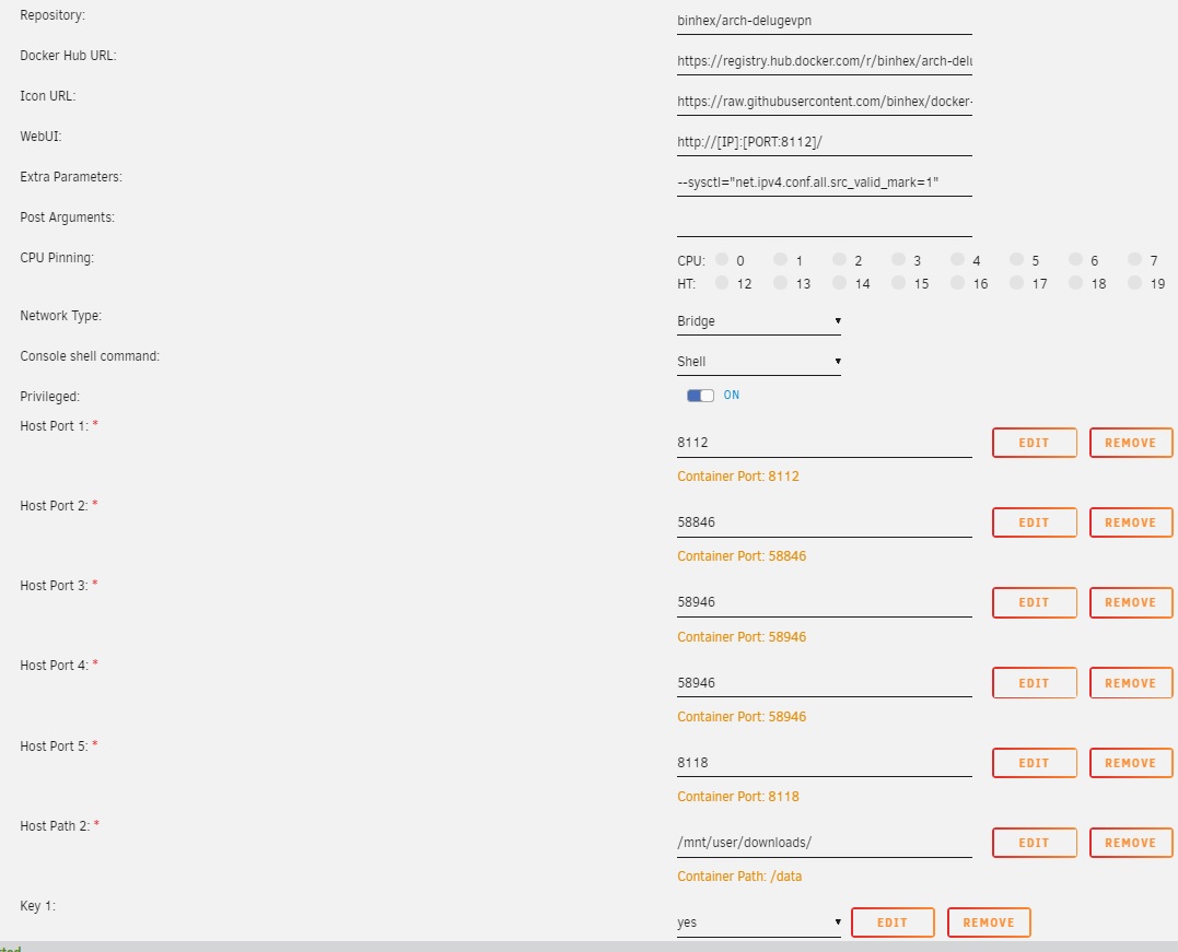

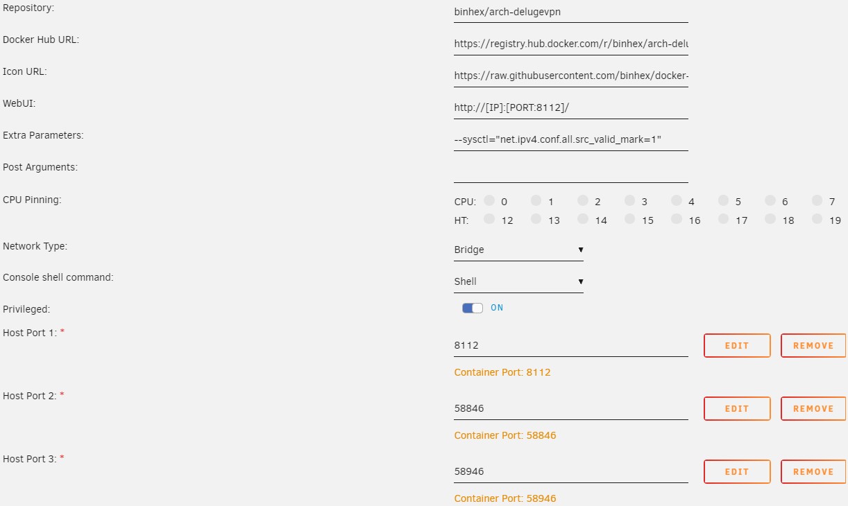

Ok fresh screenshot of edit screen for jackett and delugevpn
Sent from my iPlay_40 using Tapatalk
Please and Thanks BinHex

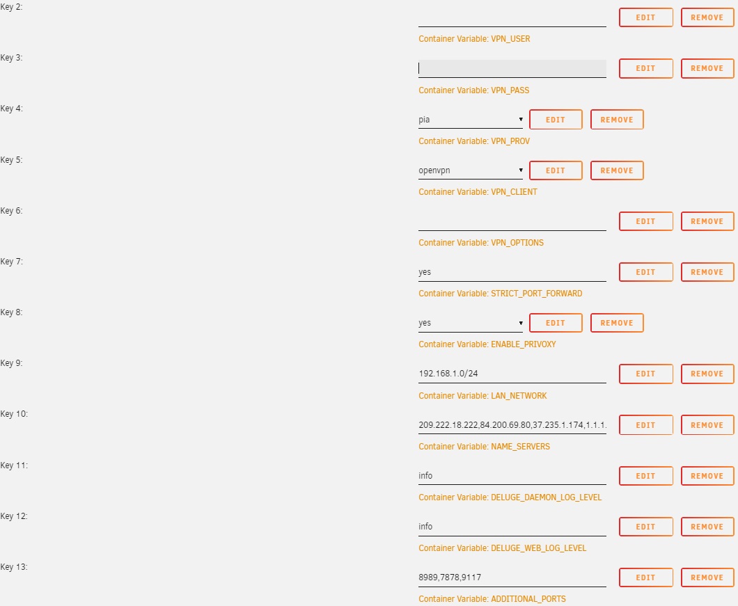

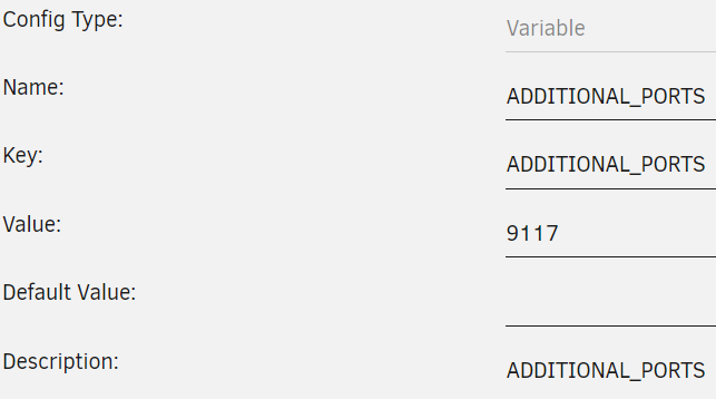

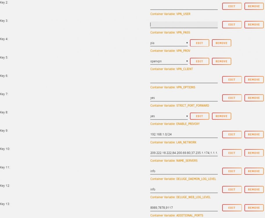

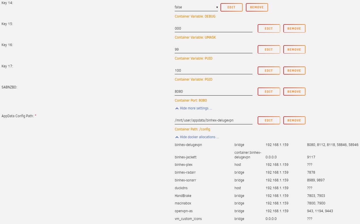

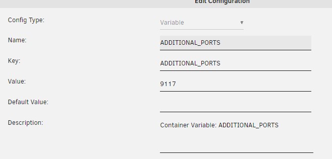

ok can you screenshot ADDITIONAL_PORTS env var, i want to ensure the key is set not just the name, also can you set VPN_INPUT_PORTS also to 9117 PLEASE :-).
17 minutes ago, binhex said:
im running out of those, been doing support fallout for days!.
Done, Should I do something for VPN OUTPUT ports?
D6.jpg.9560a8d198ec63cada1a0d4c3b6921df.jpgD5.jpg.f069aaac3fb5a604e96204b3a535fcae.jpg
not required for jackett, this is used when you want to talk from a container running inside the vpn network to another container running on the lan, this is not the case for jackett.
can you please attach /config/Jackett/ServerConfig.json i want to ensure its not set to use a proxy or external access hasnt been accidently disabled.
also please restart jackett, just in case its not bound correctly to the vpn network, then try web ui
