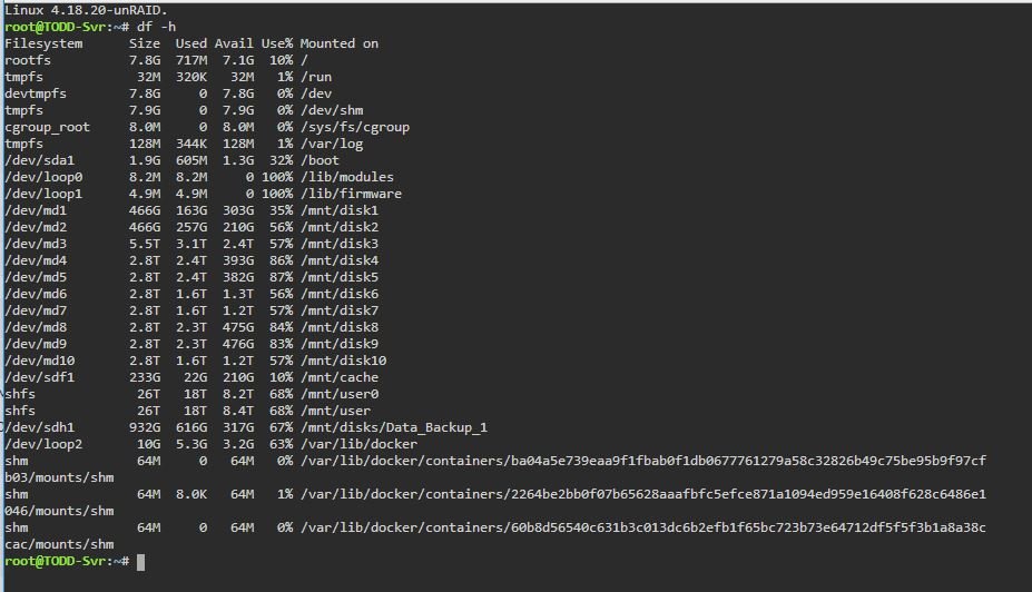

I was wondering if you aren't somehow filling up the OS filesystems, which are in RAM, and that is where things are getting broken. I don't see it in those diagnostics though, and maybe would only see it if you could capture them when things are broken.
The thing I am looking at in diagnostics you can get from the command line with this:
df -h
df -h

That df command I gave will get you flash and every other filesystem as well. Try it.
cool!  OK next fail we will have this, assuming terminal works!
Actually, I don't see flash.  Am I missing something?  It's a 2 GB flash drive.
Also, I do see the /var locations referenced where files were not able to be written and they are very small folders.   I do not see /etc which was one of the two.
Flash is sda, it's mounted under /boot
should have seen that, knew it was sda..... Thanks!
/var/log is where syslog is. It will sometimes fill if you are logging a lot of errors.
/etc and lots of other linux OS folders are in rootfs, /
All of the things above /dev/sda1 in your screenshot is in RAM.

this afternoon I'm starting a pre-clear that will not be encumbered by the DVR running in the middle of the night.  This will rule out (or in) the DVR service having anything to do with this.
If everything goes crazy again, I'll have more sys log info and the drive status again shown above after the error but before a reboot (hopefully).
I'll try a smart test with pre-clear removed as the next step.
