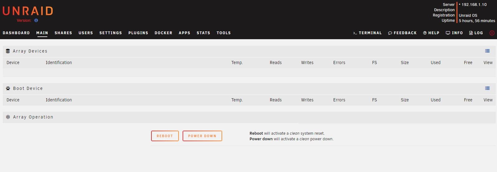

OK Chaos Resumes this morning so here is what we learned:
Scratch DVR off the list, nothing was recording.
2 pre-clears running last night triggered the same set of trouble this morning.
Its Definitely me making the GUI request that is triggering the errors and screwing up how everything is being reported.  They syslog shows the errors starting at that time index after 9AM.

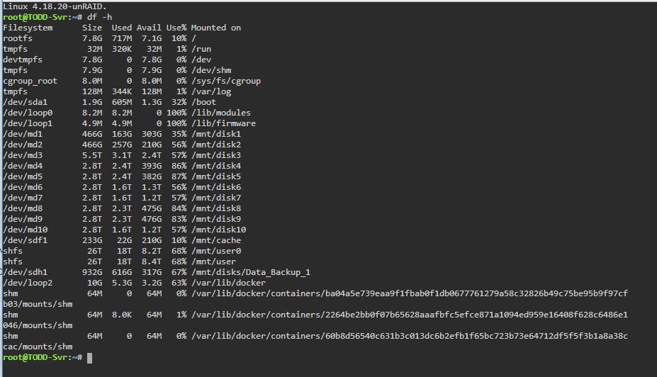

I ran the df -h and nothing looks any different than it did yesterday  Both reports are attached

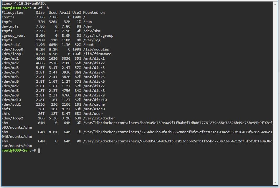

After reading this, I think your problems are hardware related. The rc.diskinfo invocation means a disk got added, changed or removed. After the diskinfo service update the unassigned disk information, it writes a file located at the RAM rootfs. This means you got faulty or full memory.
Did you see the screenshot attached to this post?
https://forums.unraid.net/topic/78318-drives-dropping-out-of-array-into-ud-split-from-preclear-results/?do=findComment&comment=726573
I missed it before but it does show rootfs going from 10% full to 100% full.  The question is what about running a pre-clear or an extended Smart scan is causing that file to fill up?
One thing I can try is to run a smartscan and try to see how fast it actually is filling up.  All I can tell right now I am initiating one of those processes before going to sleep and sometime before 4:40 in the morning (which is when unRAID is trying to write to that file) the file is getting full and the errors commence.
