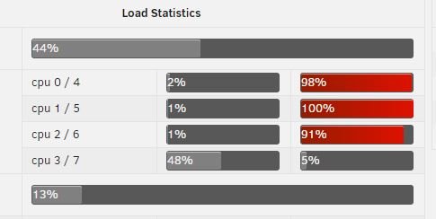

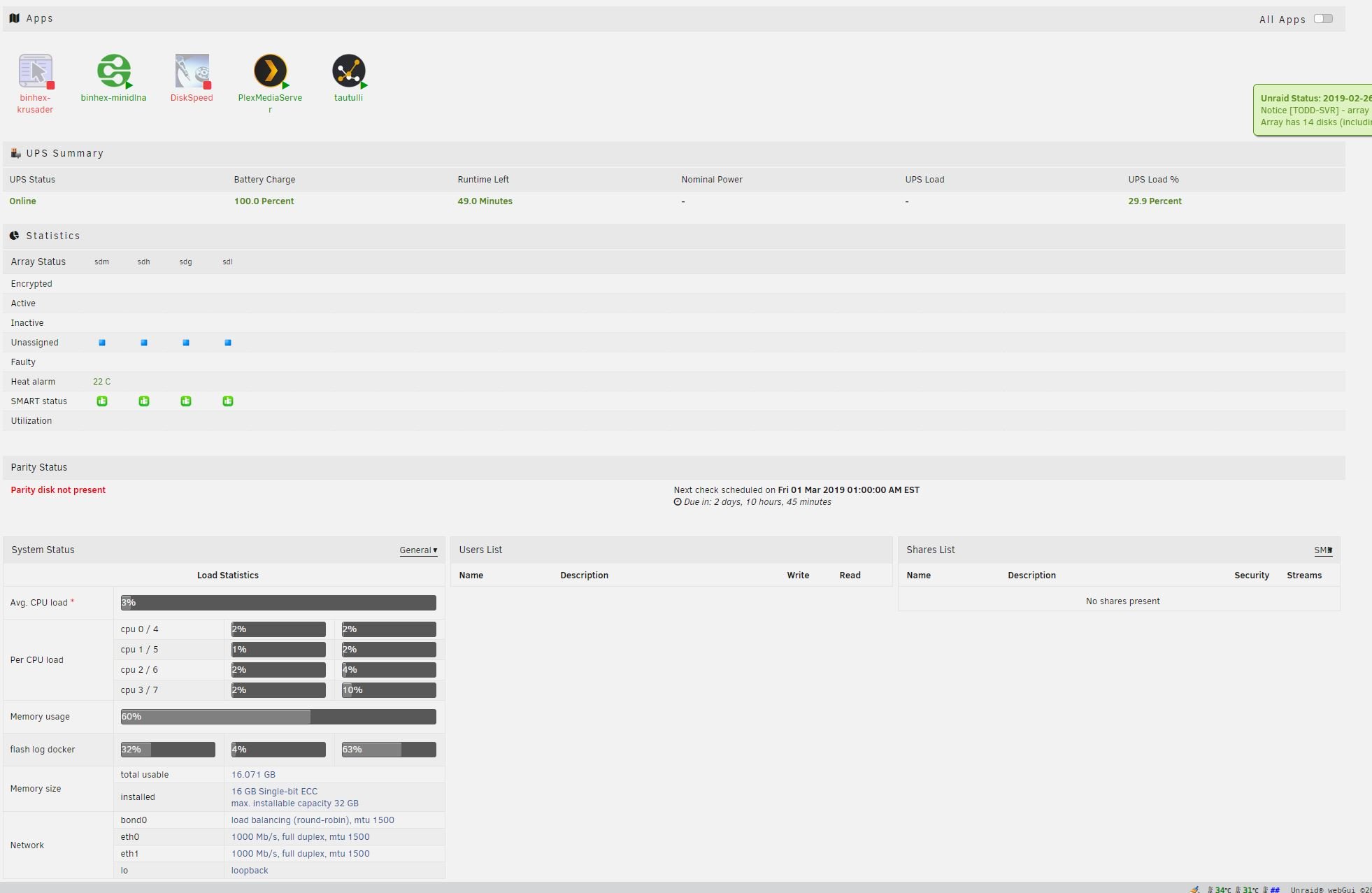

I have noticed since some recent unRAID upgrade the CPU seems to stay busier even at rest.  IE bouncing up to 20-30%.   2 cores peg at 100% and that activity bounces from core to core.  Now with 2 pre-clear's running the CPU usage is bouncing 30 - 50% and even 3 cores are pegging out at a time.  I shut down all my dockers and nothing changed.
It seems like something is going on in the background.  I really am not sure if it was like this before the this preclear issue started or not.  Is there some way to look at processes by CPU usage like task manager on Windows?
I will add to this, the activity level stays up even with all the drives spun down.

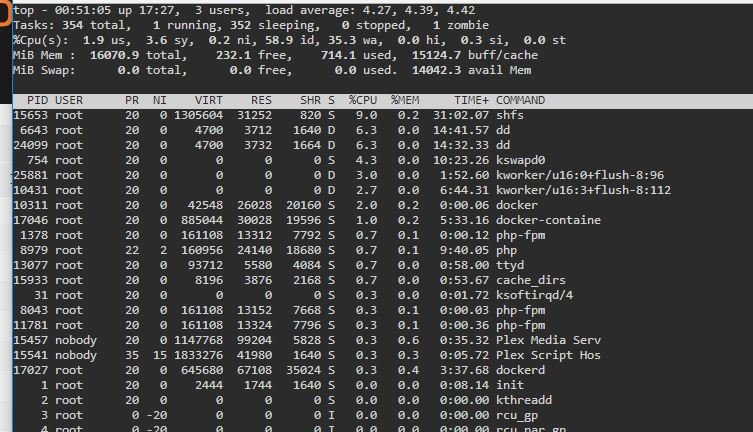

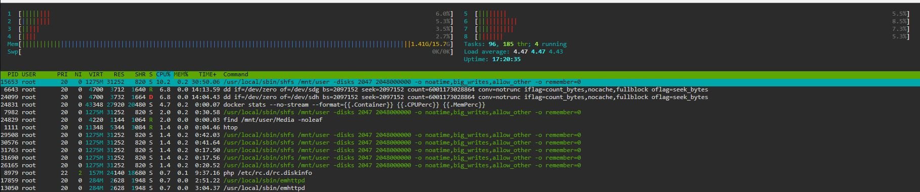

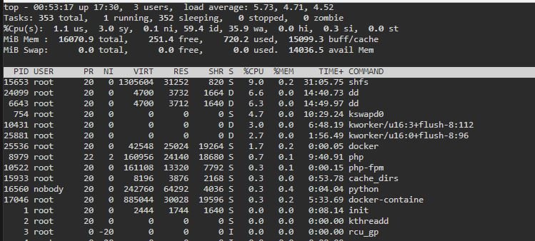

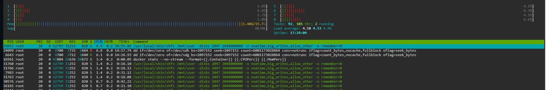

You may run "top" or "htop" in console
8 hours ago, TODDLT said:
TOTALLY AGREE, but I haven't found anything else that triggers the problem and it even happens deep into the process.  Any ideas on how to find this?
Will you periodically run parity check ( make disk/controller in load for long period ), result positive ?
Info: I run parity check monthly and SMART extend test for new add disk, 2 Unraid system equip single LSI HBA ( have UD but no preclear plugin) without problem.
Edited by Benson
Here are screen shots of TOP HTOP and my Dashboard... Obviously Dashboard is saying something different.  The below results were pretty consistent.
Edited by TODDLT

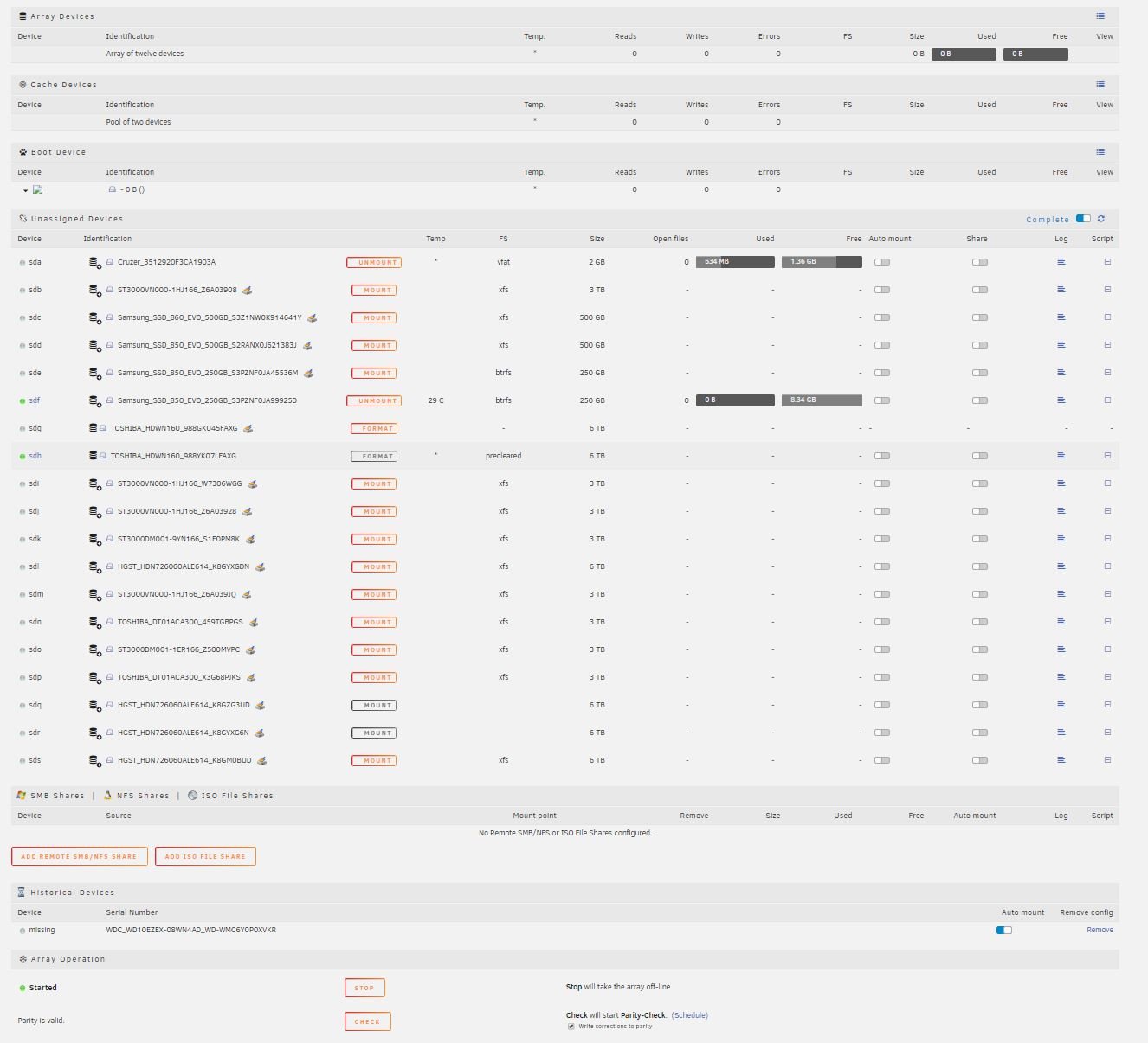

Morning Report:
I never got a "preclear failed" email, but this morning everything was in chaos again.
- No drives showing up as assigned, all in UD.  Sometimes it changes.
- bottom left hand corner status shows the array bouncing between "started" and "undefined"
- I CAN access shares
- Plex works
- When I click the diagnostics button, nothing happens. (screen blinks)
- Main Page and dashboard info is intermittent to populate, sometimes very slow to respond, but sometimes shows partial info and is not consistent.
Is there anywhere to go manually grab the log from the flash before rebooting?
