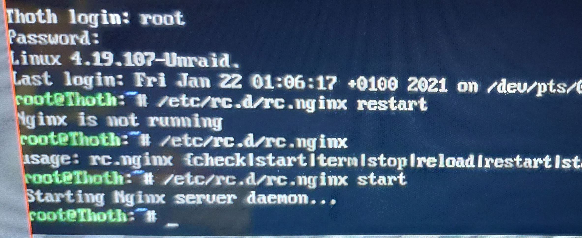

Only as feedback. I tried to enable BIND_MGT. For this it is need to execute the following:
/etc/rc.d/rc.nginx restart
I opened the Webterminal, executed it and the Webterminal was dead.
I think this happens because restarting Nginx means restarting the Webterminal and while its dead the Nginx restart command is interrupted. So finally it does not restart nginx, it kills it. But strangely it kills only the Webterminal and not the total WebGUI. So I though "hey you are having User Scripts. Let's use this to execute the restart". And now my next mistake ^^ I added a script and executed it through "Run Script" and not "Run in background". So again, nginx restart was killed while execution. And finally the complete WebGUI was dead.
Of course SSH was disabled 🙈, so I needed physical access to the server. Logged into the console, entered the command and.. nginx is not started. Ok, so I started it and everything was fine again.
So reminder to myself: Never restart a Webserver through the Webserver ^^
