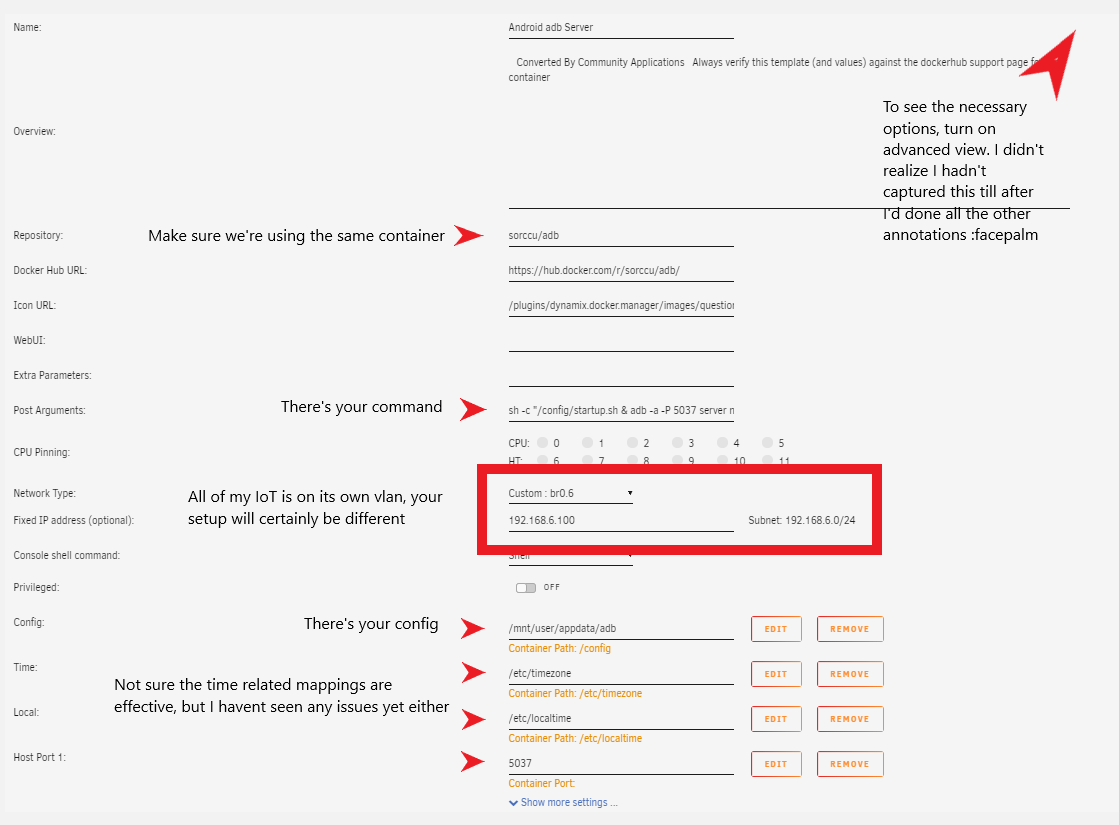

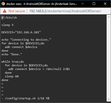

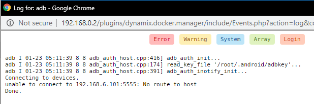

January 23, 20206 yr Just thought I'd share in case anyone else lands here like I did. I'm traveling for work and not at home, so there was only so much I could do, but based on my limited success, I can shed some light on getting the docker container config set up on unRAID along with the sh command that seems to be a point of confusion in this thread. Thanks to the video posted by @DZMM, I was able to figure this out fairly easily. I had also initially created the setup.sh script in the /config folder using notepad++, as this is how I frequently do it for Home Assistant, but there were formatting and permission issues (the latter was warned in the video) so I just recreated the file using vi from the container's terminal and presto. ADB isn't enabled on my TV at home, which is the limitation I mentioned earlier so I get the "No route to host" error, but I'm fairly confident this will work when I get it enabled. Good luck!
January 23, 20206 yr @anderbak thanks for this as I didn't know how to run the script command. It's still not working for me though which is weird as it keeps saying it can't find startup.sh. If I don't do chmod +x startup.sh it says 'permission denied', so it knows it's there. Any idea what's going wrong?? Thanks docker run -d --name='adb' --net='br0.55' --ip='192.168.50.19' --cpuset-cpus='1,7,8,17,23,24' --log-opt max-size='50m' --log-opt max-file='3' --privileged=true -e TZ="Europe/London" -e HOST_OS="Unraid" -v '/mnt/user/appdata/dockers/adb/':'/config':'rw' 'sorccu/adb' sh -c "/config/startup.sh & adb -a -P 5037 server nodaemon" #!/bin/sh sleep 5 DEVICES="192.168.30.30" echo "Connecting to devices." for device in $DEVICES; do adb connect $device done echo "Done." while true; do for device in $DEVICES; do adb connect $device (anglebracket) /dev/null 2(anglebracket)&1 done sleep 60 done

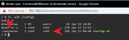

January 23, 20206 yr @DZMM That's the same permission issue I ran into when creating the setup.sh file using notepad++ and putting it in adb's appdata folder. Start by opening the adb container's console. Check your permissions by typing ls -alh /config I corrected mine using chmod 777 /config/startup.sh and chown root:root /config/startup.sh I also noticed in your post the same formatting errors that I had from c/p with notepad++. Your issue may just be c/p to your post, but verify you don't have the two "(anglebracket)" in your script. If you're not familiar with vi, it's unintuitive at first. After typing vi /config/startup.sh move your cursor to an area where you need to make a change. Hit "i" on your keyboard. Make the necessary changes. Hit the "esc" key when you're done making changes. Type ":wq" to write the changes and close the file. Restart adb. Edited January 23, 20206 yr by anderbak
