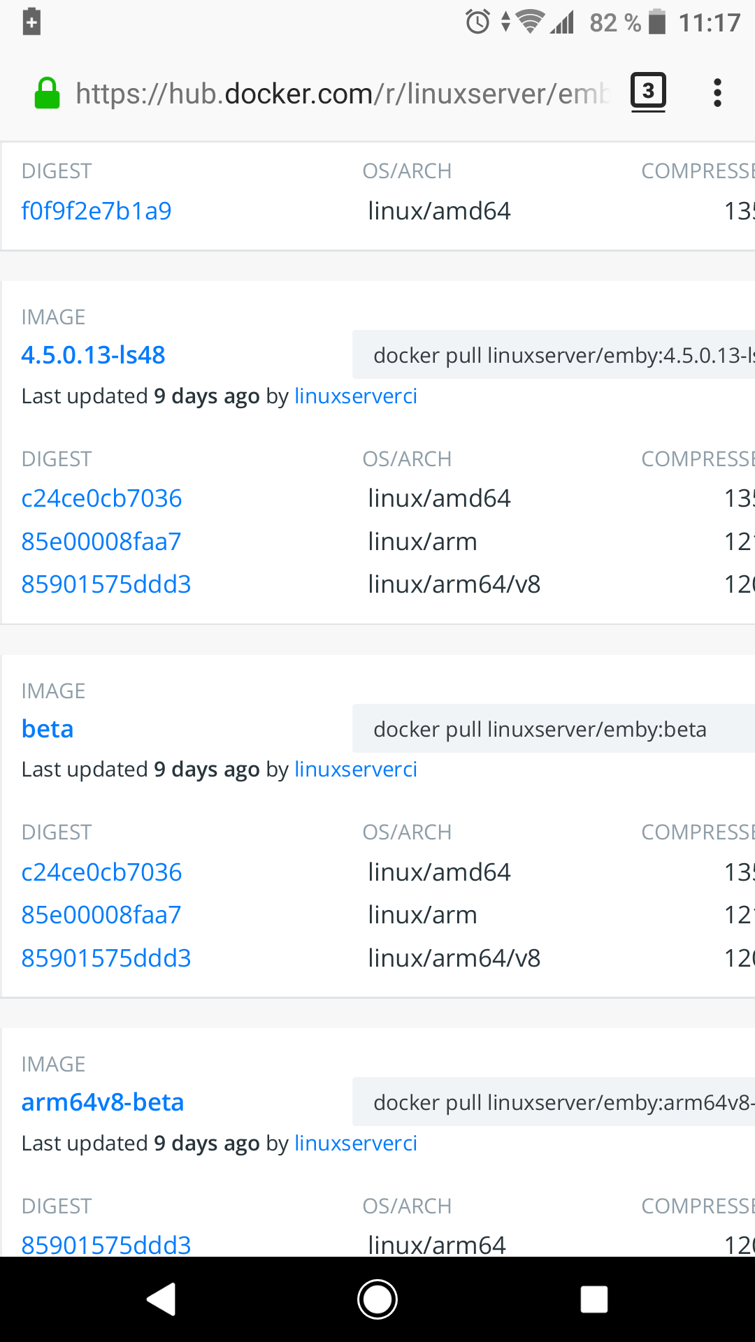

Could someone tell me if I am doing something wrong trying to update the beta version on this docker?  If I set the repository to: linuxserver/emby:beta it for some reason reverts me back to the 4.4.3.0 version of Emby.  If I use linuxserver/emby:4.5.0.13-ls48 or linuxserver/emby:4.5.0.12-ls46 it will install the correct version.  I'm definitely not a docker expert, but in looking at the "digest" numbers it seems like just the "beta" tag should be working.
From looking at docker hub, the beta tag points to 4.5.0.13-ls48
Edited by saarg
Thanks for looking at it saarg.  I tried linuxserver/emby:amd64-beta and that gave me the correct 4.5.0.13 version.  Tried just "beta" again and it rolled back to 4.4.3.0.  I opened "advanced" in docker and hit "force update" on the beta tag and then it switched back to 4.5.0.13...  Weird, dunno if there was something cached somewhere but that appears to have resolved it.
Most likely something with unraid that was the error then.

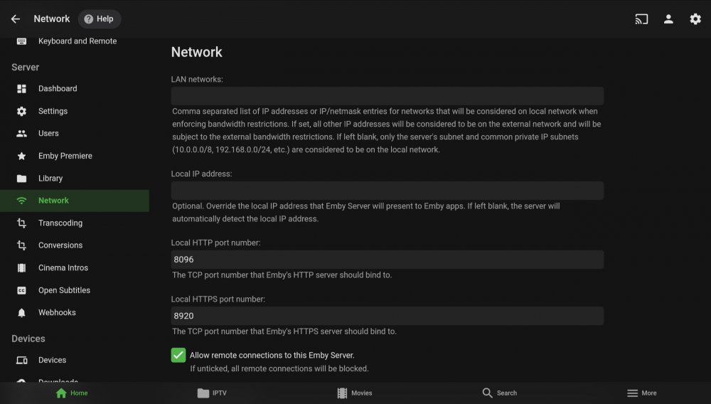

I've made the move from PLEX to Emby as I was tired of the constant buffering errors (Emby seems a lot better up to now).
Anyways, I've followed the Spaceinvader reverse-proxy youtube video and I'm happy with everything, EXCEPT for one thing, remote access.
I can access Emby via browser; emby.mydomain.com and everything is great, however when I try and use the app, I can only connect via port 80 and even then it will not accept any username/password combination???
I have gone over all my settings and they are pretty much a mirror image of what I had with PLEX. The Letsencrypt config file has been left as default.
Any advice would be greatly appreciated.
Thanks.

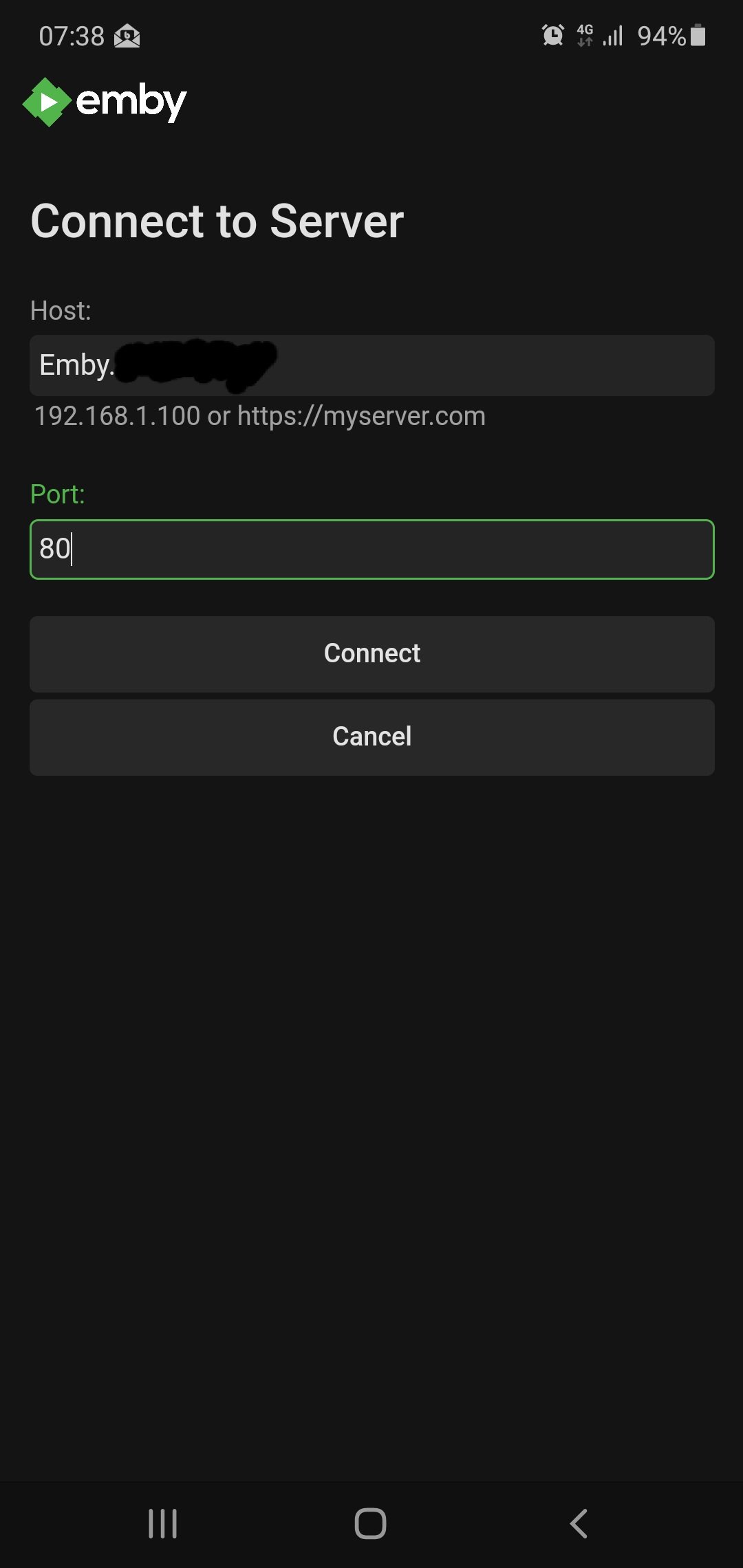

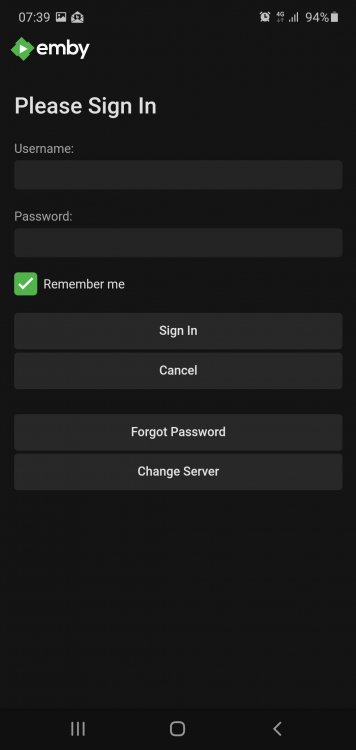

Thanks.
What have you entered in the server settings of the app? If you want https you need to use port https in the URL and also might have to set the port to 443.
Do you access the url locally or remotely when testing?
Do you use https in the browser?
Edited by saarg

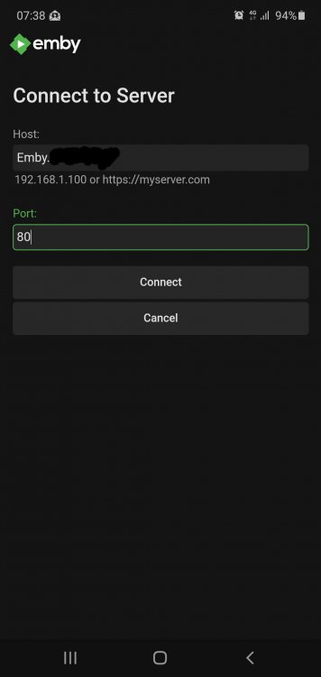

I have tried all kinds of variations in the app, the only one that gets me somewhere is entering; "emby.mydomain.com" along with port "80". However the login page that it takes me too won't accept any username/password combination, I've even removed the passwords from the emby user accounts, but it makes no difference.
As for being able to login via my browser, I test this remotely by ensuring I'm on 4G rather than my local network. Any combination of;
emby.mydomain.com
http://emby.mydomain.com
https://emby.mydomain.com
emby.mydomain.com:80
emby.mydomain.com:443
into the browser, all get me to the emby server by directing me to https://emby.mydomain.com.
Edited by LoneTraveler

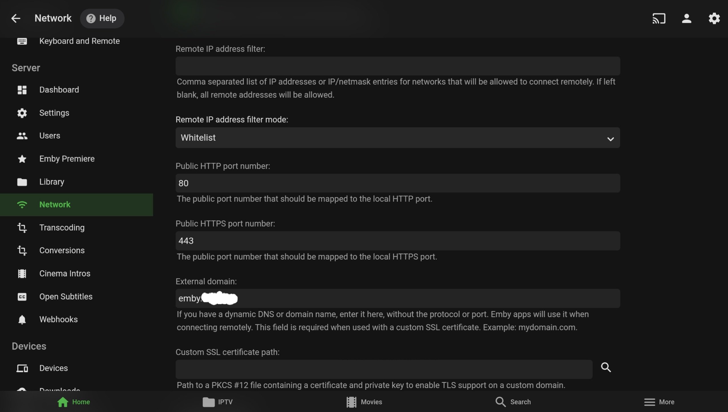

emby.mydomain.com

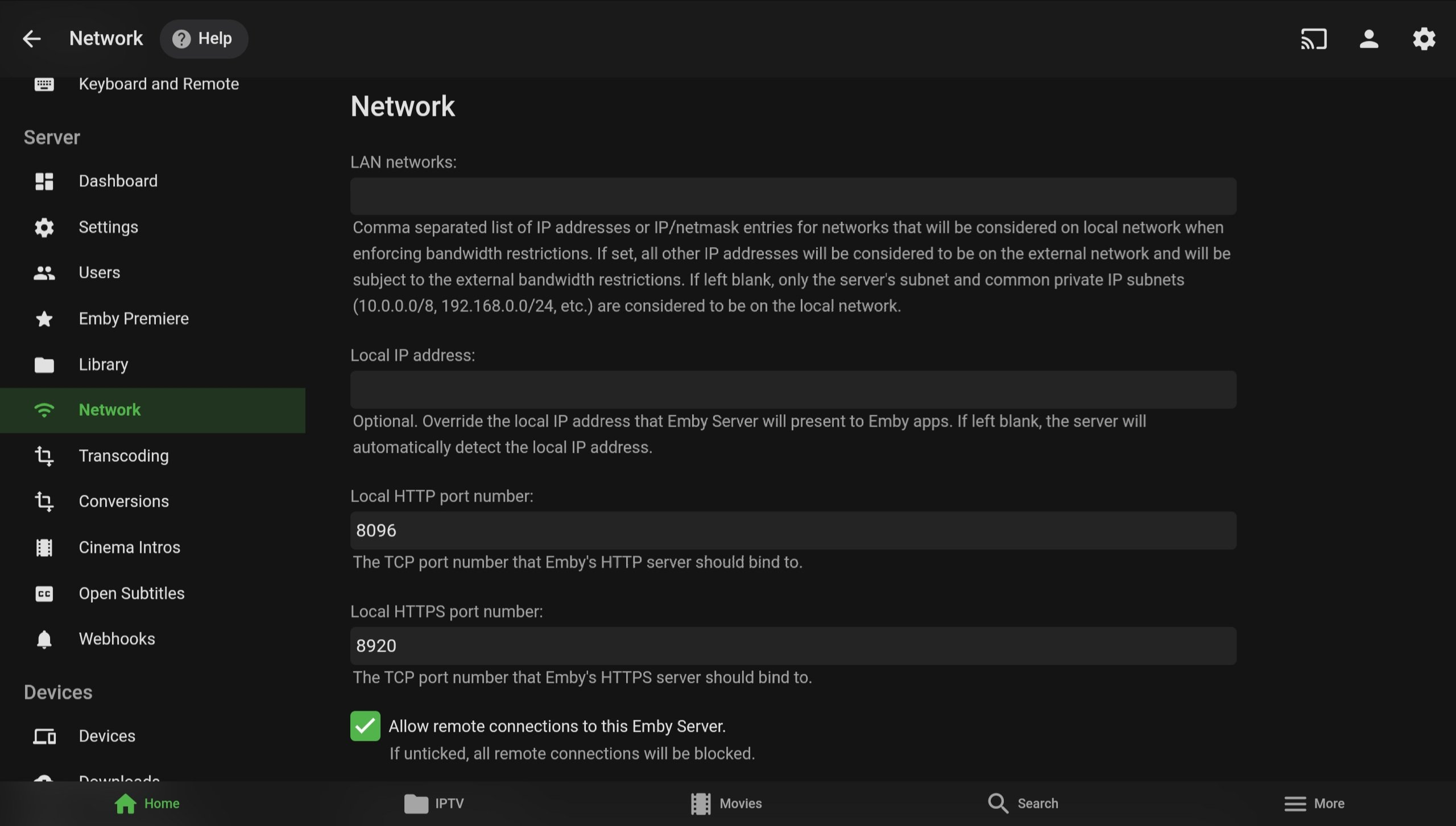

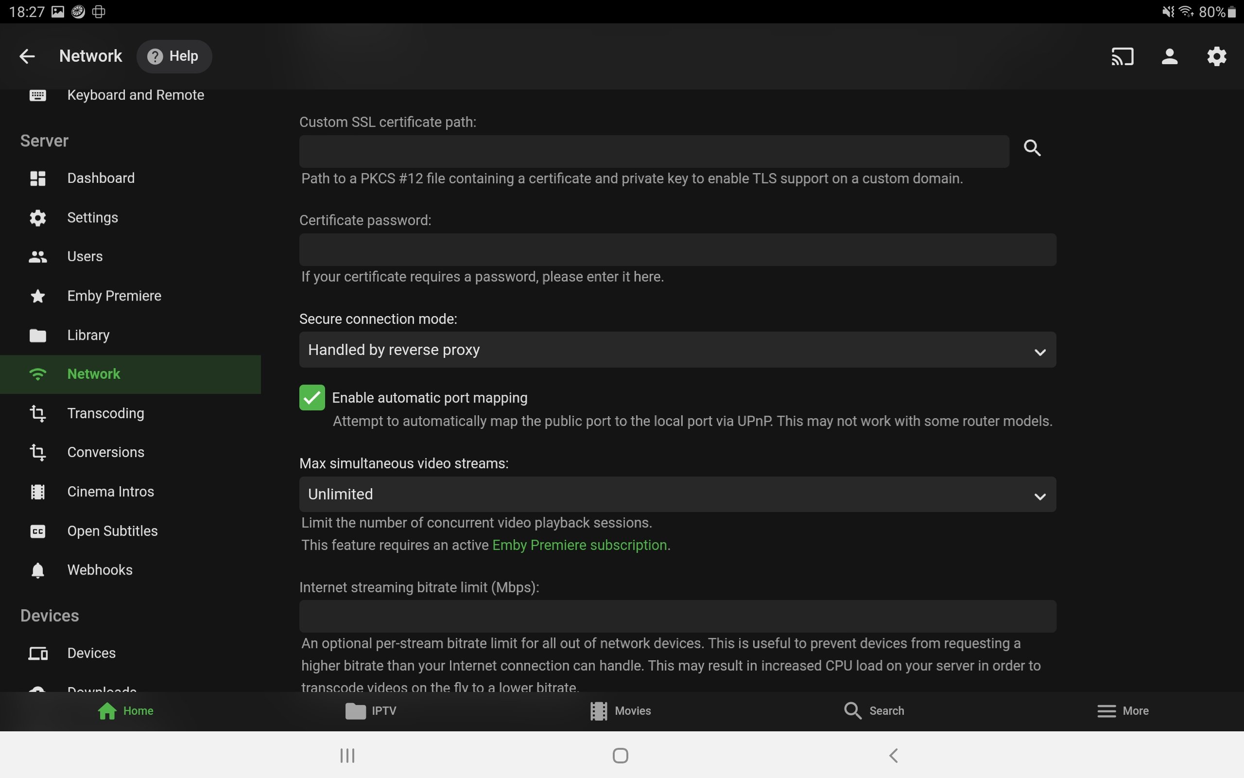

You can't remove the login on remote access. So you will need to log in.
Use https://emby.domain.com in the server address and 443 in the port field.
Also try to remove the automatic port mapping setting under the secure connection mode.

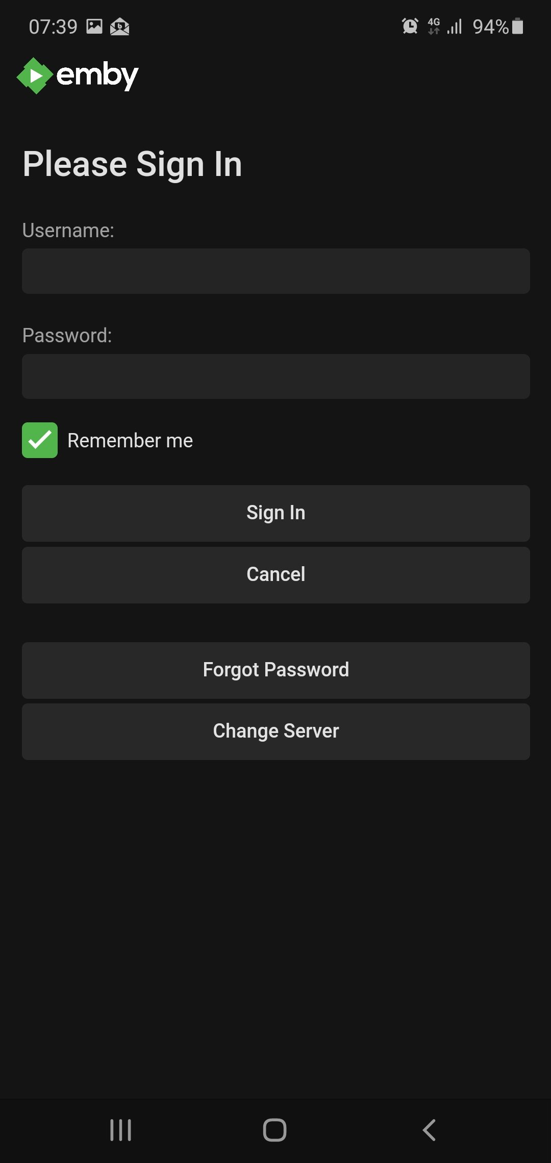

It doesn't really make sense that you can't log in using the client. What does it say when you try to login?
3 hours ago, saarg said:
I
I've just tried what you suggested and it worked first time, I honestly don't know why it is working now, but I won't dwell on that. 😂
Thank you very much for taking the time to help, much appreciated.
