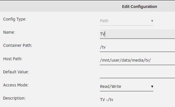

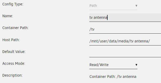

How do I setup paths for this Emby container for two tv folders?  Here are the two I want:
  1. /data/media/tv/    (used for tv shows from Usenet)
  2. /data/media/tv antenna/    (used for tv shows from antenna and Emby DVR)
My share is "data".
Here is for 1. data/media/tv
Do I need to create a another container path for "tv antenna" for recordings? If yes, what do I put for container path and host path?
The following did not work:
Edited by xrqp
My share is "data".
You can't use the same container path in two folder mappings. They need to be different.

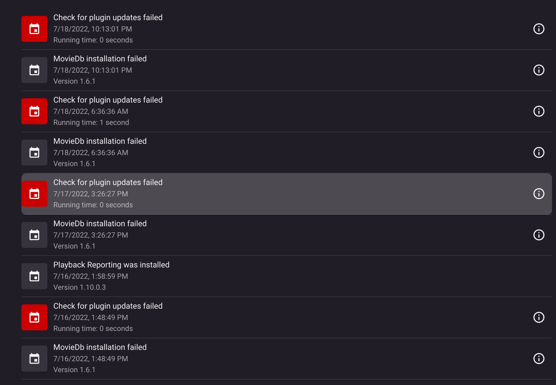

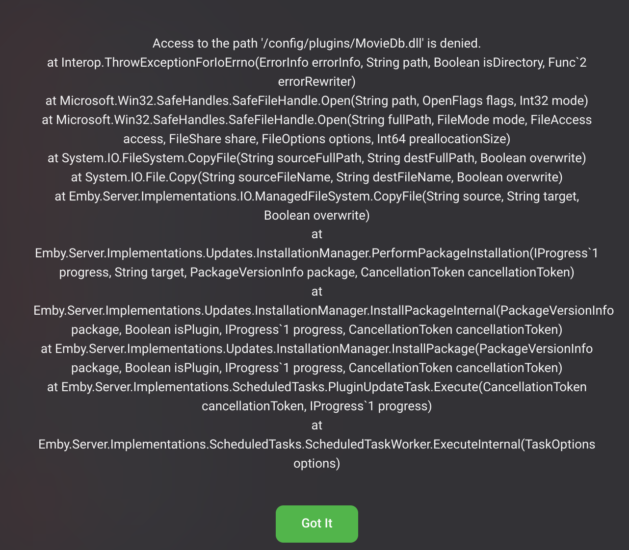

Hello all for the past few days emby has been giving me an error saying "check for plugins updates failed".  Clicking on the overview on the plugin it says "Access to the path '/config/plugins/MovieDb.dll' is denied".  Not sure what can be causing this all of a sudden. Any insight would be much appreciated.
Edited by jluna
