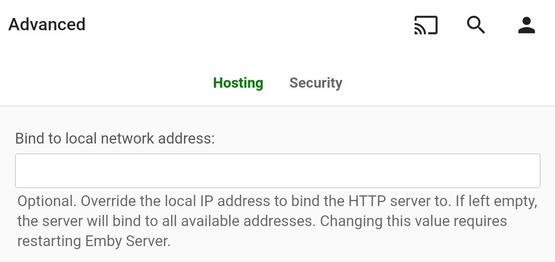

I have an issue that's driving me a little nuts.
I have emby as a docker container and because docker assigns it a private 172.17.x.x address clients inside my home network can't access the server when logging in using emby connect.  I can give the container it's own IP address on my network which fixes that issue but then other apps such as Sonarr and Radarr can't talk to it.
Any ideas?
Think you need to set your IP here. The second issue is caused by a security "feature" of docker.
This worked, thank you. I can't believe I overlooked it.  Just started using Emby yesterday from Plex and learning the ropes.

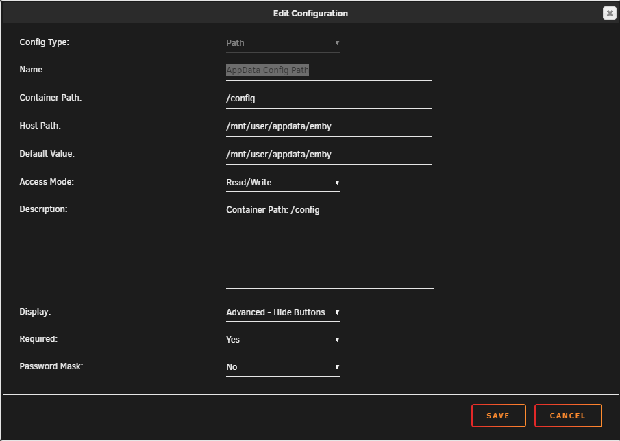

How to split media content to a unassigned drive in the Docker config?
I can see that this Docker image uses:
So would I keep this and just create a new path for:
metadata?
On the Emby Docker created by Emby I just pointed everything to the Unassigned drive in the:
metadata?
I'm not sure what you are asking here. You first talk about media content, then about metadata.
