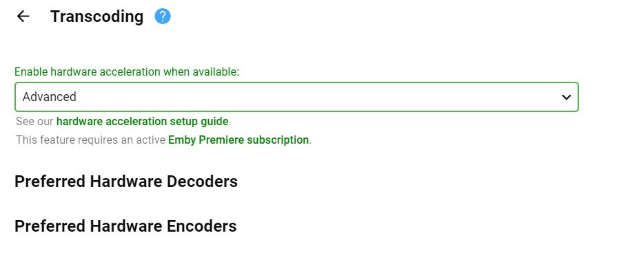

So with the latest Unraid beta release (6.9 beta 35), GPU drivers have been added to the OS.
I had a quick stab at getting an AMD GPU passed through to the lsio Emby Docker, but have run in to an issue.
I enabled the AMDGPU driver on Unraid, I installed the lsio Emby Docker with the `/dev/dri/` device added.
Emby Server shows my GPU available for transcoding (I have Emby Premiere so no restriction on transcode).
I started a transcode job, and it was using the CPU, not GPU to transcode.
Looking at the transcode log, it looks like it attempted to open the GPU for transcoding, but failed and fell back to CPU.
I've attached the Emby transcode log, but the first error that occurs is:
/home/embybuilder/Buildbot/x64/libdrm-x64/staging/share/libdrm/amdgpu.ids: No such file or directory
Then FFMPEG fails with some sort of I/O error.
I had a look in the docker container, and the `/home/embybuilder` directory did not exist...
Is there something else I should be doing to get this working?
ffmpeg-transcode-646aefab-ad63-4910-a5d6-fc108c6b9031_1.txt 48.16 kB · 0 downloads
I pulled out an old Radeon card I had kicking around to play with and see if I could get it to work with Jellyfin
I'm on RC2 now, setup the driver modprob.d thing
From Jellyfin docs (basically same as Emby), you need to use this parm on the docker container:
--device /dev/dri/renderD128:/dev/dri/renderD128
--device /dev/dri/card0:/dev/dri/card0
I did that, enabled VAAPI encoding in Jellyfin and tried playing a file.. it seems to be picking up the card, but transcoding is slooooow
I'm thinking maybe my Radeon is just too old and doesn't support enough to do the job, not sure... but does seem to be trying to use it, my cpu didn't do much at all while this was happening
