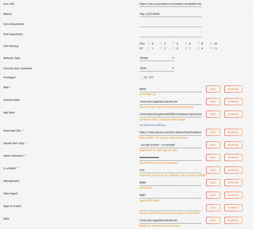

If you want a fully persistent install, for some reason Splunk throws some pretty odd errors. They don't seem to hinder functionality) so if you're cool ignoring them then you can do the following @wedge22 @GHunter
Just add a volume for /opt/splunk/etc.
/opt/splunk/etc directory stores all of your customisation. By default we already have a volume for /opt/splunk/var, the directory that stores all indexed data; so with these two your install should feel fully persistent.

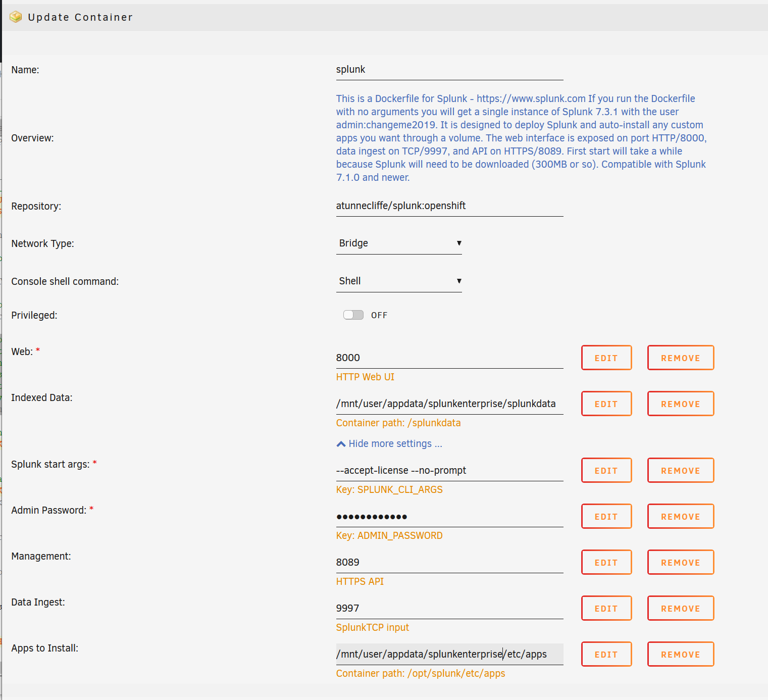

In an attempt to make this answer a bit more useful, here's a screenshot showing my container config, change being the added "App Data" volume:
Edited by andrew207
add more info

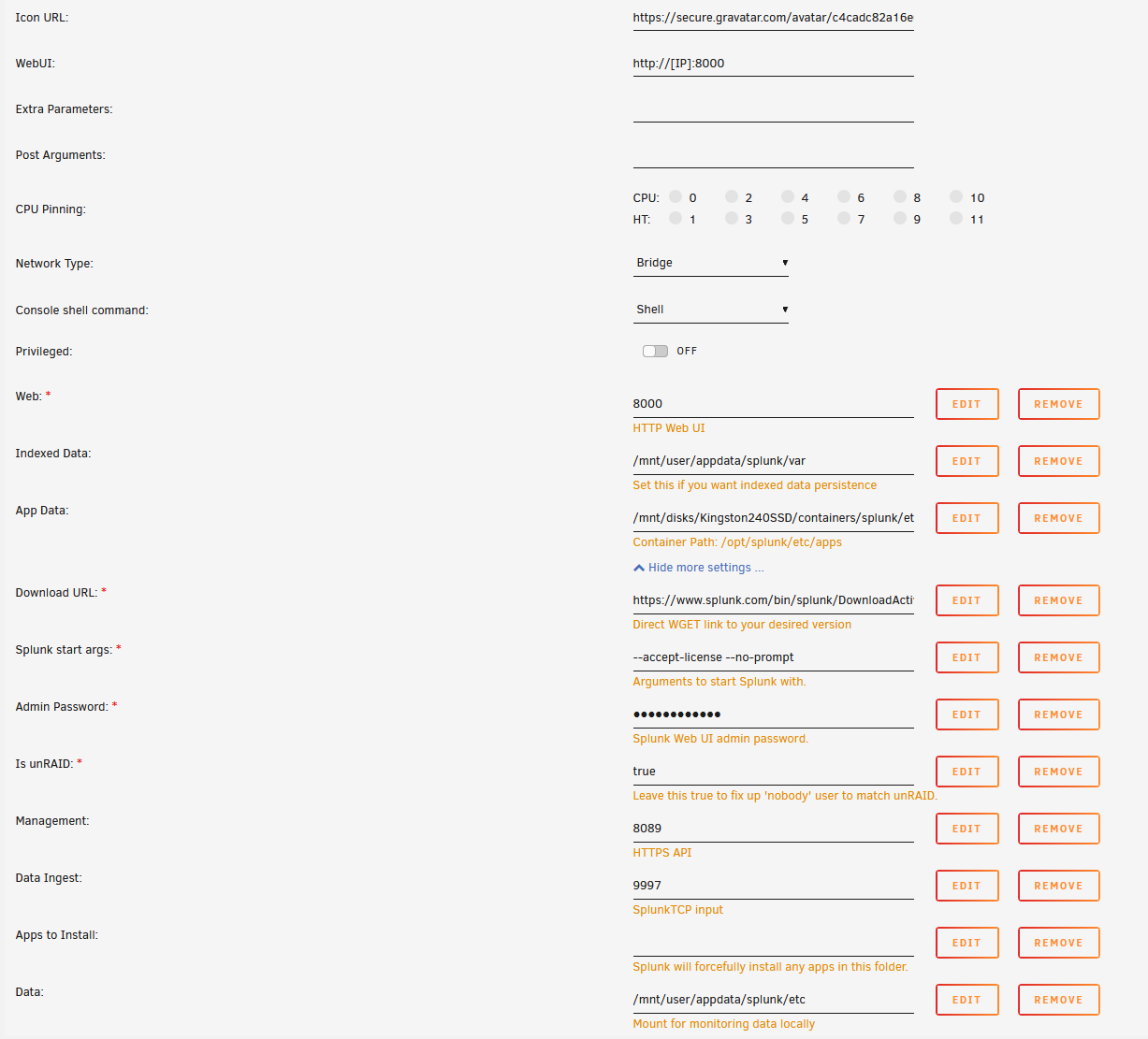

To make your inputs.conf persistent set this path: image.png.01e2f8389ba28bade2779815881fdd1b.png
As for your port 514, you'll have to expose that port yourself as it's not done by default; I only expose 8000 (web) 8089 (https api) and 9997 (splunk data). Just make it available through unRAID's docker edit screen same as those three are configured and it should work fine.

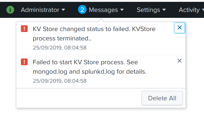

Yeah @wedge22 persistent data has been challenging, when I convert the /opt/splunk/var/lib/ directory (i.e. where Splunk stores indexed data) to a volume the KV store crashes. You can make it a volume yourself -- search / report / alert etc will still work if you make it a volume, but you get a permanent "message" about KV store being dead.
I'm working on it though, we'll get there hopefully in the next week or so alongside a rebase to Alpine. https://github.com/andrew207/splunk/tree/openshift
Edited by andrew207
add pic
Thanks for the update, I was just trying to configure it again now but I may as well wait.
@wedge22 @mgiggs Fixed, I'll be pushing it to master shortly and it'll be available through unRAID's interface whenever they update their repos; probably a day or two. it's now published and available.
If you want it now set your config up thusly - note adding :openshift tag to the repo, and make sure the volumes are exact:
For anyone interested, I'm still not certain why the kvstore was failing previously (probably volume permissions?); the issue was mitigated by moving the SPLUNK_DB to a proper standalone volume (and separating the KVstore from SPLUNK_DB). This means your KVstore isn't persistent, but chances are for a small standalone install that won't matter.
