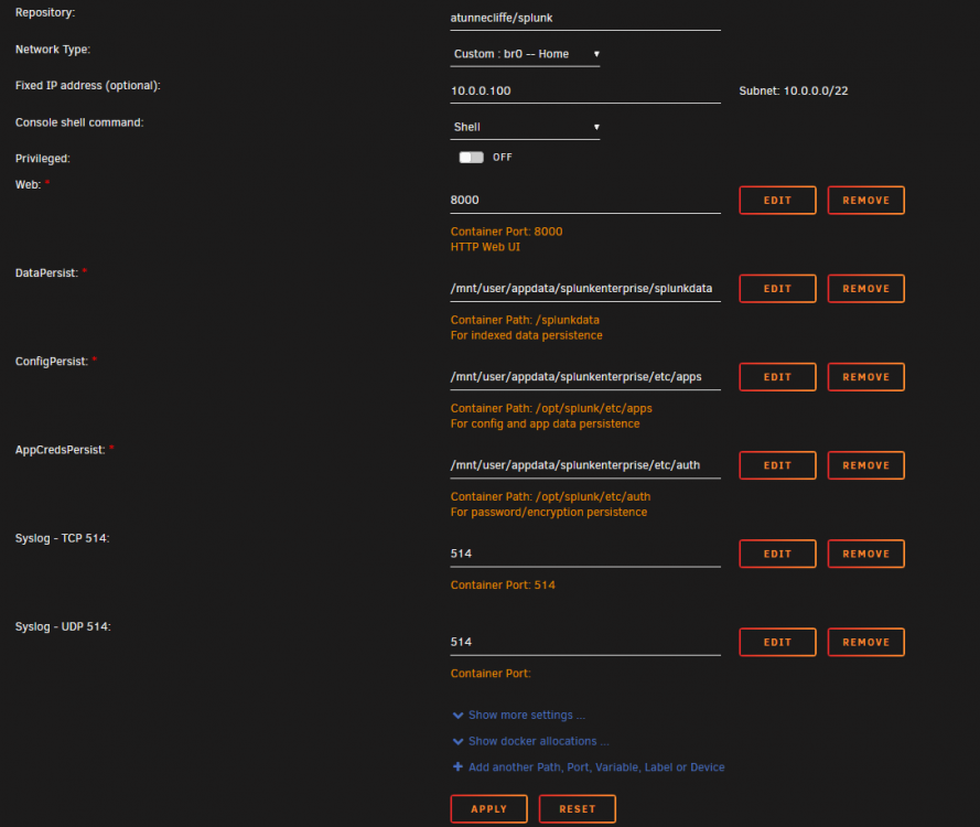

Then add a port mapping in your docker config for the Splunk container. In the edit screen for the container, click "add a port, path, variable, label, or device" and fill it out appropriately, perhaps like the image I've attached. In my example I've mapped the container's port 514 to the local br0 port 10514.

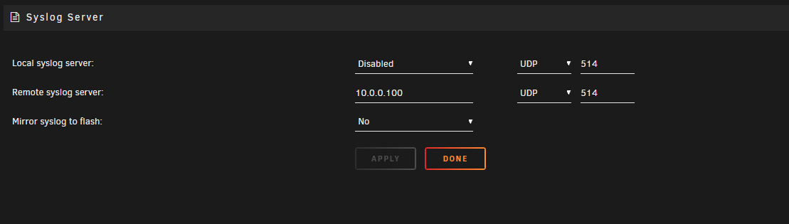

In unRAID's syslog settings (settings --> syslog) under "remote syslog server", type in the IP of your unRAID server, and set the port to the mapped port, in our example 10514.

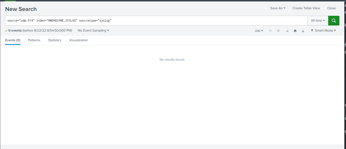

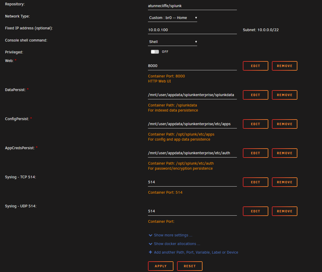

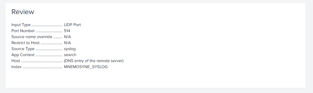

Hi Andrew,
Here is an example pics of my config for the container and my config on the Splunk file. Nothing coming through on either UDP or TCP when I try either.

That should work. There are two things you can check:
1. Make sure the port is actually open/listening. Just open a terminal to the docker container and check netstat to make sure port 514 is open and listening. I just added 514 to my server, you can see it listed below as being open.
/opt/splunk # netstat -anp | grep splunkd | grep 'LISTEN\|udp'
tcp        0      0 0.0.0.0:9997            0.0.0.0:*               LISTEN      71/splunkd
tcp        0      0 0.0.0.0:8000            0.0.0.0:*               LISTEN      71/splunkd
tcp        0      0 0.0.0.0:8089            0.0.0.0:*               LISTEN      71/splunkd
tcp        0      0 0.0.0.0:8088            0.0.0.0:*               LISTEN      71/splunkd
udp        0      0 0.0.0.0:514             0.0.0.0:*                           71/splunkd
/opt/splunk #
2. Send a test syslog message. I'm sending to 10514 because that's what I mapped the port to as described in my previous post. You should send to your custom IP:514, because that's what you have configured.
Something like:
~ >>> nc -v -u 192.168.1.121 10514
hi, i'm sendign some data to my syslog listener
wow!
^CExiting.
~ took 10s >>>
Check if it lands in the index. It should, mine did just fine.
If this works for you then the problem lies elsewhere, perhaps ask in a broader unRAID support section about remote syslogging.
OK, test messages worked.
So it is most likely Unraid that isn't sending remote logs.
