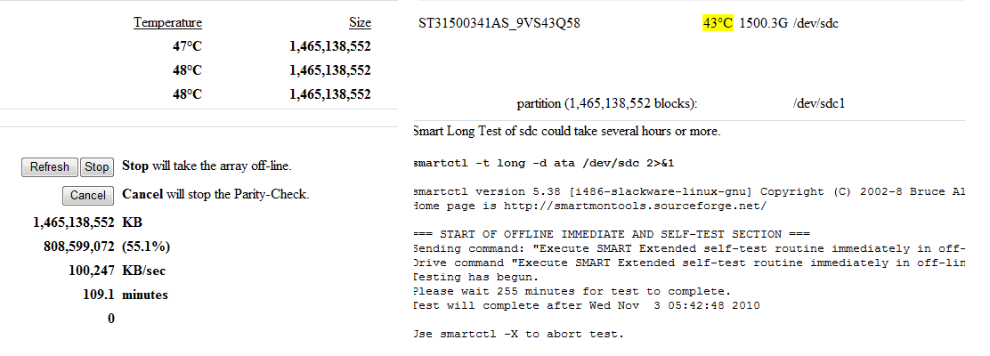

I've got an IcyDock installed recently with 4 7200.11 drives.  3 of the drives are in the array.  The 4th is pre-cleared.  I started a parity check so the 3 will be active.  I started a long smart test on the 4th.  The 5th slot is empty.  So that it wouldn't steal the air flow I put some tape on the inside of it's air holes.  At 9% finished the 3 drives are at 45/46c and the 4th is at 41c.  I'll let it run and report again later.
Edit:  Parity check is 50% done and the temps stablized at 47/48c for the array drives.  When just playing movies the temps hang between 36c and 40c.
Edit: Parity check is at 80%.  I have had a speed control on the 12cm case fan turned way down...but I just turned it up to near it's highest speed.  The temps are easing down now to 45/46c.  I have a second IcyDock in the case but no drives in it.  I believe what's happening is that the second IcyDock blowing into the case and the case fan not exhausting fast enough has caused some push back on the first IcyDock causing it not to exhaust air at it's intended cfs, making the temps to rise above what they should.
I'll let it continue running and report back a little later.
Edit:  Parity check at 99.7%.  Temps at 45c now.  Increasing case exhaust fan speed helped lower the temps.  It's still a pretty slow case fan so I'm going to trade it out for a temperature controlled fan that has higher cfs and run the test again.
46 C would make me uncomfortable and tempted to shut down the test...but as long as it is in the name of science :P
I suppose I let one of my older drives that I don't care about run at 47 C for a day or two during a similar test of one of my prototype builds.  The only reason I keep that drive around is to run these kind of heat tests, though, I don't trust it with any data.  At 50 C I would cancel any test and just consider it to be a failure.
47/48C? That sounds scary...

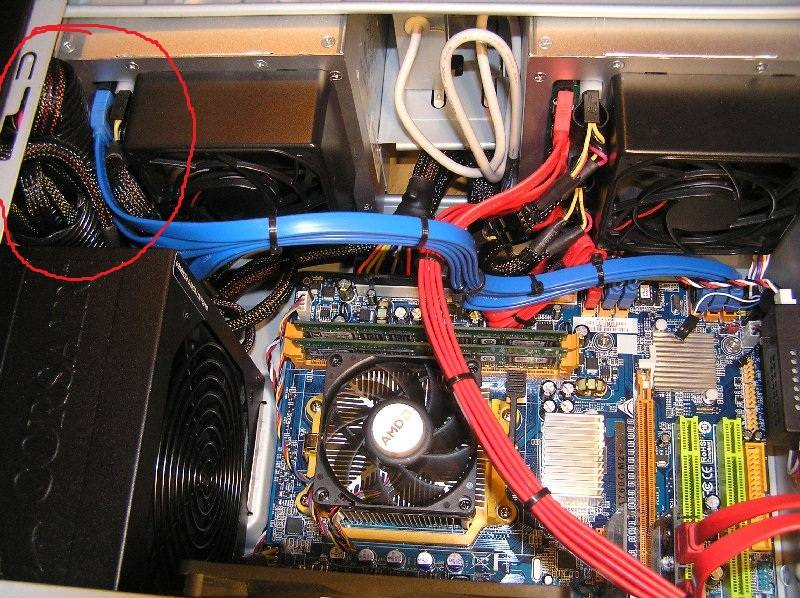

I added a 5th drive and did some spin up tests.  I discovered that the space above the cage was blocked off so no airflow was getting up there.  I fixed that.  That dropped the idle temp down to 39c for the two hottest drives which is better.  But oddly the 5th drive temp is 35c.  It's a 500GB 7200.11 drive while the others are 1.5TB.  One of the bigger drives (in the leftmost slot) only got up to 37c.
Keeping the cage itself cooler by allowing air flow above it has helped.  The cage is aluminum.  I'm going to experiment some more with airflow around the outside of the cage.

I had coiled up the extra psu cables and stowed them between the psu and the IcyDock, which completely blocked off the air space above it.  Now I've moved those so the space is open.  I have also put a couple inches of bendable plastic on the Icy's fan bracket that curves along the blue sata cables so the cage's exhaust air is encouraged to blow down and will not reflect upwards into the air gap.  Simple but overlooked.
