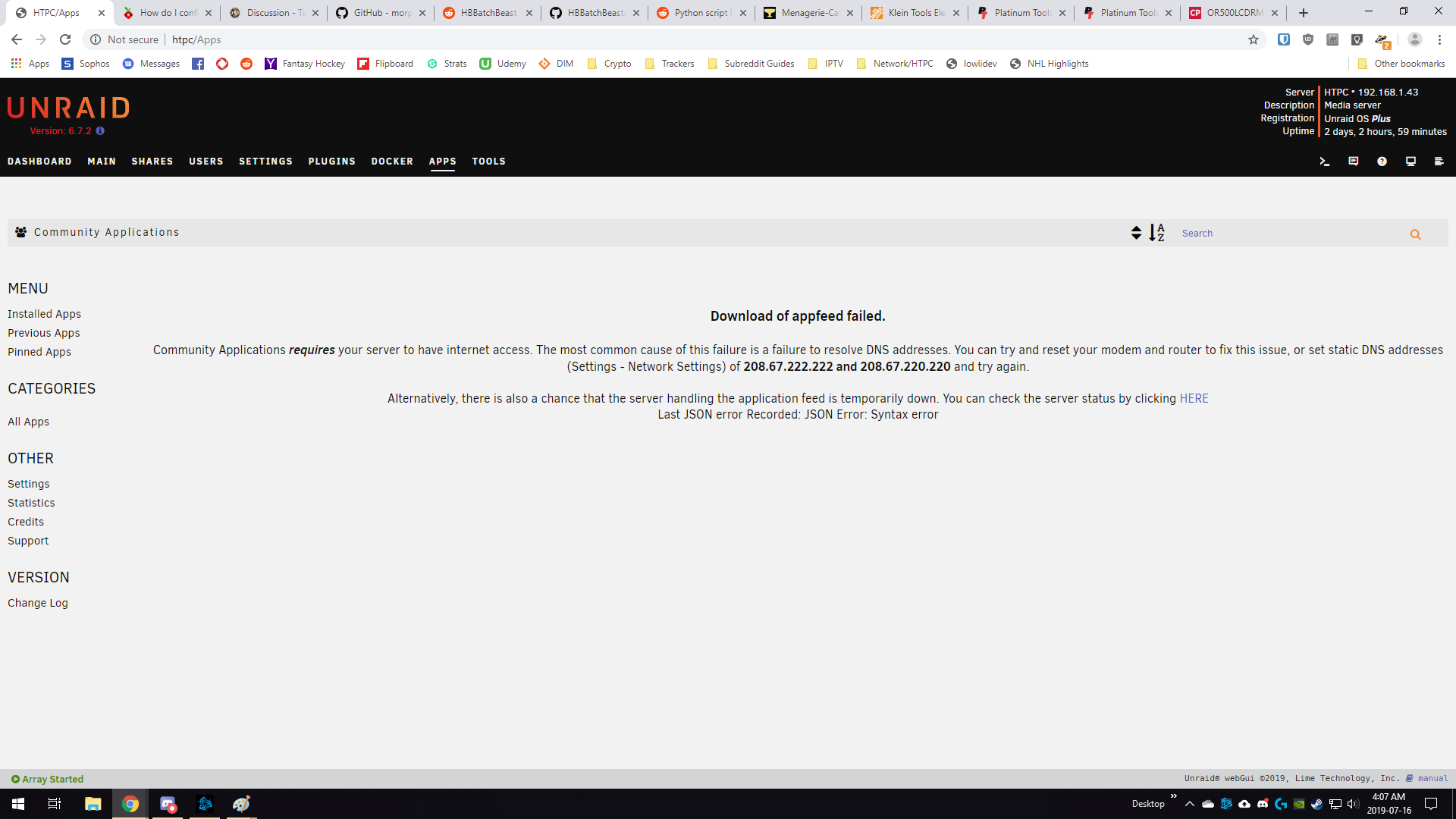

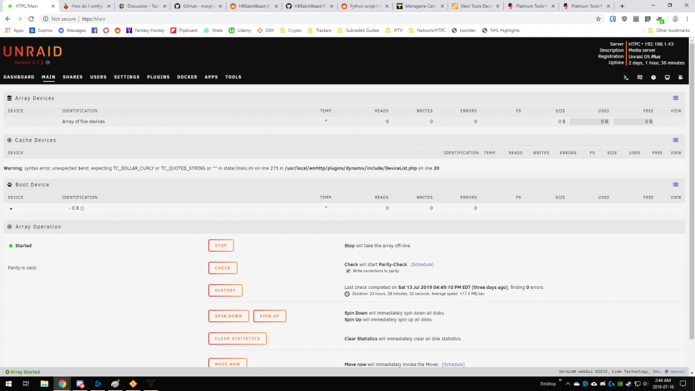

July 16, 20197 yr First off, I posted this issue before, but didn't get much traction or assistance. Link to that post is here So since then the issue has cropped up again. I've since updated to 6.7.2 thinking that it may help resolve it, but within a couple days of updating to 6.7.2, I encountered a similar issue. It does present itself differently than it did in 6.6.7 though. Here's a couple screenshots of what I'm seeing in the UI Main page And the apps page The UI is largely unresponsive. I cannot reboot it from the UI, it must be done via terminal. Once it's rebooted, everything works for a while, but after a few days the issue will crop up again. I have not rebooted yet, so the system is still in this state (has been since last night sometime), but Plex and everything still works. I tried to get a diagnostics logs, but unfortunately it won't download. I can click download, but then I get a blank page, and nothing happens. Not sure if there is any other way to get a diagnostics log elsewhere, or something I can run in terminal. Any help with this would be greatly appreciated.
