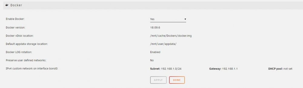

I hope this is the correct area for this question.
Every once in a while I get an email notification that says "unRAID Status: Warning - Docker image disk utilization of 88%.  Then later it I get a "returned to normal" email.
My docker and app data are stored on a cache disk (SSD) that is only used for appdata.  It's a 250 GB disk and 27% full.

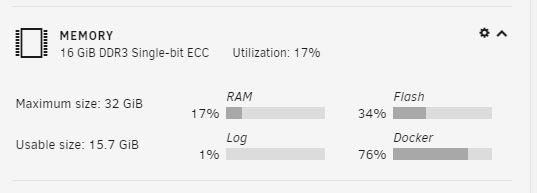

I have attached two images that show my docker settings and memory usage (which shows docker usage at 76%).
Is it possible when my Plex app is transcoding and/or doing DVR recording, and using up too much memory?  If so can this be offloaded to the SSD Cache?
I have plenty of cache drive space, is there a setting wrong that is driving it to use memory instead of the cache disk?  how do I get more Docker Image space?
Thanks for any help.
1007865769_MemoryUsage.JPG.ab9ae300e3b89653d9fee53dc629a1d1.JPG428996781_DockerSettings.thumb.JPG.371cb7dfecd30b06eb205ce60248f60a.JPG

You should probably prob9de a screenshot of the settings you have for your Plex docker container if that is the one you suspect might be causing your issue.
The docker image utilization will grow and shrink normally during container updates. If you don't want the warnings, either expand the image so the temporary growth during updates doesn't pass the warning level, or change the warning level up a couple points until you don't get it during normal updates. If there is too little space, the container update may fail, possibly corrupting the image forcing you to recreate it.
What I do is make sure there is enough free space inside the image so normal updates don't cross the warning threshold.

How do you expand the size of the docker image?   Is this housed in RAM, or in Cache?
None of my dockers "auto-update" and this warning comes around at seemingly random times.  What "update" would be occurring to cause this?
Generally, you docker.img should never need to be any larger than 20GB.  If it needs to be larger than that, that's usually an indication that some docker container(s) are configured improperly and are storing data in docker.img.

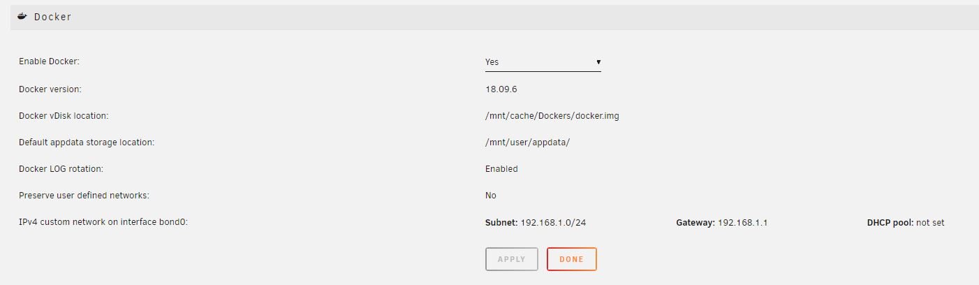

Settings - docker.  Stop the service, increase the size, restart the service
Wherever you've set it in Settings - Docker.  Usually on the cache drive

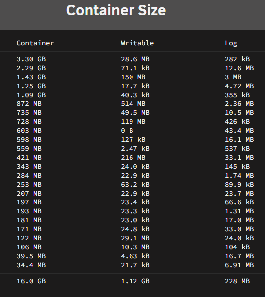

 What you want to do is go to Docker, and then hit Calculate Container Size when that happens, and before you get
Net result is that some app is storing stuff within the docker image and then it gets moved out / deleted.  Plex is a possibility, but download clients are IMO more common for this.

Thanks!   It's been long enough since I first enabled Dockers I wasn't remembering.
The image file was set to 10GB and I upped it to 30GB so now down to 23% usage.
There is also something called Log rotation, which I imagine is saving 1, 2, or 3 files in history for troubleshooting purposes.  Mine was set to 1 file 50 MB in size.   I upped it to 3 files 100 MB.  Not sure in relative terms how big this should be with on 7 dockers installed and 3 that run under daily normal situations.  I assume the more dockers you have running the larger that file should be?
Doesn't seem particularly important at this point but no download clients installed here.  The only real active Docker is Plex.
Thanks again, that should hopefully solve the issue.

In the Docker tab you can click on the image.png.2cc1f00a02eda930ce405bbf54f46b73.pngbutton to see how much space each container is occupying in docker.img. If some look unusually large, it is likely that data is being stored in the container due to improper configuration

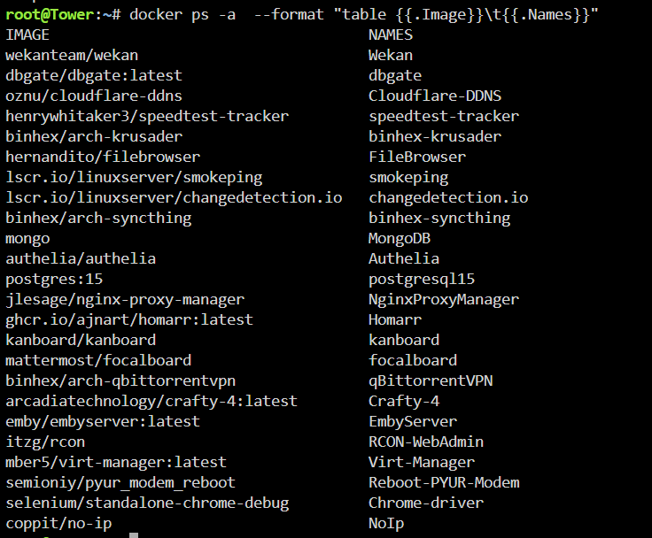

I've got 52 running containers with 107GB in use. It isn't growing except for whilst running updates.
Most containers that use a lot of space, are the ones that already have large Images. How would you honestly stay below the 20GB? Isnt the complete installation of the image also in the docker image? The executables?

I tried the Container Size button and it isn't matching up with what I've got on the Dashboard.
Somehow I'm using up 98% of 60GB
