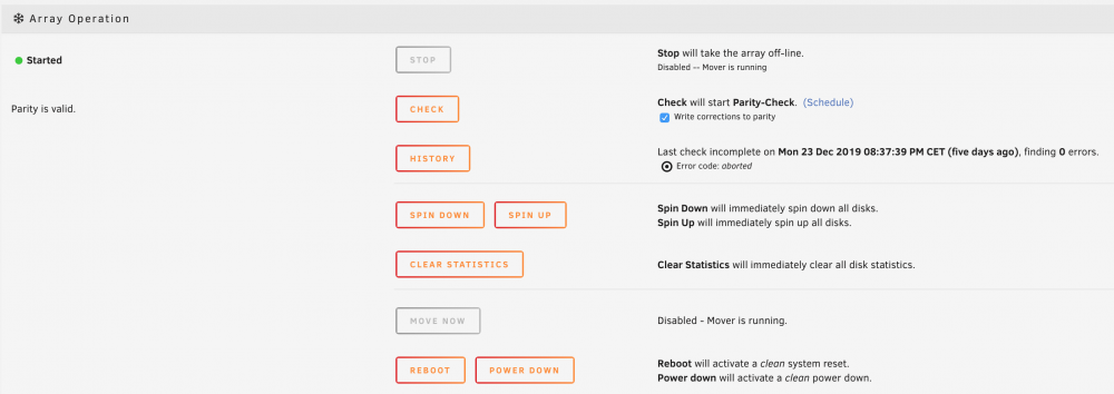

Hi!
My cache drive was getting full so I wanted to empty it today. I realised that I had set the appdata share to "prefer" cache so I changed its cache setting to "yes" and made sure all other shares have "yes" as well. In addition I stopped all docker containers and all VMs. Then I started the move.

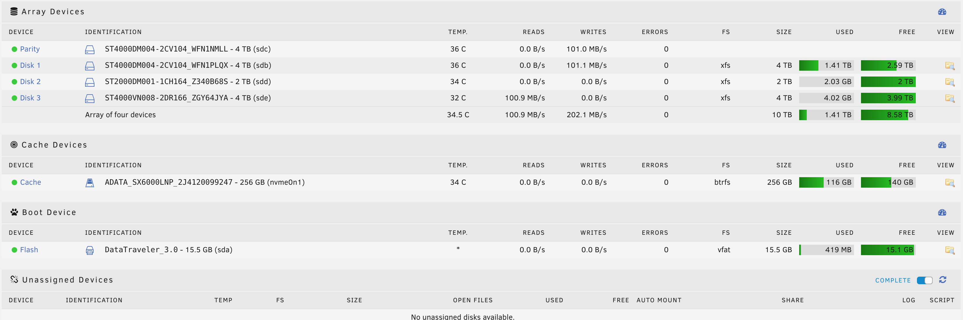

The problem is that it has been doing the move for a long time now (2 hours) and it is reading from one drive in the array that is almost empty and writing to another drive and to the parity disk. It is however not reading from the cache drive. Some data seems to have been moved of the cache, but very slowly. Is this how it is supposed to work?
It does not seem logical to only move things around in the array when I actually want to move from cache to array?
See attached screenshots.
I also activated "turbo write mode" in an attempt to speed the process up.

Still, I wonder why there is no activity on the cache drive at all during the move, only on two of the drives in the array?

From the terminal,
mover stop
Then under settings, scheduler, mover settings, enable mover logging
Then restart mover.  After a suitable delay for when you see what you were seeing before, post your diagnostics
