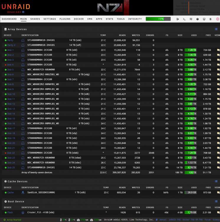

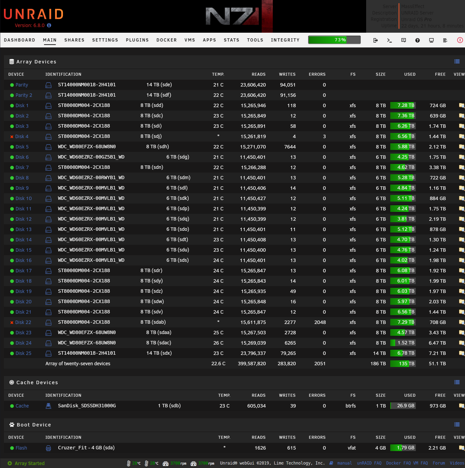

Over this past weekend I decided to kick off a Parity Check while I was on vacation (it had been 88 days... yeah, I know 😂). To my horror, I received an email from UNRAID that one of my 8TB disks failed with 2,000+ errors. No worries, "I have dual parity", I thought, and immediately drop shipped a new 14TB drive to my door. The parity check continued on... A few hours later, I got another horrific email that a second 8TB drive threw 3 errors and is now also disabled. So now I'm worried. I drop shipped a second 14TB drive to my door, and could not wait to get home and sort this out. Needless to say, the parity check ended in error due to the double failure.
Welp, now I am at home and am currently in the process of pre-clearing both drives.
Note: ALL data is backed up both onsite and offsite. Even so, I'm still unsettled.
QUESTION: Though it sounds like it is possible to REBUILD 2 DRIVES SIMULTANEOUSLY via DUAL PARITY, should I? Or would it be safer to get 1 drive up and running to provide fault protection, and then get the second up after that. Right now, if a third drive dies, I'm actually going to lose data.
My goal here is to get back up and running with the LEAST amount of reads/writes to the existing disks so I can once again have fault tolerance. My assumption is that if I rebuild both drives at the same time, it would be half as much overall I/O as rebuilding both drives separately, and the same I/O per disk array-wide (I'm assuming generally speaking that 1 rebuild has similar per disk I/O on other disks in array as 2 rebuilds). Rebuilding both would also presumably save some time and I would be back to dual fault protection in one shot. However, it is probably the exact same trade off benefit-wise with having fault tolerance sooner by getting at least 1 drive up.
So to sum up, I'm trying to tread carefully and reduce the risk of a third drive failing. I'll probably open a separate topic (or we can discuss here later) about these 2 disks (Shucked Seagate Backup Plus) and why they may have possibly failed at the same time. I'm just hoping these drives aren't cursed.

This all being said, clearly there was some type of issue with reads/writes. I would like to get to the bottom of it if you think it is worth it, but my priority is getting stability at this point.

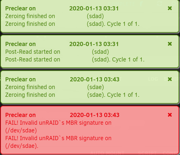

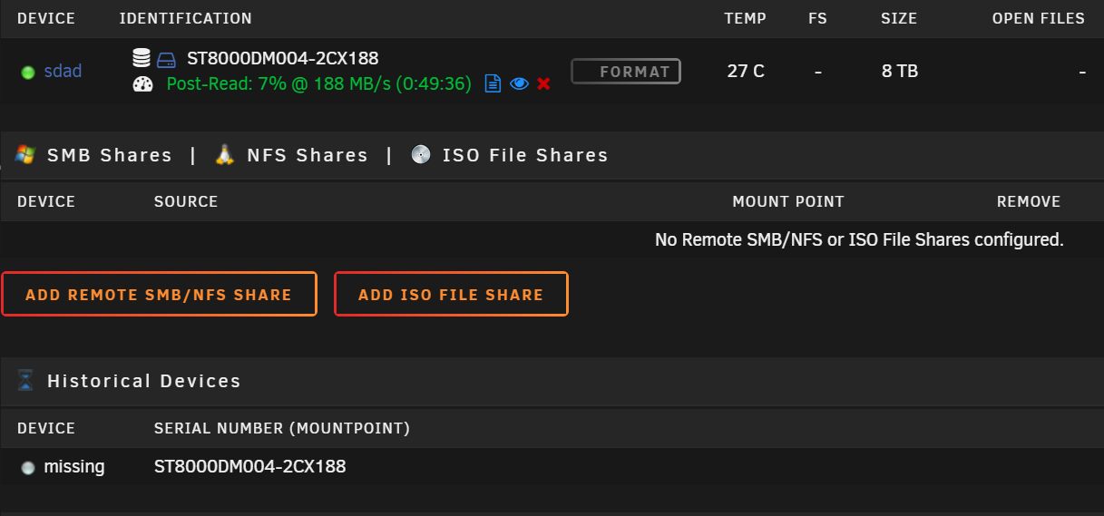

Quick Update: Both of my 14TB replacement disks successfully passed the preclear process. Thank goodness.
If any one is wondering how long it takes UNRAID to preclear a 14TB disk, it is 59 HOURS (Pre-Read/Zeroing/Post-Read). I averaged 197 MB/S and ran both PreClears simultaneously. Interestingly, each step in the 3 step process ended within 1 min of each other. So reading/writing across the entire disk was pretty much the same speed.

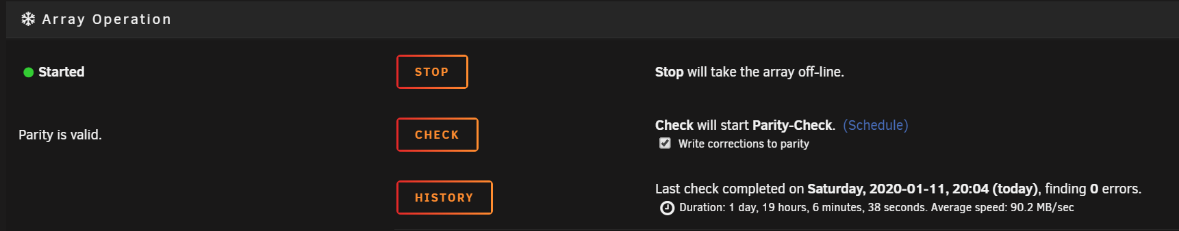

Now I am running automated scripts to audit my entire array disk by disk, and share by share. That way I have a complete record of every single file and their locations prior to starting my rebuilds.

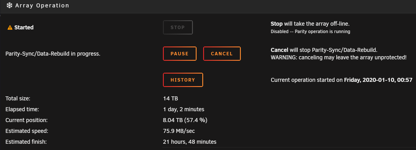

Next Steps: SIMULTANEOUS 14TB DOUBLE DATA DISK REBUILDS. 🙏😬
My scripts finished and I have a full accounting of all files. I just loaded the new 14TB drives into the failed 04/22 slots. I'm about to assign the drives and start the rebuild process.

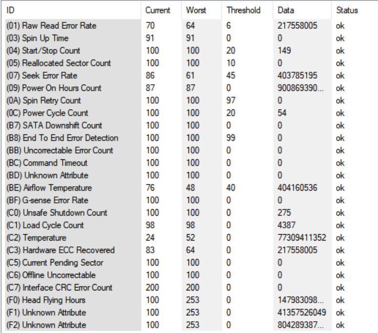

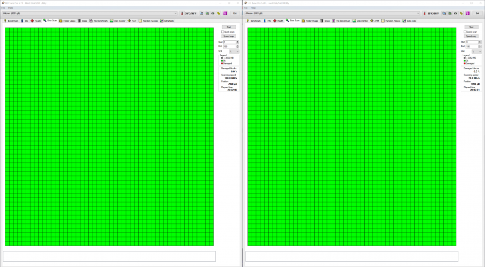

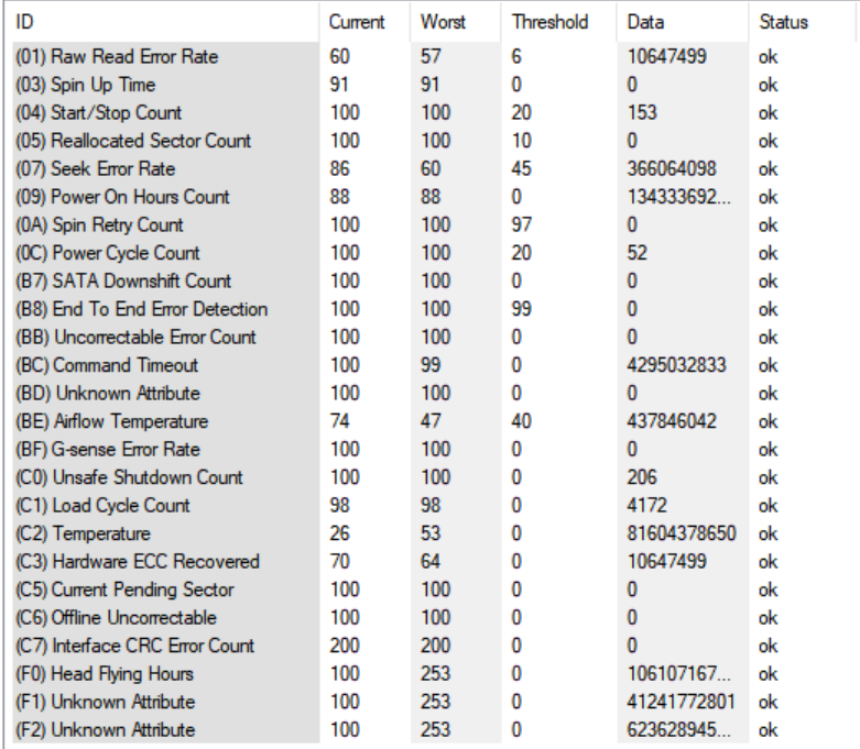

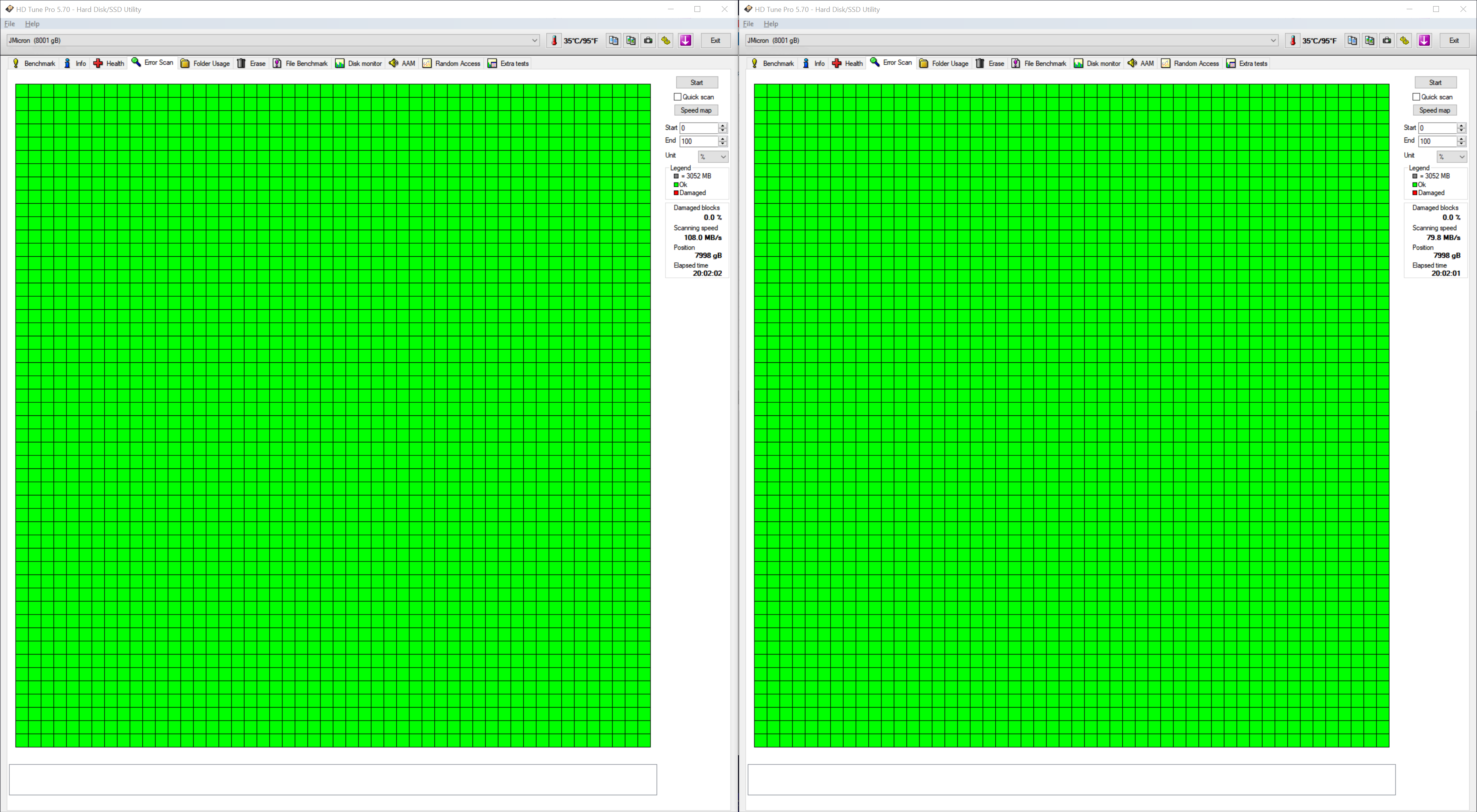

While I have the old 8TB drives out, I just ran an Error Scan (quick) with HD Tune Pro in Windows and every sector came back GREEN. I am now running the FULL test, and in 20 hours or so, I will have a report for both drives. The Smart Reports are below for both drives and they look normal to me. Please Note: The high temps of 52C & 53C on both drives was due to my old NORCO case with craptastic airflow. These were peak temps, not sustained, and were not long term. Since changing over to the 45 Drives Storinator, I've been rock solid in the mid 20s C. Could it be a factor, sure, but I've had no issues with any other drives since switching hardware. Other than those high temps the disks have been solid for me.
DISK 04:
DISK 22:
IF these both come back clean, then I would tend to agree with Johnnie that something else happened and that these drives did not actually fail. Via the UNRAID diagnostics, I can see that both read and write errors occurred on both drives. Very odd.  I'll be scratching my head here if these drives actually come back clean.

Here is the sanitized SYSLOG that shows the issues. I would love to get someone's feedback on the order of events. Is there a smoking gun that indicates what happened here? Aside from the READ/WRITE Errors on both disks 04/22, I see some odd shutdown entries that are concerning (Marked in RED). I also see some odd apcupsd entries that I assume are my UPS (Marked in PUPRLE).
*** BEGIN SANITIZED SYSLOG ***

Jan  4 12:48:58 MassEffect kernel: sd 12:0:10:0: [sdab] tag#1879 ASC=0x4 ASCQ=0x0
Jan  4 12:48:58 MassEffect kernel: sd 12:0:10:0: [sdab] tag#1879 CDB: opcode=0x88 88 00 00 00 00 03 96 dd f4 d8 00 00 04 00 00 00
Jan  4 12:48:58 MassEffect kernel: print_req_error: I/O error, dev sdab, sector 15416030424
Jan  4 12:48:58 MassEffect kernel: md: disk22 read error, sector=15416030360
Jan  4 12:48:58 MassEffect kernel: md: disk22 read error, sector=15416030368
READ ERRORS CONTINUE FOR MANY MORE SECTORS...
Jan  4 12:48:58 MassEffect kernel: md: disk22 read error, sector=15416031360
Jan  4 12:48:58 MassEffect kernel: md: disk22 read error, sector=15416031368
Jan  4 12:48:58 MassEffect kernel: md: disk22 read error, sector=15416031376
Jan  4 12:48:58 MassEffect kernel: sd 12:0:10:0: [sdab] tag#1879 UNKNOWN(0x2003) Result: hostbyte=0x00 driverbyte=0x08
Jan  4 12:48:58 MassEffect kernel: sd 12:0:10:0: [sdab] tag#1879 Sense Key : 0x2 [current]
Jan  4 12:48:58 MassEffect kernel: sd 12:0:10:0: [sdab] tag#1879 CDB: opcode=0x8a 8a 00 00 00 00 03 96 dd d8 d8 00 00 04 00 00 00
Jan  4 12:48:58 MassEffect kernel: print_req_error: I/O error, dev sdab, sector 15416023256
Jan  4 12:48:58 MassEffect kernel: md: disk22 write error, sector=15416023192
Jan  4 12:48:58 MassEffect kernel: md: disk22 write error, sector=15416023200
Jan  4 12:48:58 MassEffect kernel: md: disk22 write error, sector=15416023208
WRITE ERRORS CONTINUE FOR MANY MORE SECTORS...
Jan  4 12:48:58 MassEffect kernel: md: disk22 write error, sector=15416024200
Jan  4 12:48:58 MassEffect kernel: md: disk22 write error, sector=15416024208
Jan  4 12:48:58 MassEffect kernel: sd 12:0:10:0: [sdab] tag#1374 UNKNOWN(0x2003) Result: hostbyte=0x00 driverbyte=0x08
Jan  4 12:48:58 MassEffect kernel: sd 12:0:10:0: [sdab] tag#1374 Sense Key : 0x2 [current]
Jan  4 12:48:58 MassEffect kernel: sd 12:0:10:0: [sdab] tag#1374 ASC=0x4 ASCQ=0x0
Jan  4 12:48:58 MassEffect kernel: sd 12:0:10:0: [sdab] tag#1374 CDB: opcode=0x8a 8a 00 00 00 00 03 96 dd dc d8 00 00 04 00 00 00
Jan  4 12:48:58 MassEffect kernel: print_req_error: I/O error, dev sdab, sector 15416024280
Jan  4 12:48:58 MassEffect kernel: md: disk22 write error, sector=15416024216
Jan  4 12:48:58 MassEffect kernel: md: disk22 write error, sector=15416024224
Jan  4 12:48:59 MassEffect kernel: md: disk22 write error, sector=15416031360
Jan  4 12:48:59 MassEffect kernel: md: disk22 write error, sector=15416031368
Jan  4 12:48:59 MassEffect kernel: md: disk22 write error, sector=15416031376
Jan  4 12:49:22 MassEffect kernel: scsi_io_completion_action: 6 callbacks suppressed
Jan  4 12:49:22 MassEffect kernel: sd 12:0:10:0: [sdab] tag#1432 UNKNOWN(0x2003) Result: hostbyte=0x0b driverbyte=0x00
Jan  4 12:49:22 MassEffect kernel: sd 12:0:10:0: [sdab] tag#1432 CDB: opcode=0x85 85 06 20 00 00 00 00 00 00 00 00 00 00 40 e5 00
Jan  4 12:49:22 MassEffect kernel: mpt3sas_cm1: log_info(0x31110e03): originator(PL), code(0x11), sub_code(0x0e03)
Jan  4 12:49:26 MassEffect kernel: sd 12:0:10:0: [sdab] tag#1432 UNKNOWN(0x2003) Result: hostbyte=0x0b driverbyte=0x00
Jan  4 12:49:26 MassEffect kernel: sd 12:0:10:0: [sdab] tag#1432 CDB: opcode=0x85 85 06 20 00 00 00 00 00 00 00 00 00 00 40 98 00
Jan  4 12:49:26 MassEffect kernel: mpt3sas_cm1: log_info(0x31110e03): originator(PL), code(0x11), sub_code(0x0e03)
Jan  4 12:49:26 MassEffect kernel: mdcmd (456): set md_write_method 0
Jan  4 12:49:33 MassEffect kernel: sd 12:0:10:0: device_block, handle(0x0023)
Jan  4 12:49:44 MassEffect kernel: sd 12:0:10:0: device_unblock and setting to running, handle(0x0023)
Jan  4 12:49:44 MassEffect kernel: sd 12:0:10:0: [sdab] Synchronizing SCSI cache
Jan  4 12:49:44 MassEffect kernel: sd 12:0:10:0: [sdab] Synchronize Cache(10) failed: Result: hostbyte=0x01 driverbyte=0x00
Jan  4 12:49:44 MassEffect kernel: mpt3sas_cm1: removing handle(0x0023), sas_addr(0x300062b203fe85d2)
Jan  4 12:49:44 MassEffect kernel: mpt3sas_cm1: enclosure logical id(0x500062b203fe85c0), slot(8)
Jan  4 12:49:44 MassEffect kernel: mpt3sas_cm1: enclosure level(0x0000), connector name(     )
Jan  4 12:49:44 MassEffect rc.diskinfo[16863]: SIGHUP received, forcing refresh of disks info.
Jan  4 12:49:44 MassEffect rc.diskinfo[16863]: SIGHUP ignored - already refreshing disk info.
Jan  4 12:49:45 MassEffect kernel: scsi 12:0:12:0: Direct-Access     ATA      ST8000DM004-2CX1 0001 PQ: 0 ANSI: 6
Jan  4 12:49:45 MassEffect kernel: scsi 12:0:12:0: SATA: handle(0x0023), sas_addr(0x300062b203fe85d2), phy(18), device_name(0x0000000000000000)
Jan  4 12:49:45 MassEffect kernel: scsi 12:0:12:0: enclosure logical id (0x500062b203fe85c0), slot(8)
Jan  4 12:49:45 MassEffect kernel: scsi 12:0:12:0: enclosure level(0x0000), connector name(     )
Jan  4 12:49:45 MassEffect kernel: scsi 12:0:12:0: atapi(n), ncq(y), asyn_notify(n), smart(y), fua(y), sw_preserve(y)
Jan  4 12:49:45 MassEffect kernel: sd 12:0:12:0: Power-on or device reset occurred
Jan  4 12:49:45 MassEffect kernel: sd 12:0:12:0: Attached scsi generic sg27 type 0
Jan  4 12:49:45 MassEffect kernel: sd 12:0:12:0: [sdad] 15628053168 512-byte logical blocks: (8.00 TB/7.28 TiB)
Jan  4 12:49:45 MassEffect kernel: sd 12:0:12:0: [sdad] 4096-byte physical blocks
Jan  4 12:49:45 MassEffect kernel: sd 12:0:12:0: [sdad] Write Protect is off
Jan  4 12:49:45 MassEffect kernel: sd 12:0:12:0: [sdad] Mode Sense: 9b 00 10 08
Jan  4 12:49:45 MassEffect kernel: sd 12:0:12:0: [sdad] Write cache: enabled, read cache: enabled, supports DPO and FUA
Jan  4 12:49:45 MassEffect kernel: sdad: sdad1
Jan  4 12:49:45 MassEffect kernel: sd 12:0:12:0: [sdad] Attached SCSI disk
Jan  4 12:49:46 MassEffect unassigned.devices: Disk with serial 'ST8000DM004-2CX188_***DISK22', mountpoint 'ST8000DM004-2CX188_***DISK22' is not set to auto mount and will not be mounted.
Jan  4 12:49:46 MassEffect rc.diskinfo[16863]: SIGHUP received, forcing refresh of disks info.
Jan  5 00:00:01 MassEffect crond[3203]: exit status 126 from user root /boot/config/plugins/dynamix.file.integrity/integrity-check.sh &> /dev/null
Jan  5 00:01:45 MassEffect apcupsd[6330]: apcupsd exiting, signal 15
Jan  5 00:01:45 MassEffect apcupsd[6330]: apcupsd shutdown succeeded
Jan  5 00:01:48 MassEffect apcupsd[17915]: apcupsd 3.14.14 (31 May 2016) slackware startup succeeded
Jan  5 00:01:48 MassEffect apcupsd[17915]: NIS server startup succeeded
Jan  5 03:00:10 MassEffect Recycle Bin: Scheduled: Files older than 30 days have been removed
Jan  5 03:00:21 MassEffect kernel: sd 5:0:7:0: [sdj] tag#4264 UNKNOWN(0x2003) Result: hostbyte=0x00 driverbyte=0x08
Jan  5 03:00:21 MassEffect kernel: sd 5:0:7:0: [sdj] tag#4264 Sense Key : 0x5 [current]
Jan  5 03:00:21 MassEffect kernel: sd 5:0:7:0: [sdj] tag#4264 ASC=0x24 ASCQ=0x0
Jan  5 03:00:21 MassEffect kernel: sd 5:0:7:0: [sdj] tag#4264 CDB: opcode=0x35 35 00 00 00 00 00 00 00 00 00
Jan  5 03:00:21 MassEffect kernel: print_req_error: 6 callbacks suppressed
Jan  5 03:00:21 MassEffect kernel: print_req_error: critical target error, dev sdj, sector 0
Jan  5 03:00:21 MassEffect kernel: mpt3sas_cm0: log_info(0x31110630): originator(PL), code(0x11), sub_code(0x0630)
Jan  5 03:00:22 MassEffect kernel: sd 5:0:7:0: [sdj] tag#4955 UNKNOWN(0x2003) Result: hostbyte=0x00 driverbyte=0x08
Jan  5 03:00:22 MassEffect kernel: sd 5:0:7:0: [sdj] tag#4955 Sense Key : 0x4 [current]
Jan  5 03:00:22 MassEffect kernel: sd 5:0:7:0: [sdj] tag#4955 ASC=0x44 ASCQ=0x0
Jan  5 03:00:22 MassEffect kernel: sd 5:0:7:0: [sdj] tag#4955 CDB: opcode=0x8a 8a 08 00 00 00 00 ae d2 e0 f8 00 00 00 08 00 00
Jan  5 03:00:22 MassEffect kernel: print_req_error: critical target error, dev sdj, sector 2933055736
Jan  5 03:00:22 MassEffect kernel: md: disk4 write error, sector=2933055672
Jan  5 03:00:22 MassEffect kernel: md: recovery thread: exit status: -4
Jan  5 03:00:22 MassEffect kernel: sd 5:0:7:0: [sdj] tag#4956 UNKNOWN(0x2003) Result: hostbyte=0x00 driverbyte=0x08
Jan  5 03:00:22 MassEffect kernel: sd 5:0:7:0: [sdj] tag#4956 Sense Key : 0x4 [current]
Jan  5 03:00:22 MassEffect kernel: sd 5:0:7:0: [sdj] tag#4956 ASC=0x44 ASCQ=0x0
Jan  5 03:00:22 MassEffect kernel: sd 5:0:7:0: [sdj] tag#4956 CDB: opcode=0x8a 8a 08 00 00 00 00 ae d2 e0 f0 00 00 00 08 00 00
Jan  5 03:00:22 MassEffect kernel: print_req_error: critical target error, dev sdj, sector 2933055728
Jan  5 03:00:22 MassEffect kernel: md: disk4 write error, sector=2933055664
Jan  5 03:00:22 MassEffect kernel: sd 5:0:7:0: [sdj] tag#4956 CDB: opcode=0x8a 8a 08 00 00 00 00 ae d2 e1 00 00 00 00 08 00 00
Jan  5 03:00:22 MassEffect kernel: print_req_error: critical target error, dev sdj, sector 2933055744
Jan  5 03:00:22 MassEffect kernel: md: disk4 write error, sector=2933055680
Jan  5 06:36:40 MassEffect apcupsd[17915]: UPS Self Test switch to battery.
Jan  5 06:36:48 MassEffect apcupsd[17915]: UPS Self Test completed: Battery OK
Jan  6 08:00:02 MassEffect root: Fix Common Problems Version 2019.12.29
Jan  6 08:00:03 MassEffect root: Fix Common Problems: Error: disk4 (ST8000DM004-2CX188_***DISK22) is disabled
Jan  6 08:00:03 MassEffect root: Fix Common Problems: Error: disk22 (ST8000DM004-2CX188_***DISK04) is disabled
Jan  6 08:00:03 MassEffect root: Fix Common Problems: Error: disk4 (ST8000DM004-2CX188_***DISK22) has read errors
Jan  6 08:00:03 MassEffect root: Fix Common Problems: Error: disk22 (ST8000DM004-2CX188_***DISK04) has read errors
*** END SANITIZED SYSLOG ***

No, it had been 88 days since my last parity check. I don't schedule them due to the amount of dockers and services running. I manually stop everything first, then perform the parity check, then start everything back up. We've been so busy lately that it was hard to find a good time. At some point you just have to do it. I'll be going back to monthly for sure after this event.
Again though, everything is backed up on and offsite, but finding corrupted files (if any) is going to be a pain in the butt. I may not notice them for years. Luckily we have version history on our BACKBLAZE account and I run yearly snapshots to cold storage backups.
You need to see what caused that, the only number of acceptable sync errors is 0, a few sync errors are normal after an unclean shutdown, but that's about the only situation were a few errors are normal.
Agreed. And I'm seriously stumped. Brand new hardware. Many brand new disks. This is only the 4th time since 2016 on this FLASH between 2 hardware configs that I have had any parity check errors > 0. And never anything over 3. But this last one had 2,654 before it crapped out and the disks failed/shutdown.
Here is the full history:
Date Duration Speed Status Errors
2020-01-05, 03:00:22 1 day, 14 hr, 11 min, 58 sec Unavailable Canceled 2654
2019-10-13, 10:12:101 day, 6 hr, 41 min, 40 sec126.7 MB/sOK0
2019-09-23, 09:30:281 day, 11 hr, 18 min, 15 sec110.2 MB/sOK0
2019-09-21, 10:21:1020 hr, 24 min, 12 sec190.6 MB/sOK0
2019-08-31, 17:43:251 day, 2 hr, 23 min, 18 sec147.4 MB/sOK0
2019-08-30, 08:09:201 day, 8 hr, 26 min, 8 sec119.9 MB/sOK0
2019-08-28, 22:15:261 day, 6 hr, 42 min, 2 sec126.7 MB/sOK0
2019-08-23, 13:26:1121 hr, 29 min, 15 sec103.4 MB/sOK0
2019-08-22, 08:39:2019 hr, 34 min, 19 sec113.6 MB/sOK0
2019-07-31, 06:45:2019 hr, 13 min, 37 sec115.6 MB/sOK0
2019-07-30, 07:01:2519 hr, 27 min, 21 sec114.2 MB/sOK0
2019-07-27, 21:31:5219 hr, 10 min, 29 sec115.9 MB/sOK0
2019-05-10, 22:52:2219 hr, 22 min, 23 sec114.7 MB/sOK0
2019-05-09, 21:53:04 19 hr, 26 min, 55 sec 114.3 MB/s OK 3
2019-02-28, 22:10:1919 hr, 22 min, 15 sec114.7 MB/sOK0
2019-01-08, 21:01:3420 hr, 54 min, 16 sec106.3 MB/sOK0
2018-11-22, 17:09:55 20 hr, 43 min, 11 sec 107.3 MB/s OK 1
2018-09-15, 19:04:451 day, 7 hr, 21 min, 2 sec70.9 MB/sOK0
2018-09-09, 14:13:0419 hr, 51 min, 6 sec112.0 MB/sOK0
2018-09-08, 16:00:0721 hr, 59 min, 57 sec101.0 MB/sOK0
2018-09-07, 16:02:5822 hr, 6 min, 22 sec100.5 MB/sOK0
2018-09-06, 17:33:5122 hr, 10 min, 51 sec100.2 MB/sOK0
2018-09-05, 16:13:5122 hr, 44 min, 32 sec97.7 MB/sOK0
2018-09-04, 15:53:0722 hr, 14 min, 11 sec100.0 MB/sOK0
2018-09-03, 12:46:18 1 day, 1 hr, 46 min, 33 sec 86.2 MB/s OK 3
2018-08-14, 11:47:0623 hr, 25 min, 50 sec94.9 MB/sOK0
2018-08-10, 18:06:5123 hr, 23 min, 44 sec95.0 MB/sOK0
2018-08-06, 04:42:3723 hr, 31 min, 38 sec94.5 MB/sOK0
2018-08-05, 02:38:441 day, 1 hr, 42 min, 10 sec86.5 MB/sOK0
2018-08-03, 20:48:5122 hr, 47 min, 1 sec97.6 MB/sOK0
2018-08-02, 17:49:3823 hr, 12 min, 43 sec95.8 MB/sOK0
2018-08-01, 17:50:5121 hr, 48 min, 51 sec101.9 MB/sOK0
2018-06-19, 02:40:3722 hr, 57 min, 3 sec96.8 MB/sOK0
2018-03-13, 19:24:151 day, 2 hr, 22 min, 50 sec84.3 MB/sOK0
2018-03-10, 08:36:098 hr, 16 min, 9 sec268.8 MB/sOK0
2017-12-02, 04:15:462 day, 4 hr, 15 min, 45 sec42.5 MB/sOK0
2017-11-07, 10:22:3323 hr, 12 min, 47 sec95.8 MB/sOK0
2017-11-05, 23:27:331 day, 10 hr, 13 min, 23 sec64.9 MB/sOK0
2017-11-01, 22:45:201 day, 22 hr, 45 min, 19 sec47.5 MB/sOK0
2017-10-01, 17:32:511 day, 17 hr, 32 min, 50 sec53.5 MB/sOK0
2017-08-31, 13:30:3923 hr, 42 min, 56 sec93.7 MB/sOK0
2017-08-14, 14:19:401 day, 57 min, 41 sec89.0 MB/sOK0
2017-07-29, 07:43:431 day, 4 hr, 14 min, 59 sec78.7 MB/sOK0
2017-07-27, 19:00:2019 hr, 18 min, 28 sec115.1 MB/sOK0
2017-07-21, 03:20:471 day, 5 hr, 37 min, 57 sec75.0 MB/sOK0
2017-07-17, 15:41:0818 hr, 58 min, 40 sec117.1 MB/sOK0
2017-07-16, 10:30:2922 hr, 58 min, 2 sec96.8 MB/sOK0
2017-07-15, 10:47:1122 hr, 31 min, 3 sec98.7 MB/sOK0
2017-07-14, 06:18:2215 hr, 30 min, 30 sec107.5 MB/sOK0
2017-06-30, 18:32:5018 hr, 32 min, 49 sec89.9 MB/sOK0
2017-05-31, 17:28:5217 hr, 28 min, 51 sec95.4 MB/sOK0
2017-05-26, 16:22:1317 hr, 39 min, 16 sec94.4 MB/sOK0
2017-03-27, 17:02:2117 hr, 2 min, 20 sec97.8 MB/sOK0

Double Data Rebuild Status:
Made it past 50% with no issues thus far.
Edited by falconexe
Also my HD Tune Pro Full Error Scans successfully completed on both of the "failed" data drives. 100% Healthy. Once the rebuilds finish on the new drives, I'm going to drop these back into the array and run preclears. If they pass, I get back 16TB. Or if I look at it the other way, I gained 28TB unnecessarily ha ha.

So as you know, I've been preclearing the previously "failed" data disks 04/22.
Both passed HD Tune Pro Full Error scans. So I threw them back into the server and have been running Preclears on them.
Both disks passed the PreRead Process.
Both disks passed the Zeroing Process.
However, immediately after the Zeroing finished on the old Disk 22 with ID "sdae" (the one that threw 2,000+ errors during the parity check), the preclear process failed and the disk literally disappeared from my array. It is nowhere to be found in the GUI. The error I received "Invalid unRAID's MBR signature" is below in RED (SNs have been Sanitized). The old Disk 4 with ID "sdad" (the one that thew only 3 errors during the parity check) is still going with the post-read process.
Furthermore, something odd happened with the "sdad" disk where is now showing up as missing under Historical Devices? However, it is not missing and is shown in the preclear area above. (Perhaps it was always there and I forgot?)
I am now thinking that the old disk 22 "sdae" is REALLY Messed Up For Some Reason. No issues with SMART, but something is going on.
Can anyone tell me what that error means and what you think is going on with this Disk that disappeared? Also this disk is in a totally different slot than before (was 22, now is 27). So I am really thinking it is NOT my UNRAID Hardware and actually the disk itself.
It appears to have powered down again after it failed the post-read. The log is below:
