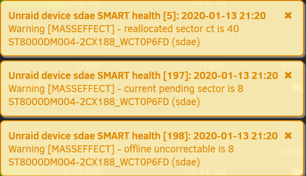

This was the Old Disk 22 that ended a parity check in 2,000+ errors, passed a HD Tune Pro Full Error Scan, but Failed an UNRAID Preclear during the post-read process. So, it was having some major issues after-all. Can't understand why the SMART report was coming back clean until after this last reboot. For the last 6 years, EVERY SINGLE TIME, a disk would fail, I would see a failed SMART report first indicating pending sectors or reallocated, etc..
This drive was ghosting SMART health during 2 full health checks inside Windows and in UNRAID. I'm sure the disk power issues have a correlation as well.
Anywho, this drive is TRASH and I'll be executing a 35 pass wipe with some "other" tools ha ha. We'll see if it can handle that type of onslaught. Then I will physically destroy the drive with a drill press for good measure.

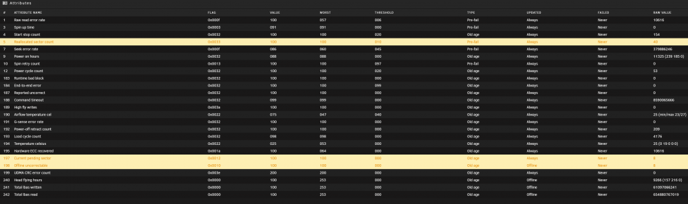

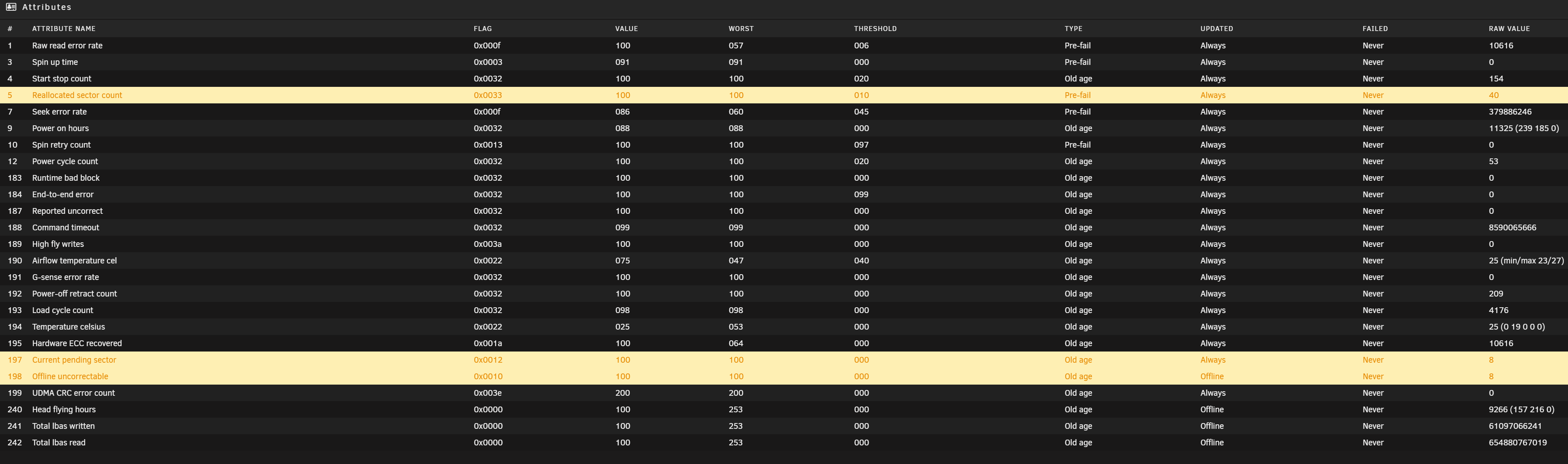

So the Old Disk 4 "sdad" (3 parity errors) that just passed the preclear process and is ready to be added back to the array. However, I was checking the SMART reports, and everything looks perfect except this bit under Error History. Should I be worried about any of this?
Edited by falconexe
Typos
Those errors are usually not a disk problem, I wouldn't worry for now.
Ok thanks so much for getting back to me. I'll proceed with formatting the drive in XFS and remounting.

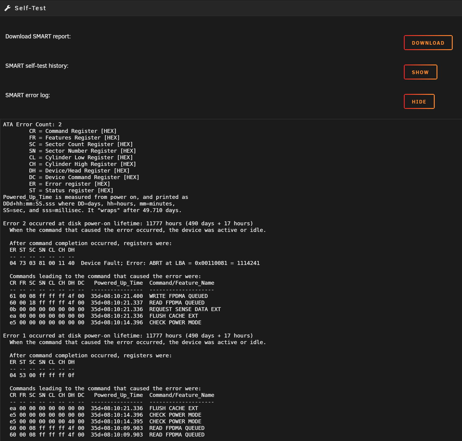

On 1/13/2020 at 7:49 PM, falconexe said:
Can anyone tell me what that error means and what you think is going on with this Disk that disappeared? Also this disk is in a totally different slot than before (was 22, now is 27). So I am really thinking it is NOT my UNRAID Hardware and actually the disk itself.
It appears to have powered down again after it failed the post-read. The log is below:
The 45Drives enclosure really a good case, but I doubt a single power supply can fullfill the 5v power requirement for 30 HDD and System? Does cables ( data/power ) have several connect point instead a single end to end.
An easy way to check this was use a multimeter ( with Min / Max recording ) to check the 5v at the most far end-point, just load all HDDs and check the min reading.
Could you provide the spec. of the power supply ?
If problem on disk itself ( may be ), why it can success preclear without problem > 50s hrs, so I prefer believe problem not on disk.

Also, that drive failed another round of HD Tune Pro Error Checks showing extreme DAMAGE to sectors all over the place. Lit up RED blocks all over like a Christmas tree. It's toast.
I am eviscerating it with a 35 Pass Gutmann wipe as we speak just to take out some aggression. 😒 Well worth the electricity...
I doubt any of the passes will actually finish with so many issues, but at least it makes me feel better. 😂
