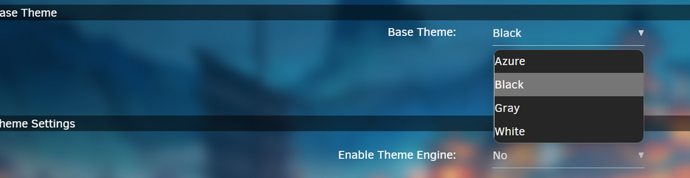

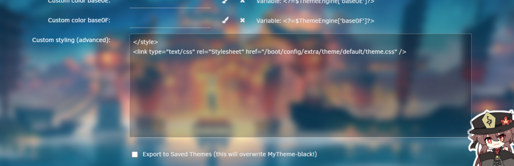

Seen the question asked a few times on how to get a custom image/photo as a background but no hints so far - assume it's a case of using your own css file and putting in the background-image setting?
  • Replies 247
  • Views 115k
  • In the works
  • Replacement now published No it doesn't Replacement Theme Engine is now within Apps. Uninstall the original from the plugins tab and reinstall the new one from Apps Note that this plugin will be 1
  • THANK YOU FOR THIS PLUGIN.   Allowed to make it look like something not from 20 years ago
okay - got it now - I followed these instructions and just uploaded my own image to the folder it created and changed the theme.css https://github.com/XiaoNieGPT/unraid-theme
