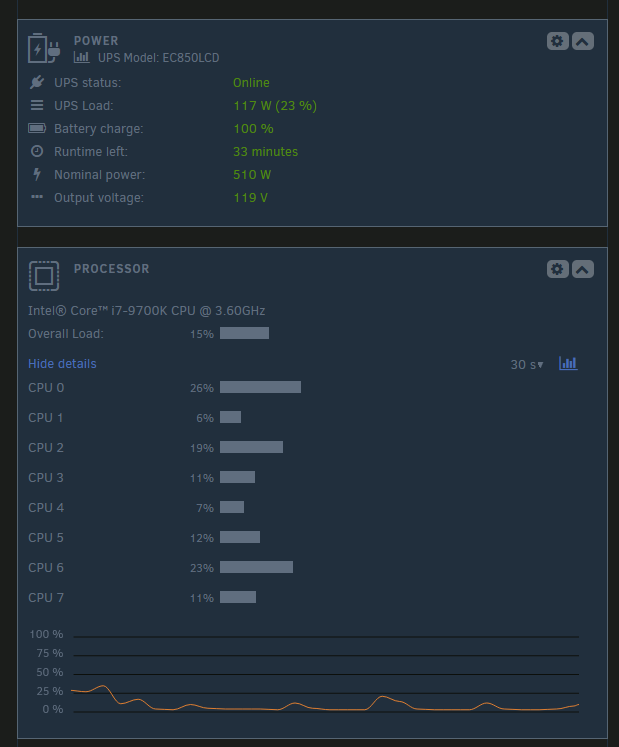

Amazing Odón. I'm using it now with a tiny bit of my own coloring.
Question: do you happen to know how to change the color of the red elements such as the stopped icon?
I tried changing the one called "Red Text (failed)" but that doesn't seem to affect anything.
And also the rollup/setting buttons?
It's these ones:

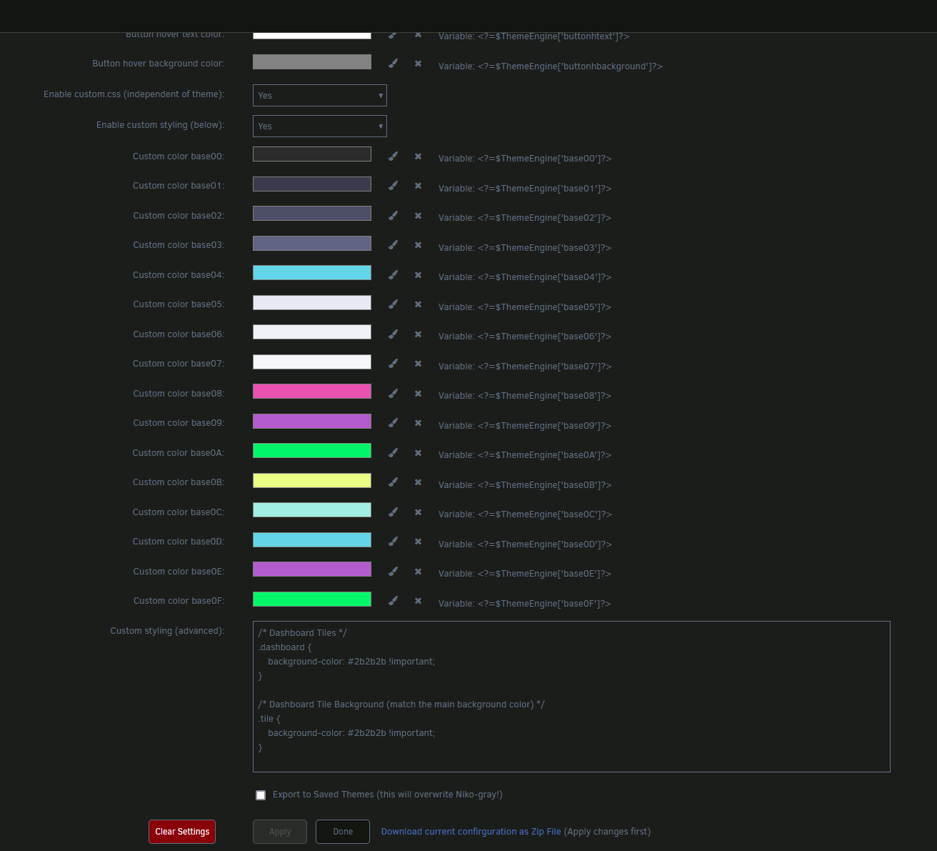

Hi friend,
You have the option to put the following at the end of your custom CSS code from the Theme Engine Plugin:
.red-text {
color: var(--base07) !important;;
That --base07 corresponds to some of the colors you have above, if you want your custom color pass the color, for example:
.red-text {
color: #a3be8c !important;;
I hope it helps.

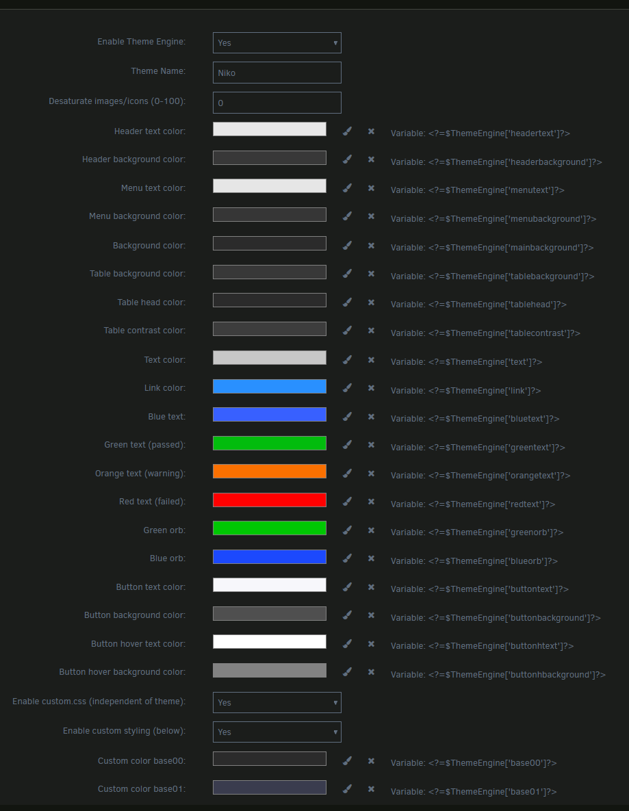

On 2/13/2025 at 11:14 AM, averagejoeshmoe said:
For anyone that wants a simple dark theme that works with the grey style side menu. I made this for 7.0.0. Everything seems to be fixed on the dashboard. Still needs some work on the shares and array page to get it to where i would like but its a start. Thanks to the previous commentors for some of their tweaks.

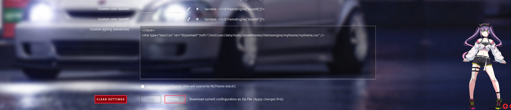

Just updated Unraid Connect and it broke Theme Engine again, simple fix is to uninstall TE after updating UC then install TE again.
Be sure to backup any custom CSS you've put in or alternatively a piece of code to load an external CSS file such as:
</style>
<link type="text/css" rel="Stylesheet" href="/mnt/user/data/tools/unraidthemes/themeengine/mytheme/mytheme.css" />
</style>

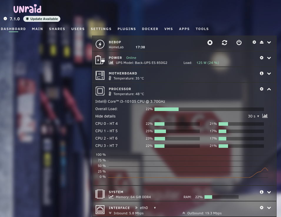

I can confirm that theme engine works with 7.1.0, at least by using the external CSS method I mentioned previously (I don't use the other options).

I don't use any of the options that are available after installing the theme.  I simply scroll to the bottom of the configuration for the plugin and turn on Custom Styling (advanced) and then I copy/paste this in the box for the Aquamarine theme.  You can try that then swap out maybe to the plex.css look.  I'm running 7.1 of Unraid.
table.dashboard {
    background: var(--transparency-dark-15);
    border: 1px solid var(--transparency-light-25);
table.dashboard thead.stopgap {
    display: none;
table.dashboard tr > td.next {
    border-top: 1px solid var(--transparency-light-25);
    color: var(--text-hover);
table.dashboard tbody {
    border: 1px solid var(--transparency-light-15);
</style>
<link type="text/css" rel="Stylesheet" href="https://theme-park.dev/css/base/unraid/aquamarine.css" />

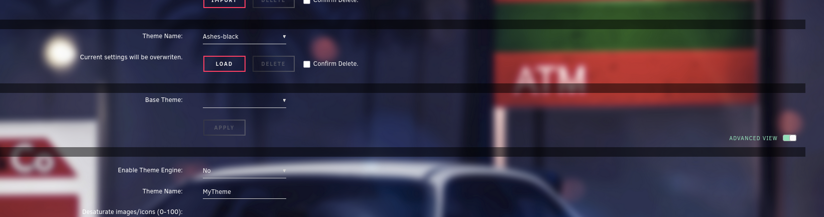

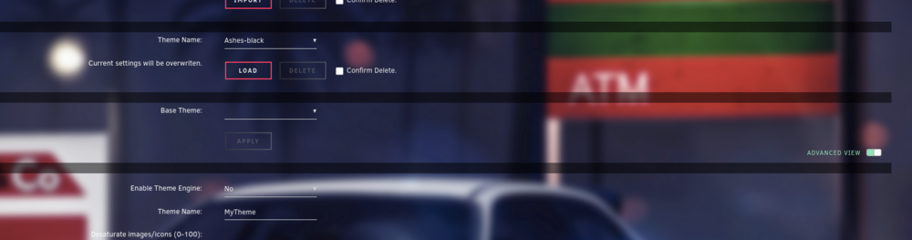

table.dashboard {
    display: none;
</style>
I can't select a base theme but it's defo working for me using the external CSS method.
