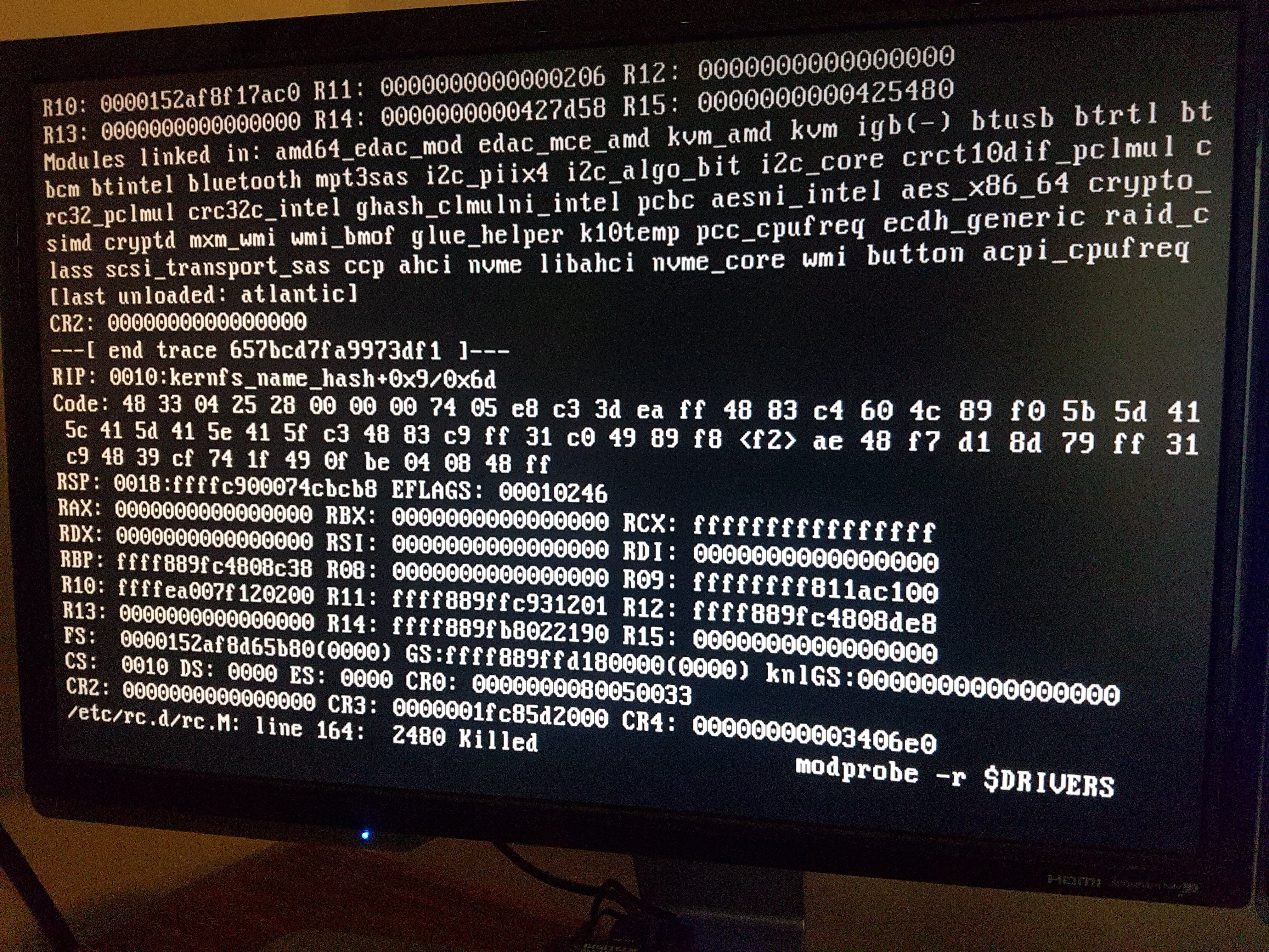

I also have the same issue today immediately after upgrading from 6.8.0 to 6.8.1. The boot process hangs at the modprobe -r $DRIVERS command/step. It looks to be SAS related, but I'm no expert just see that was the step it seemed to be at. I can't even get the system to boot past this to try and roll back.

Boot always dies saying with some sort of dump with last line being
/etc/rc.d/rc.M: line 164: 2363 Killed            modprobe -r $DRIVERS

I also got this same error message after upgrading from 6.8.0 to 6.8.1
Did the rename of network-rules.cfg fix the problem?
The error:
/etc/rc.d/rc.M: line 164: 2426 Killed modprobe -r $DRIVERS

I got the exactly same problem last night, I upgraded to 6.8.1 a few days ago and rebooted last night and got the same error immediately. Tried all safe boot options but no luck. I thought maybe my flash drive went bad, so I created a new 6.8.1 on another usb stick, it booted with no error. So I ordered another new Sandisk usb stick which will be delivered tomorrow morning.
