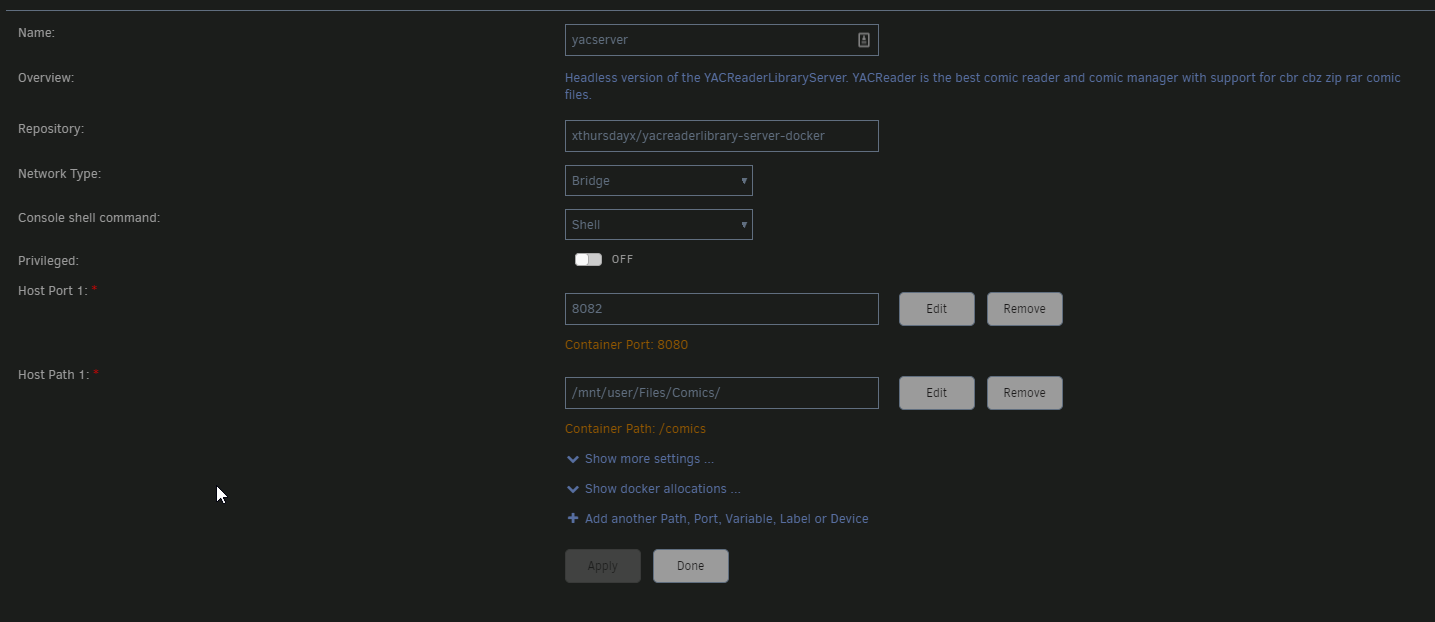

Hello! I've set up yacserver and created the library but when I click on the read link, I just get a text output. Example:
Docker settings:
Any thoughts on what I might have done wrong? Thanks in advance!
~K

Thanks for pointing this out K. You're not actually doing anything wrong. I think that the issue is that web browsers can't display .cbr or .cbz files. I'd never actually tried reading any comics in my browser so I didn't realize this. YACReaderLibraryServer is generally used as a server to host your comics which are then read by the YACReader application, either on your computer, or a tablet or phone. Here is the link to the software page: https://www.yacreader.com/downloads
Once you download YACReader on your computer or tablet you can link it to your instance of YACReaderLibraryServer by either being on the same network and setting it up at the local address (ex. http://<UNRAID_SERVER_IP>:8082 in your case) or you could set up a reverse proxy using something like Linuxserver's SWAG image, though if you do that I'd recommend you add an HTML password to the page because there is no built in authentication with YACReaderLibraryServer.
Hope that helps.
