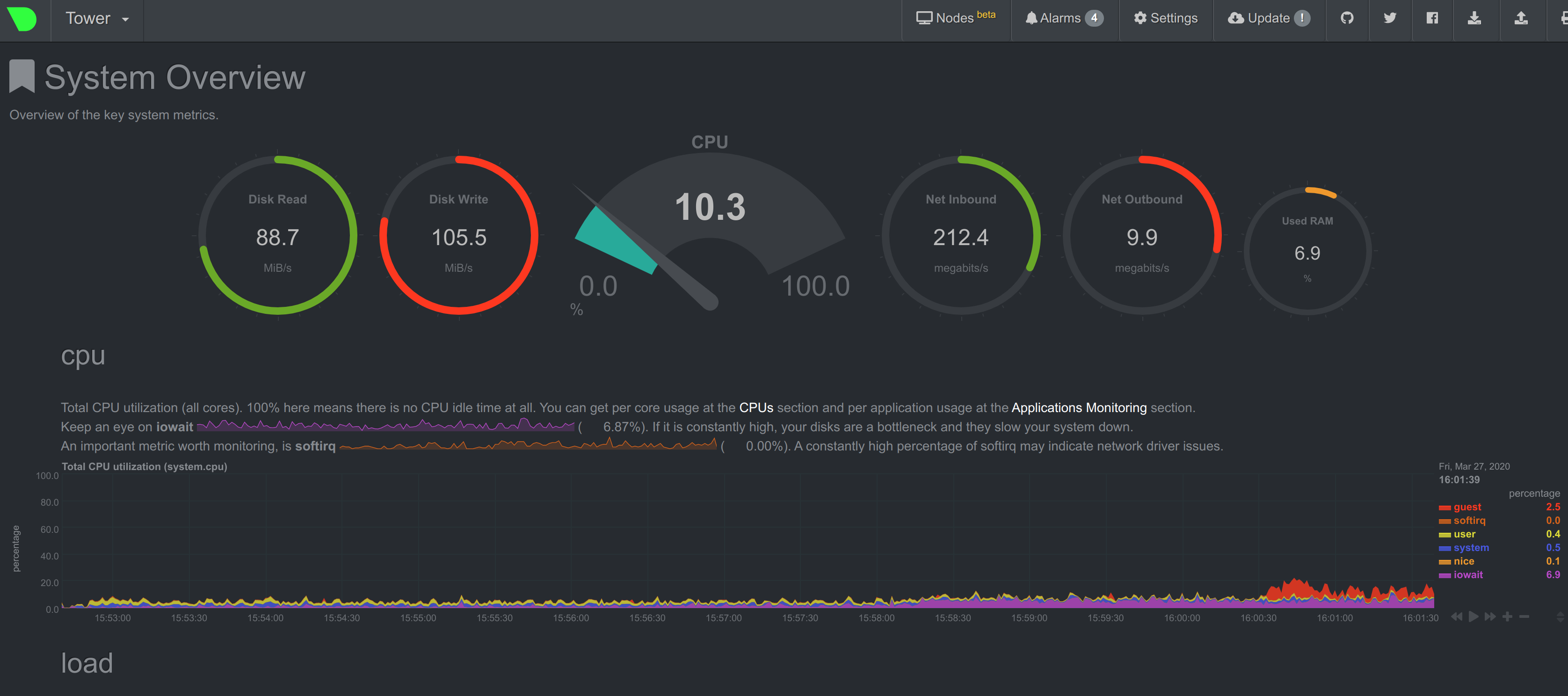

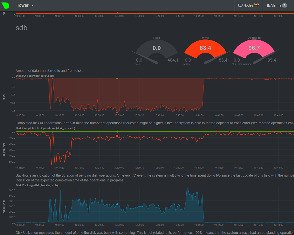

I did move all the sab operations to a dedicated share that is set to only.... it's still giving me high IO wait
Which, this is one of the cache drives...

Is there any further ideas on why I'm still getting the high IO? Latest diag attached.

I've gotten everything back to normal, but still have the high IO situation when downloading with sab
See what happens if you make sab download to a disk in the array.

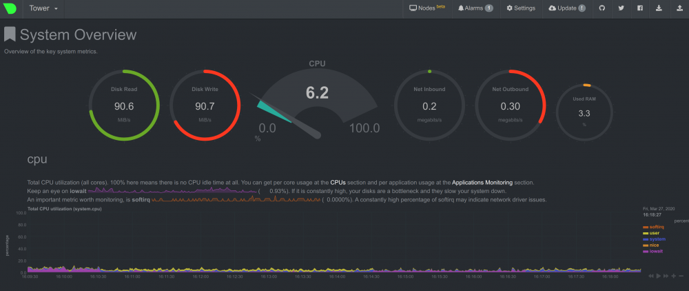

OK, so this is what I did. I created a share "sabtest" that was cache "no" and then copied the file structure of the cache only one "sab" to it....

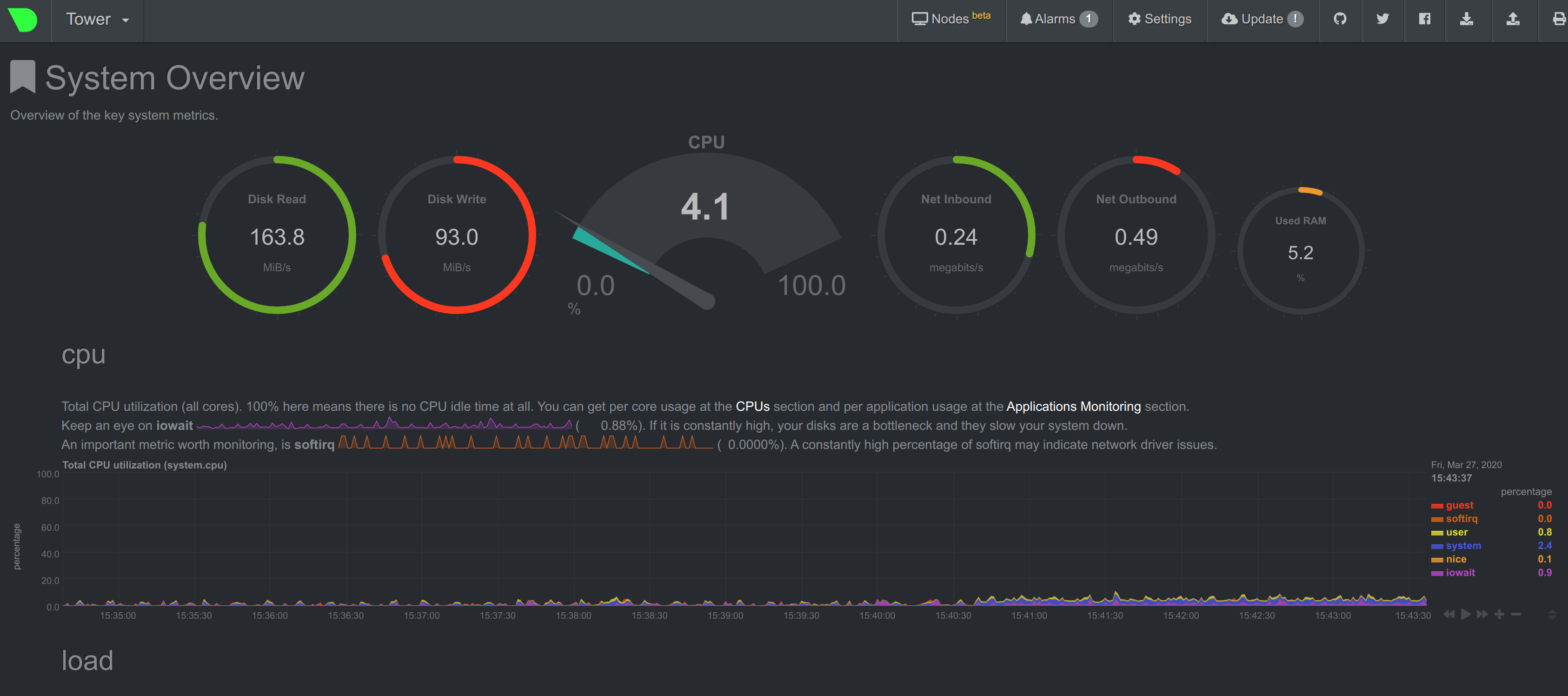

This was the performance during copying from cache to the array:
That was 20G of files, from unfinished downloads.

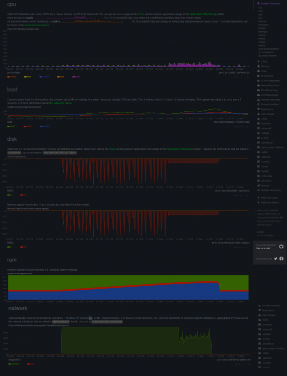

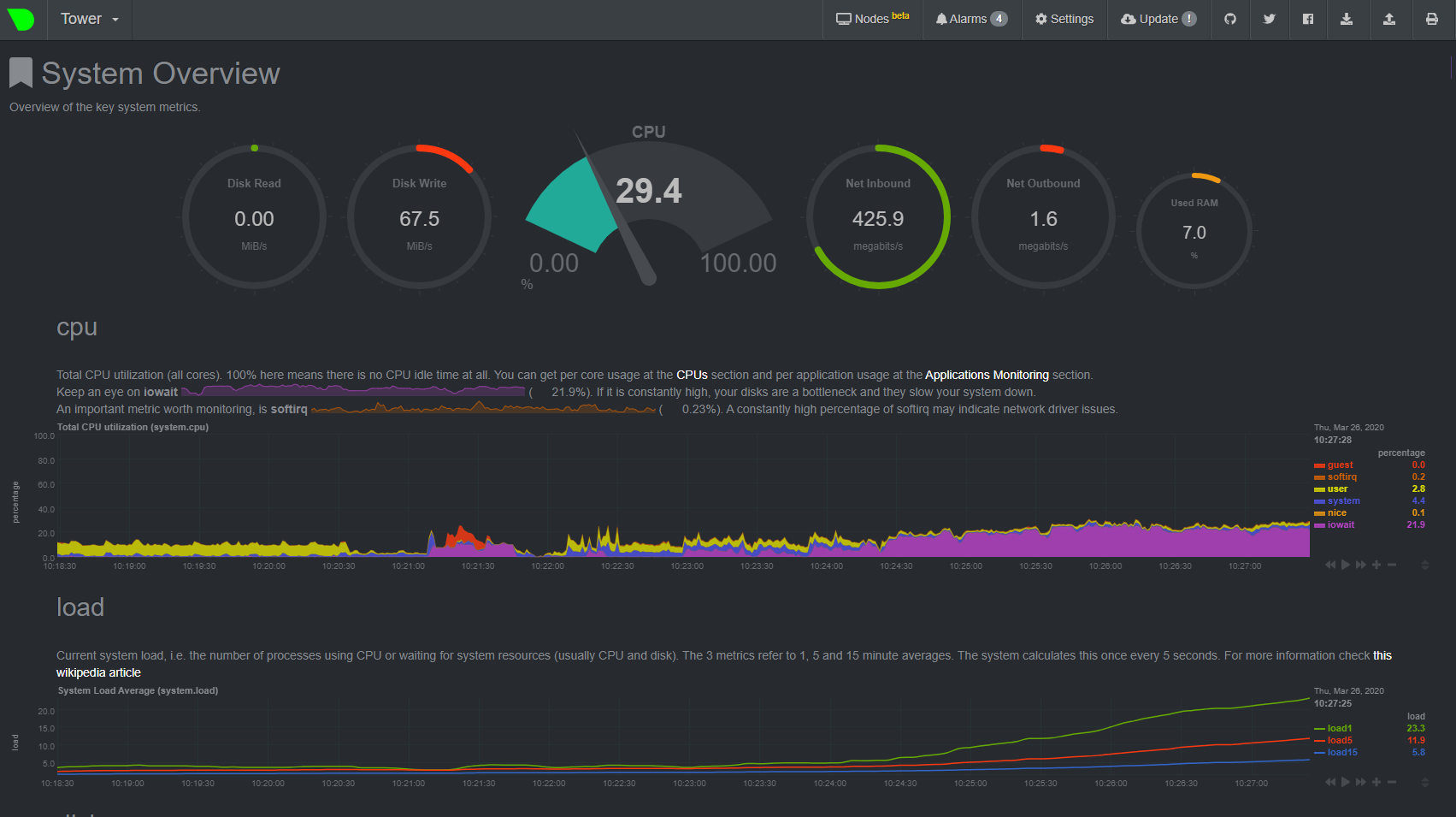

This was performance during sab running to this array only share:
This is during download, and I think notable here is how it's now downloading at about 40% of the previous speed. And while the overall impairment of the system's performance and response of other services wasn't as bad... It's still sluggish.

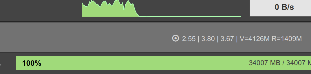

Interestingly enough, after the download has "finished" sab seems to hang up for a few minutes, before unpacking

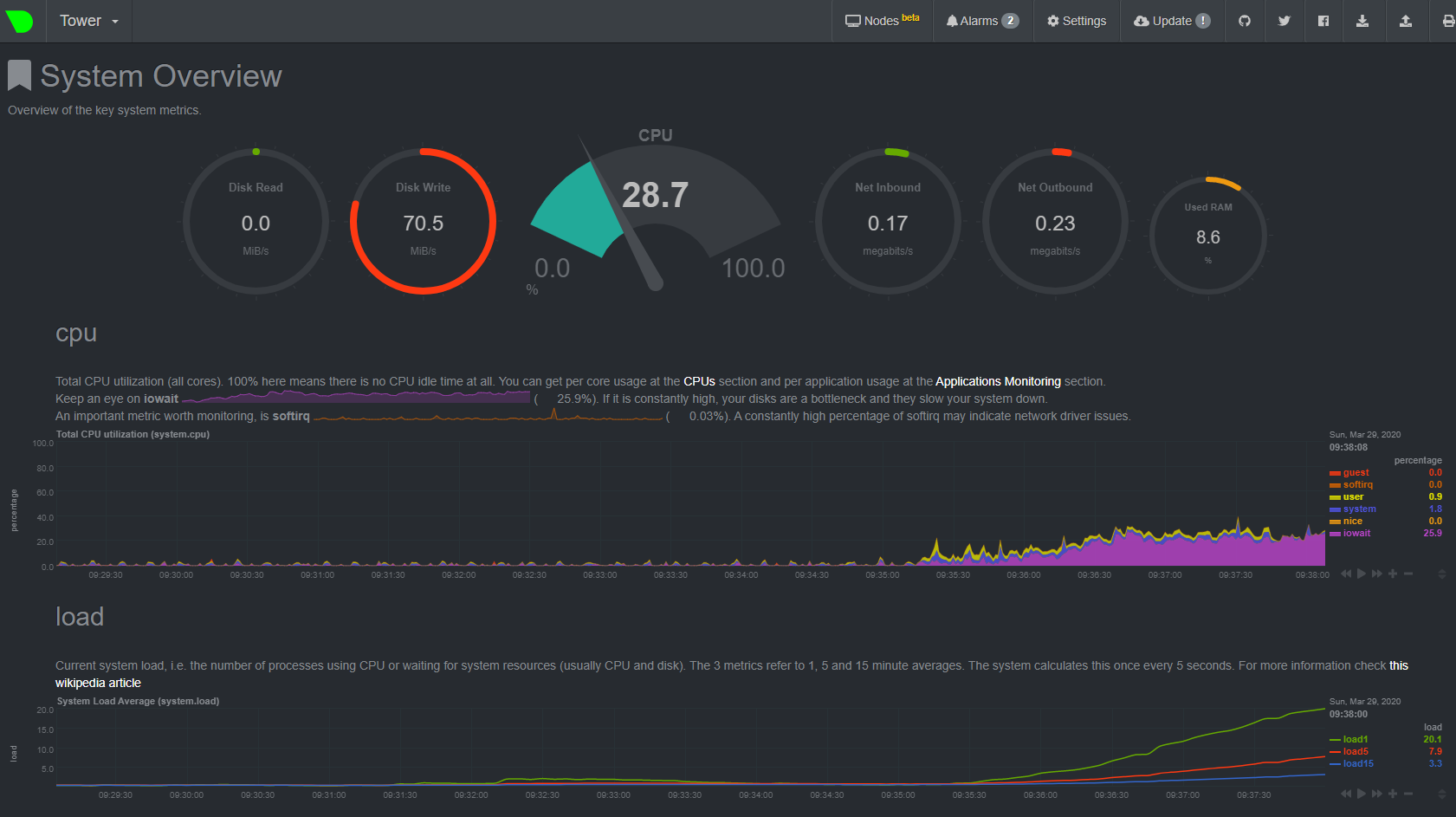

And then this is what it looks like during unpacking:

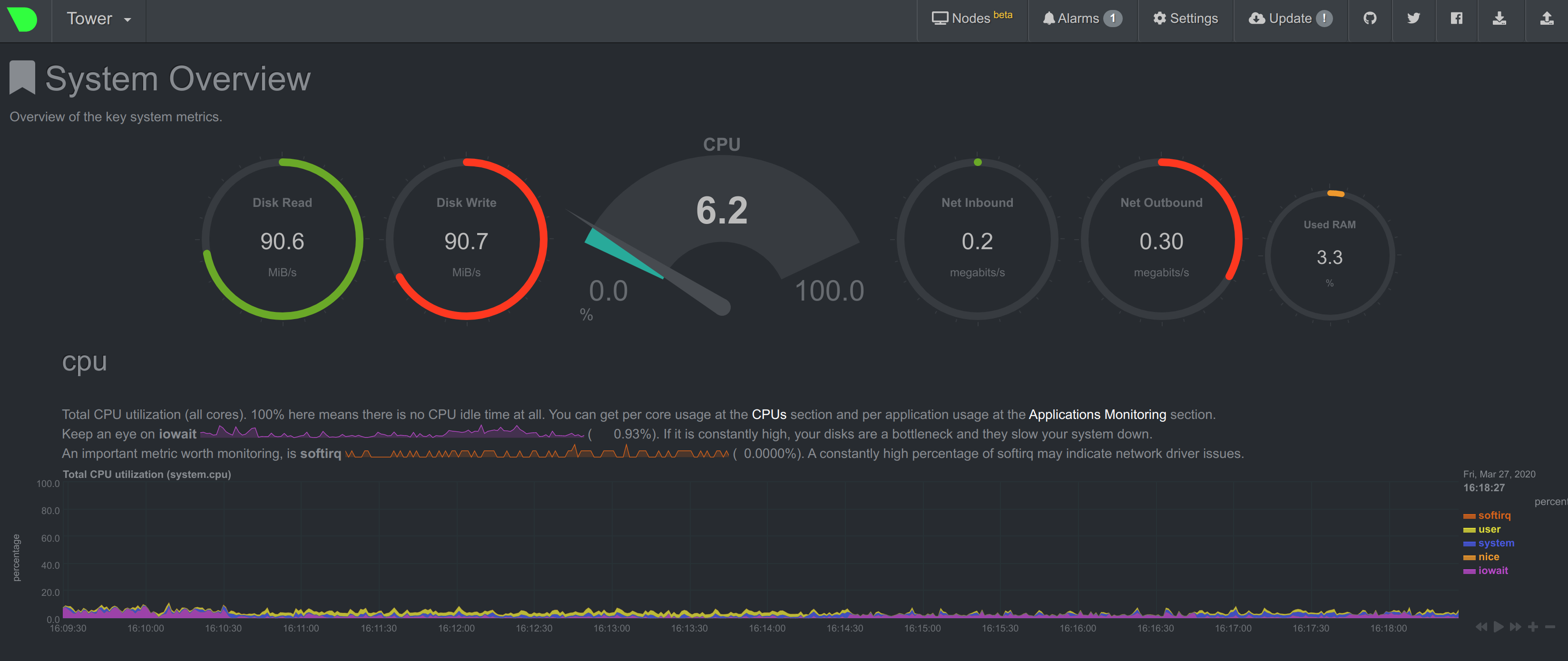

And this is copying from the array only sab test share to my media share, which is cache "yes"
So it's definitely something to do with the cache drives, which are new... and the previous ones did the same. This is not likely to be hardware I'm guessing, so I'm not sure where to look next. Thoughts?

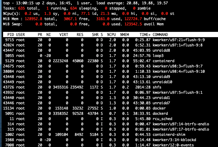

And again. Reformatted the cache disks, put them into a raid0, ran balance, ran fstrim -av etc..
Performance is an abosute disaster when the mover is active. Docker container die, VM's become unusable etc.
This is a serious BUG!

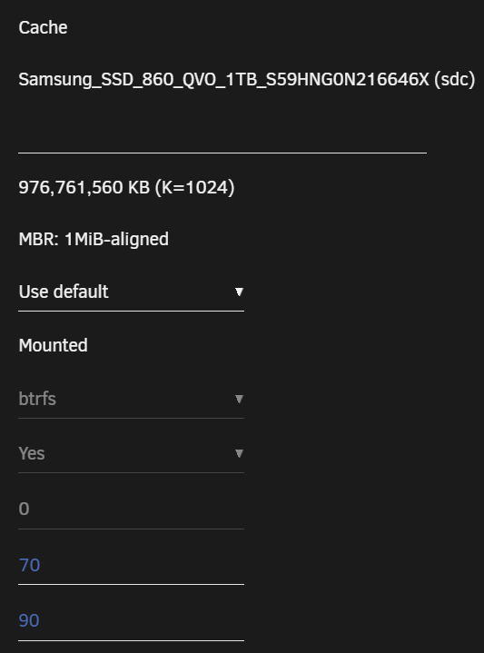

Now i want to find out why and remove this problem. I know my way around strace etc. and the next time i will do a bit more investigation to see what is really going on. However the hints so far from this forum are the partition start for Samsung SSD's which should not start at sector 64 but 2048.
Please post what you find, I use mine as a "one box to do it all" so this is killing me. And it's not normal operation to have this much IO wait, as it hadn't been the case in the past.
I assume the following article is what we're looking at:
https://linux-blog.anracom.com/2018/12/03/linux-ssd-partition-alignment-problems-with-external-usb-to-sata-controllers-i/
This is mine:
root@Tower:~# lsblk -o  NAME,ALIGNMENT,MIN-IO,OPT-IO,PHY-SEC,LOG-SEC  /dev/sdc
NAME   ALIGNMENT MIN-IO OPT-IO PHY-SEC LOG-SEC
sdc            0    512      0     512     512
└─sdc1         0    512      0     512     512
root@Tower:~# lsblk -o  NAME,ALIGNMENT,MIN-IO,OPT-IO,PHY-SEC,LOG-SEC  /dev/sdb
sdb            0    512      0     512     512
└─sdb1         0    512      0     512     512
root@Tower:~#
