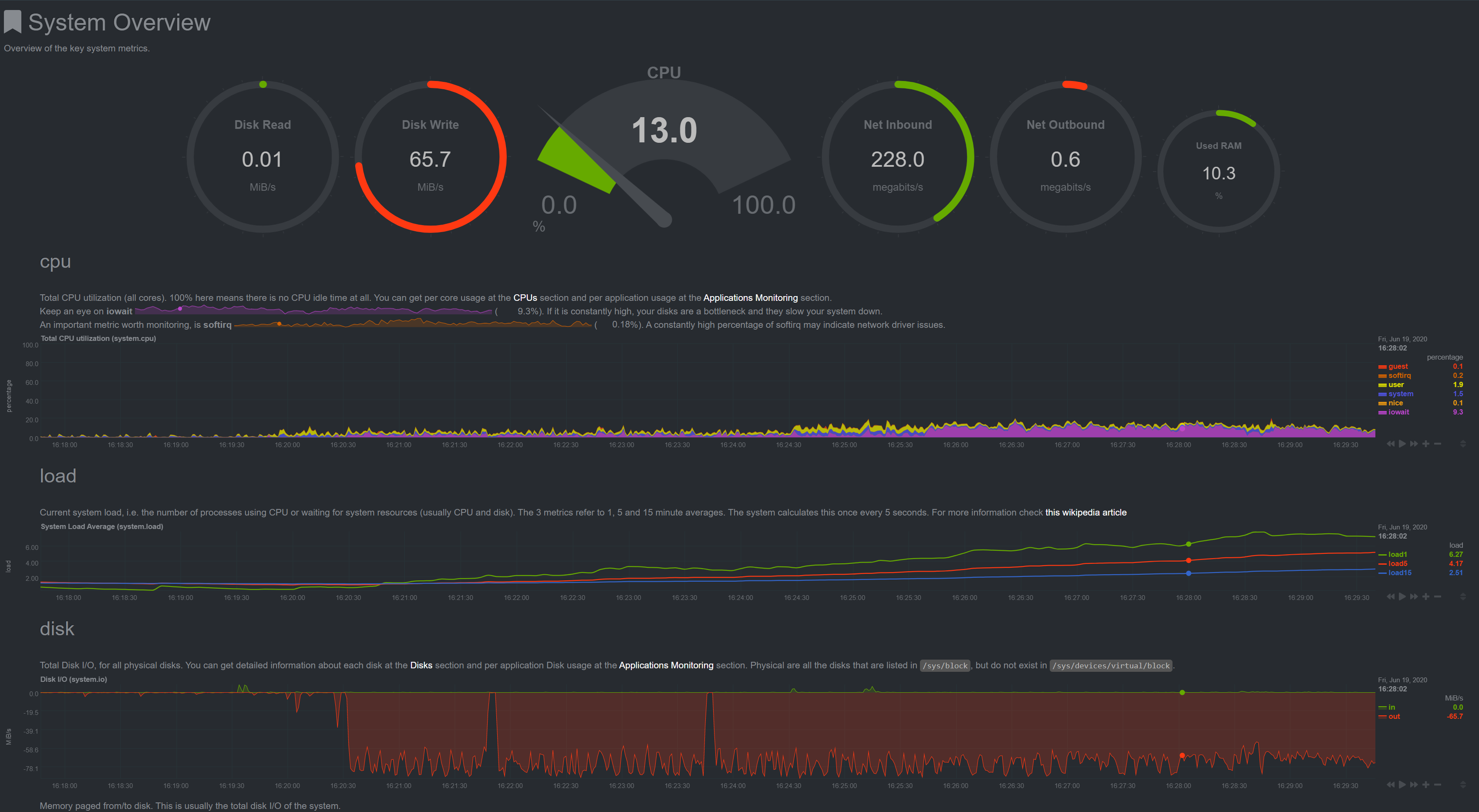

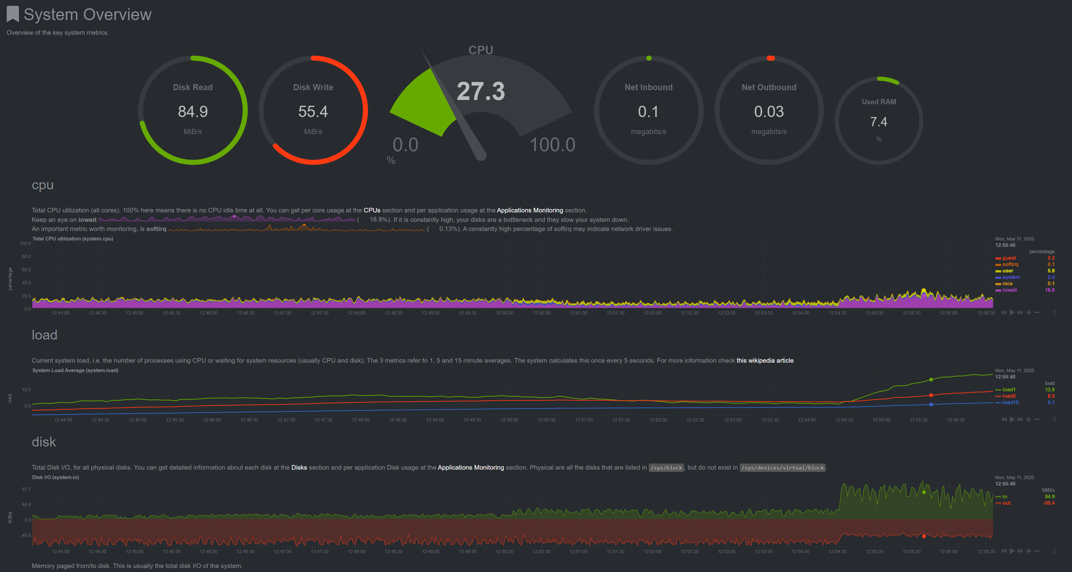

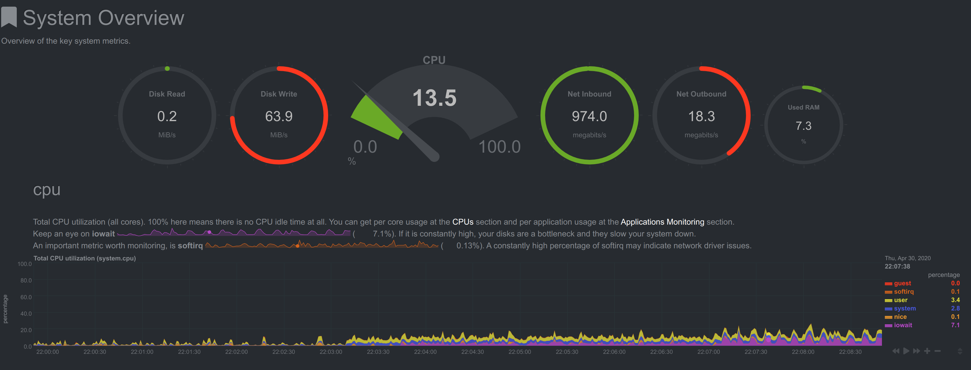

Further experimentation .... Feeding it 1Gbps shows stress still (again though I'm not sure what's normal for a rig like this)
  • Replies 210
  • Views 30.6k

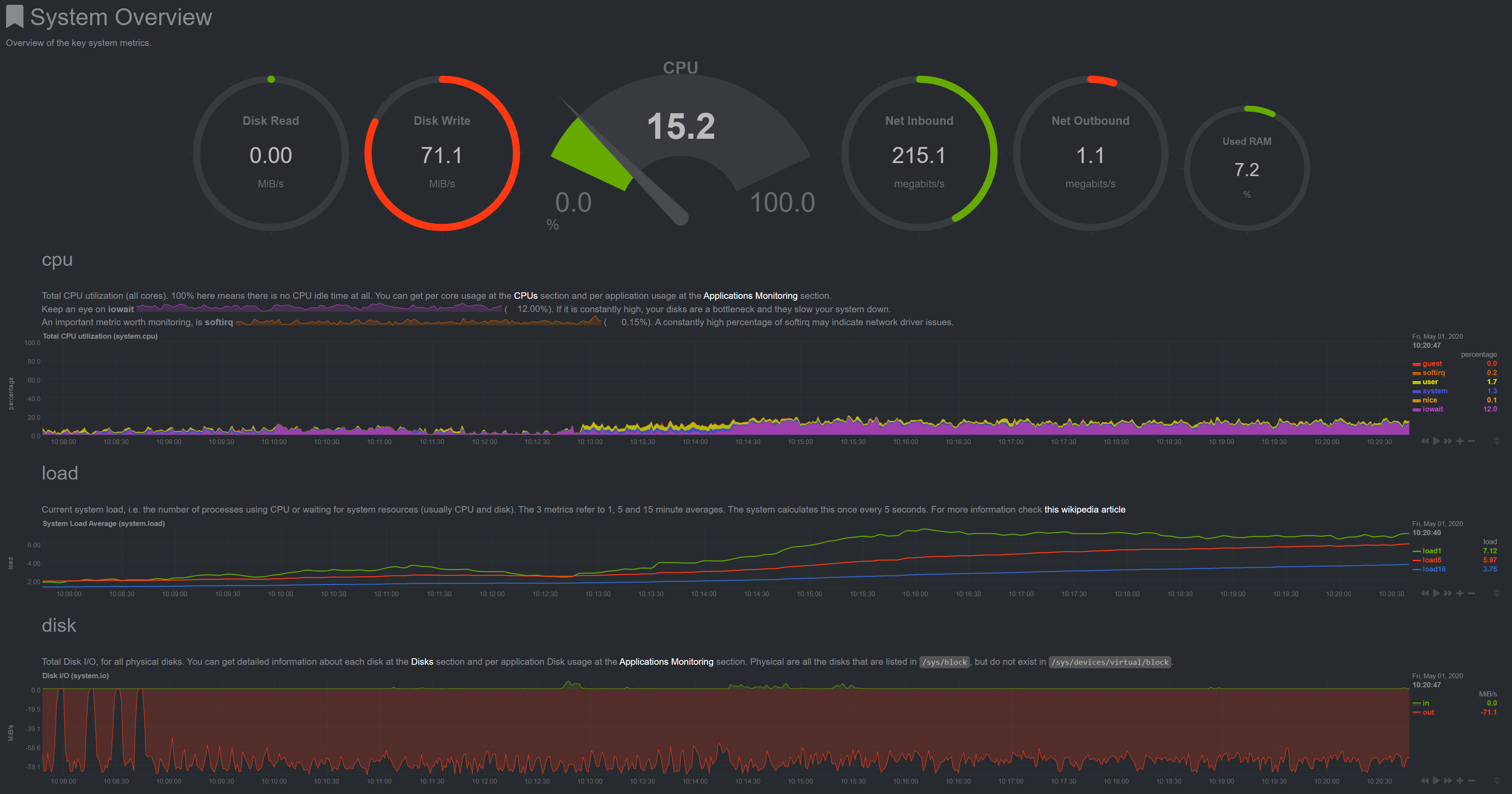

And... so after sustained load we see the issue crop up again, not as bad as before, but still pretty terrible performance.
Help?
I mean, it's not killing other services like it once was... but the IOWAIT is still very very high

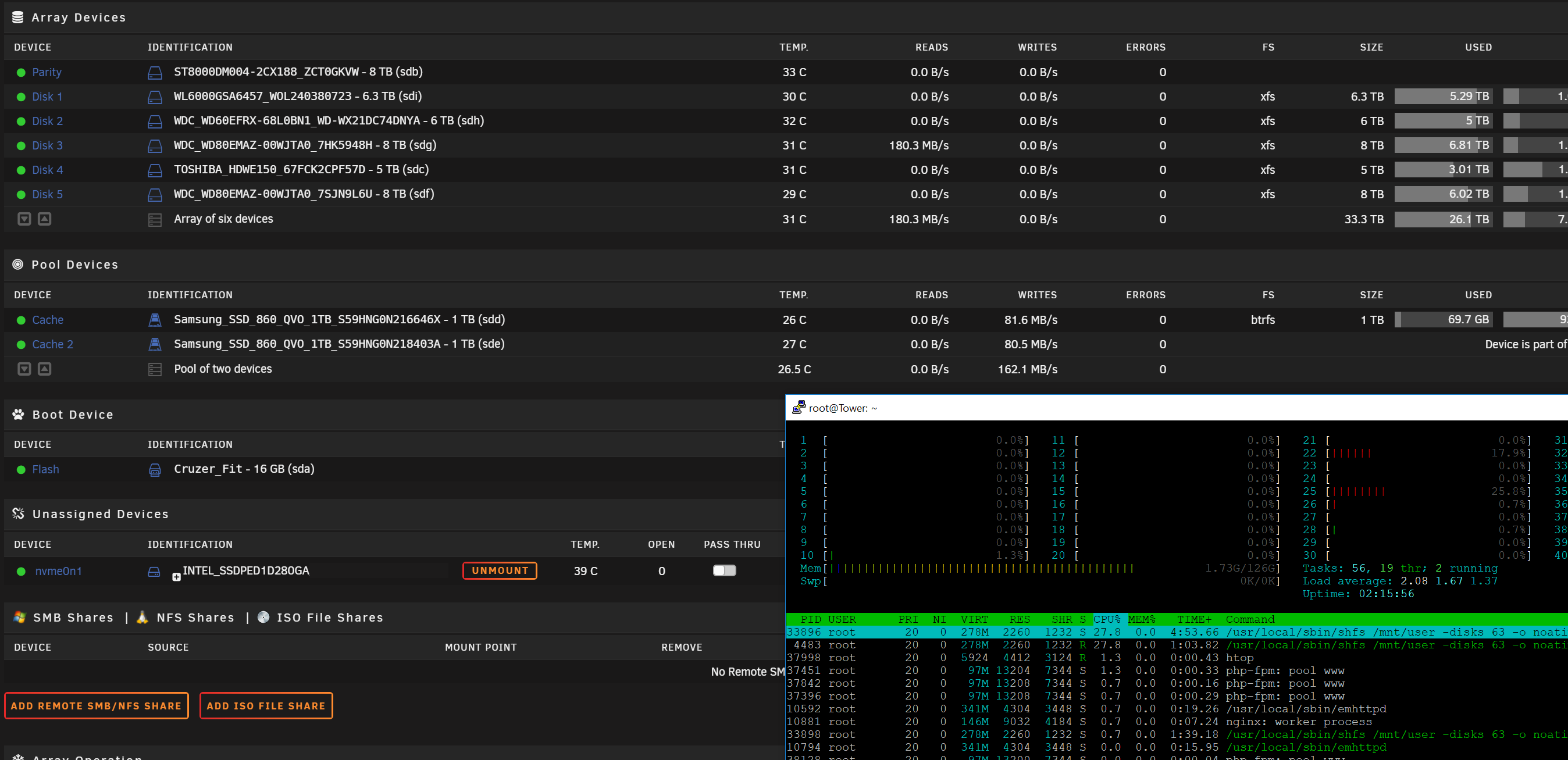

OK, finally have time to do this. From the shell on unraid I don't get iotop... I installed it via nerd tools
But get this
:~# iotop
libffi.so.7: cannot open shared object file: No such file or directory
To run an uninstalled copy of iotop,
launch iotop.py in the top directory
This seems to be an ongoing problem, even with XFS and no pool.

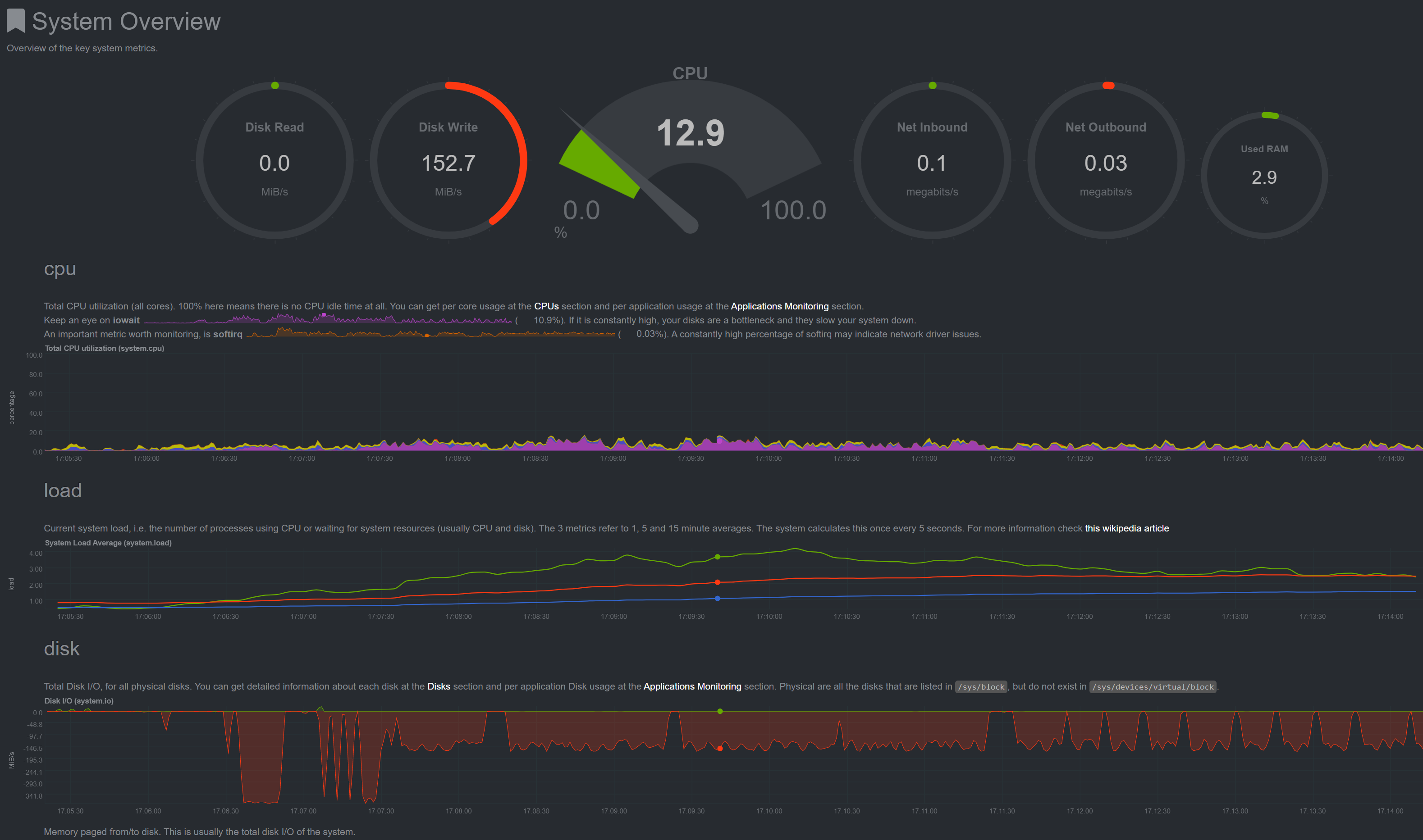

This never used to happen, and now even after moving away from a pool it's still beating up the system. It's livable, as in other services don't fall off completely, but it's still way more impact than prior.
This isn't working for me. I mean at this point, my server basically does only Plex and download media files because it can't handle anything else. And this is a decently stout machine (dual Xeon E5 2690v2 with 128G RAM).

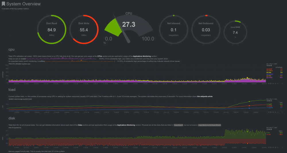

So far, docker disabled while using the mover to get files back onto the cache.... Looking like it's the same sorta CPU usage only it's not a sticking to the same thread pairing hung at 100% .... will test when everything is back the way it should be

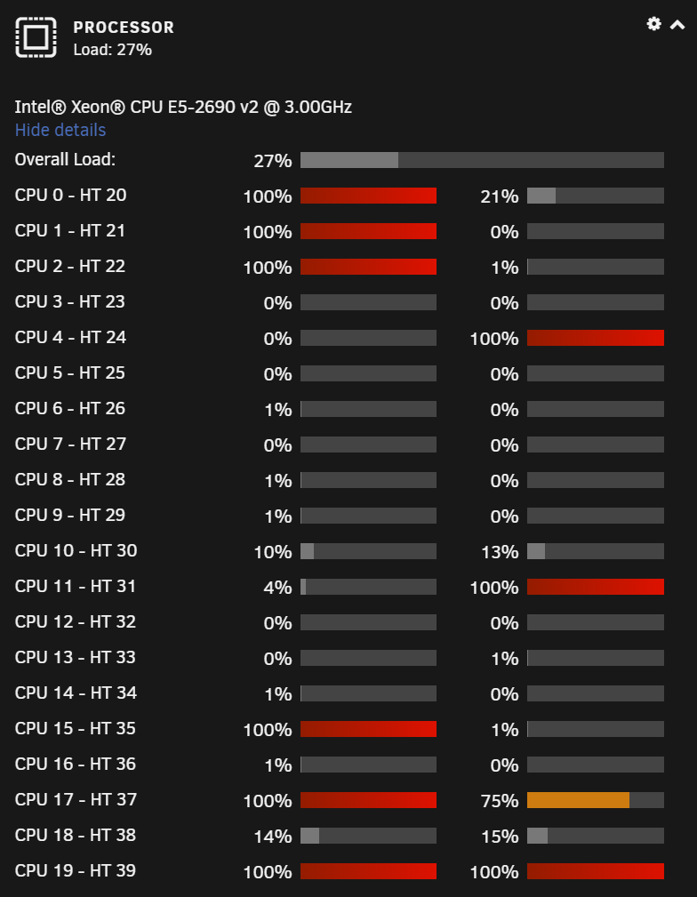

I'd say this isn't any better..... Gets into the 20% range, downloaded a 40G file / unpack / etc... All on cache
What else can I provide to help isolate the issue? This is killing my server. Crushing it just to copy one file... this is rediculous.
