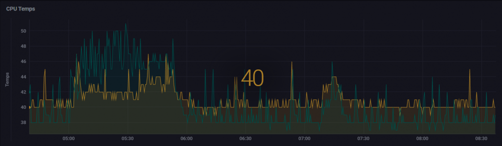

On 2/4/2022 at 10:10 AM, CowboyRedBeard said:
But at this point, the high IO wait is actually bad enough to raise the fans and CPU / PCM temps for sustained periods
That seems very strange because during IO wait the processor is basically at idle waiting on the IO to complete.

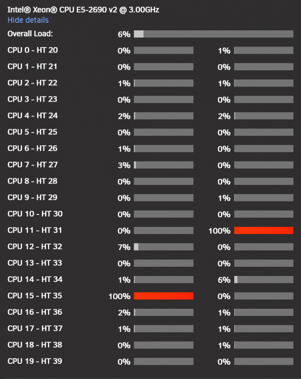

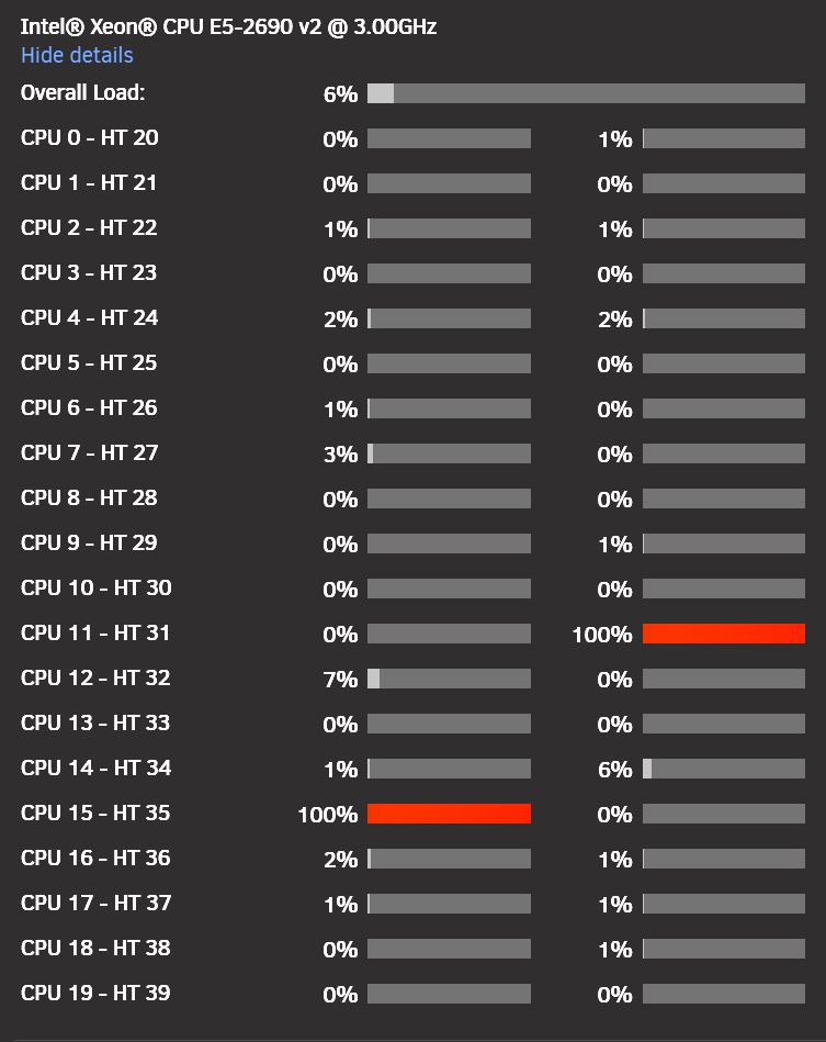

Yeah, but if you watch the threads... those are hung at 100% so maybe that's why?

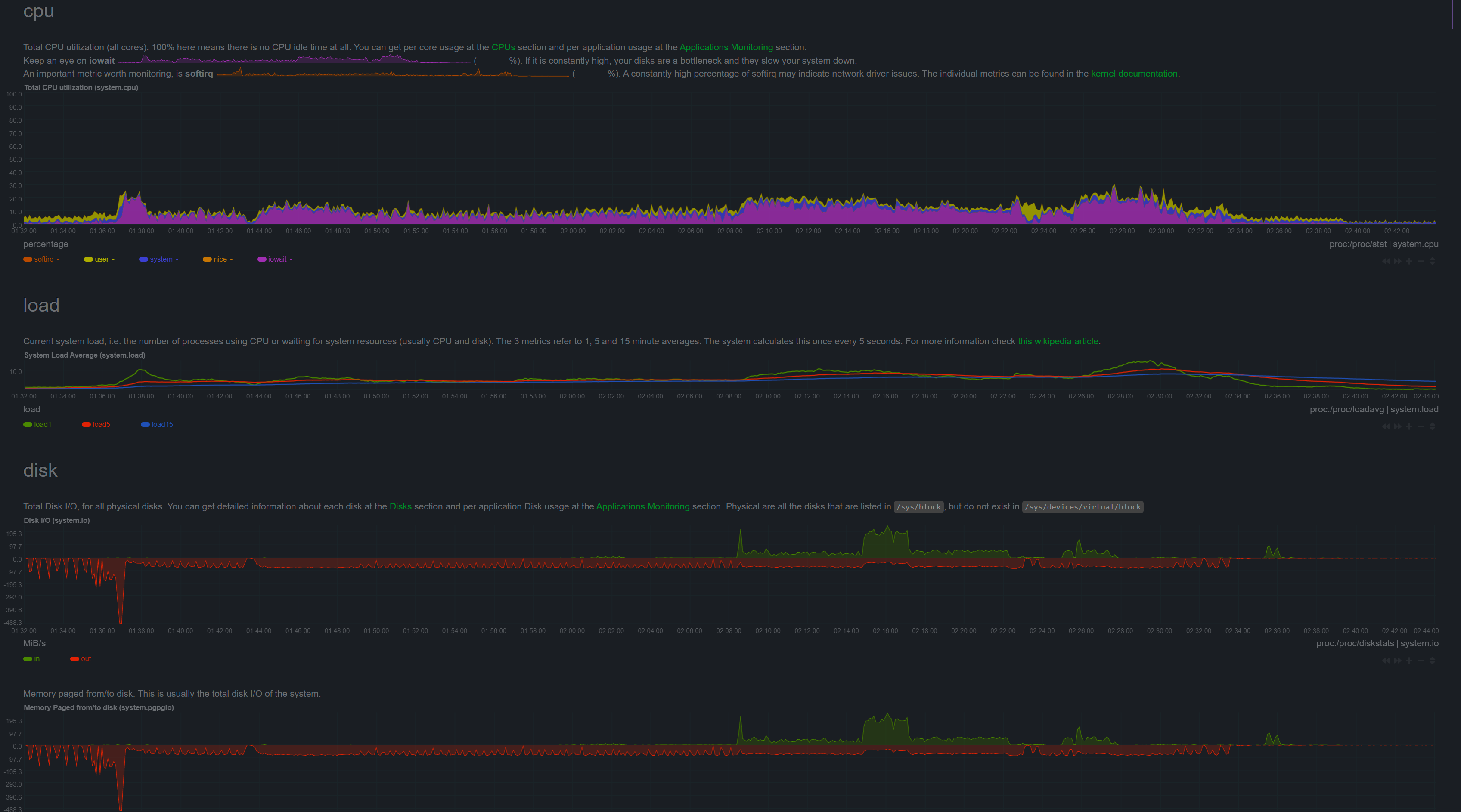

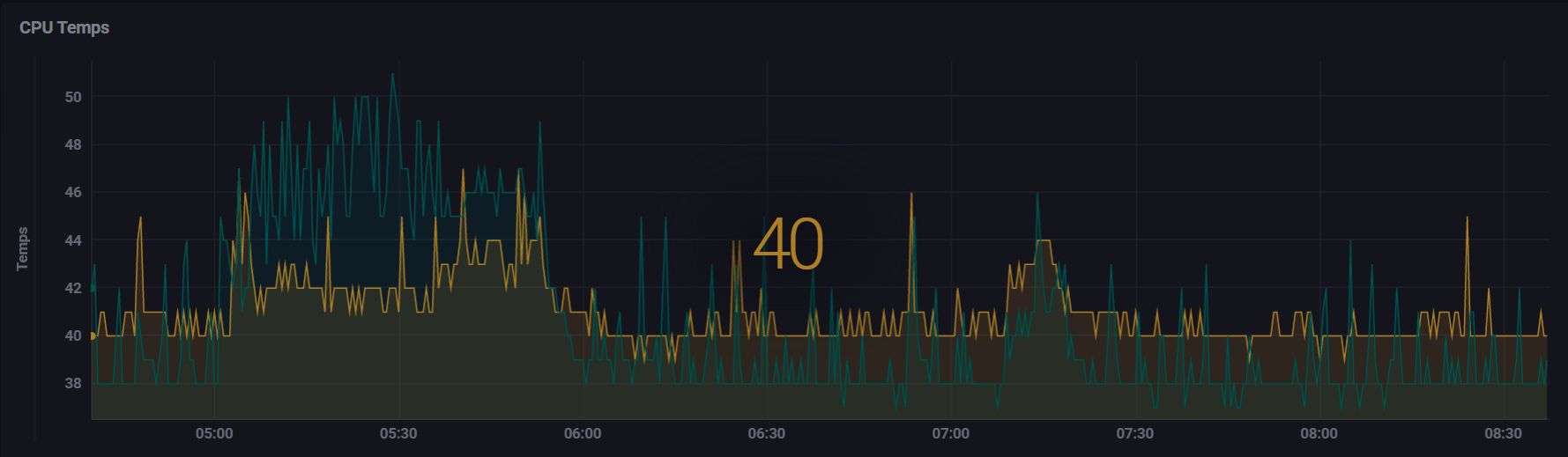

And I track fans / CPUs via IPMI. You can see it here (mover kicks off at 5:00)

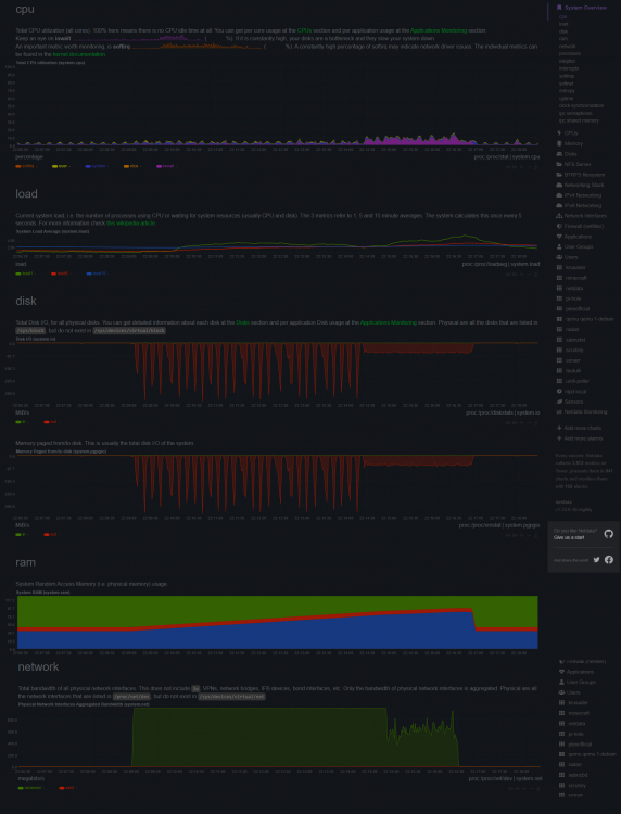

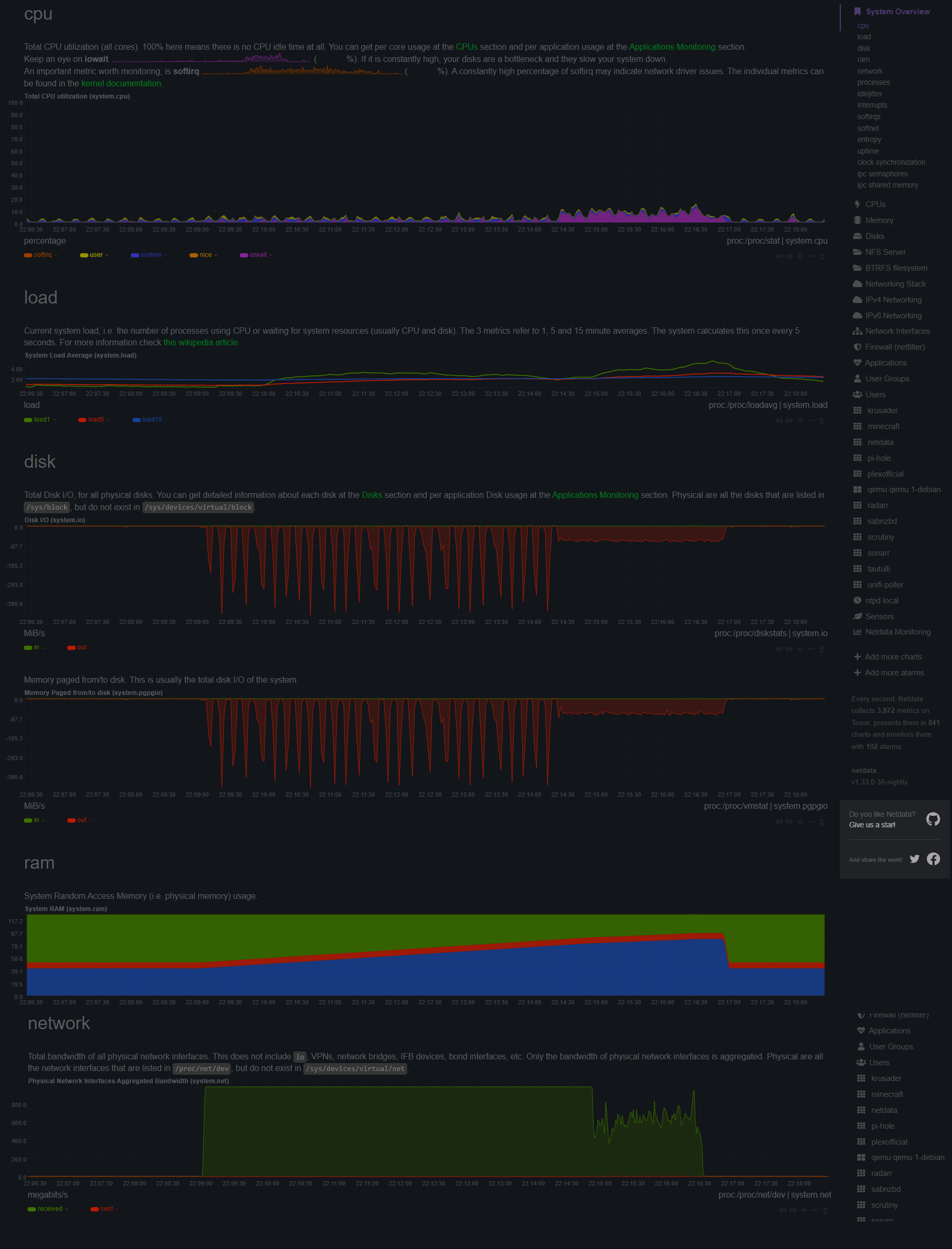

Like here is me copying an 85GB file, across the LAN via SMB to a share which uses the cache drive. As you can see, the server is receiving at nearly a full 1Gbps on the network interface, and it's flushing the file to the cache drive in bursts of around 400MiB/s... until about half way through the file copy which was about 5minutes to this point. Then the system falls back to a steady stream of 80MiB/s of file write speed...  ¯¯\_(ツ)_/¯¯  So it doesn't seem to me to be a hardware problem.
The dashboard takes into consideration I/O wait on its graphs.  Depending upon how you look at it it's either right or wrong.  It's wrong because the core isn't actually running at 100% (rather it's idle waiting for the data transfer and the processes can't continue without it) or right because the core isn't able to do anything else while it's waiting for the transfer to happen (so it's effectively at 100% from the user's point of view)
How long is mover taking to run.  On one of your old diagnostics every day at 5:30 you had the drives doing a trim at 5:30.  During that trim operation, all transfers to and from the SSDs are effectively paused due to I/O wait.
I recently moved trim to 08:30 and have mover set to start at 05:05 ... mover takes different amount of time based on how much was downloaded by SAB that day.

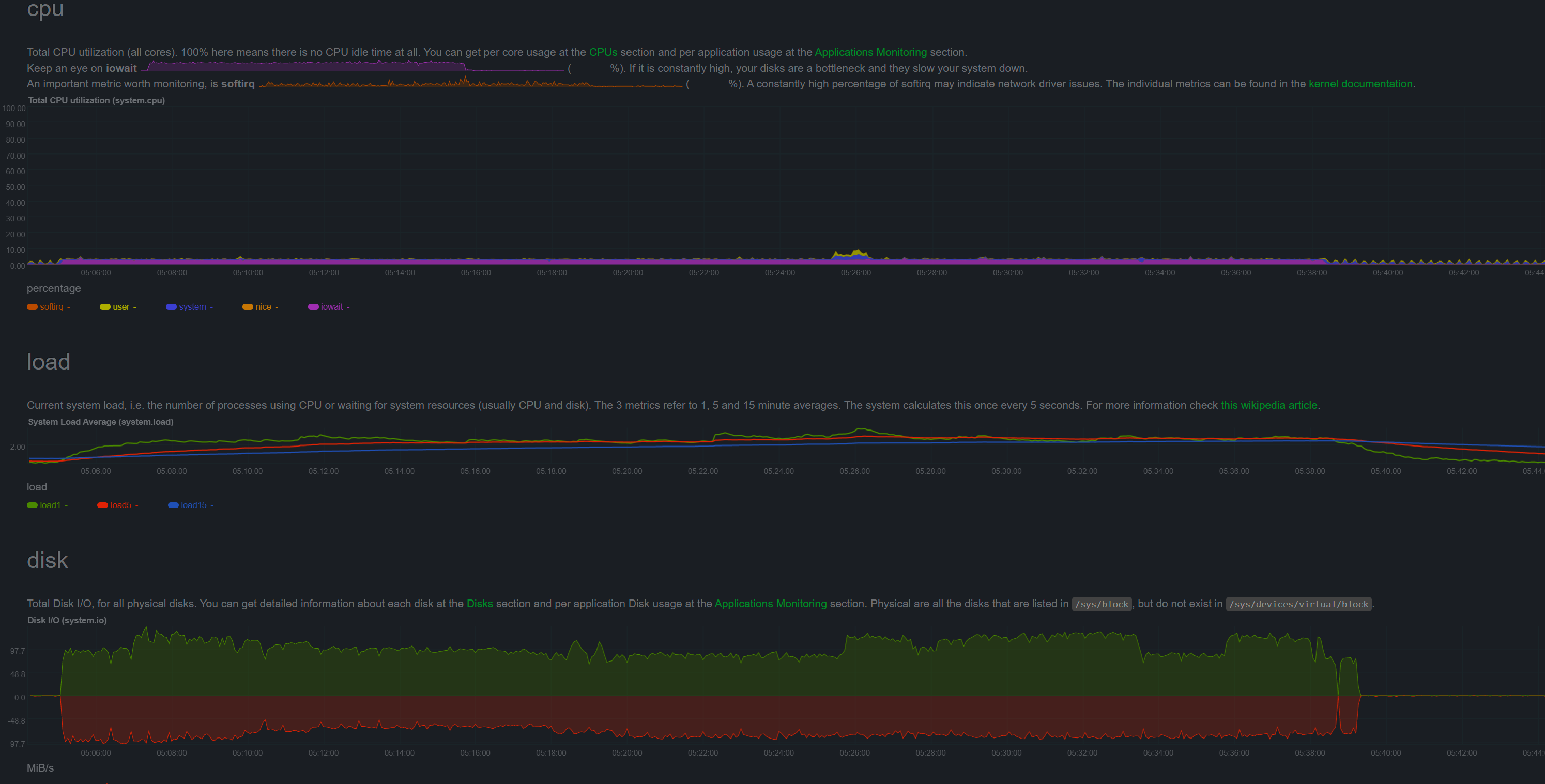

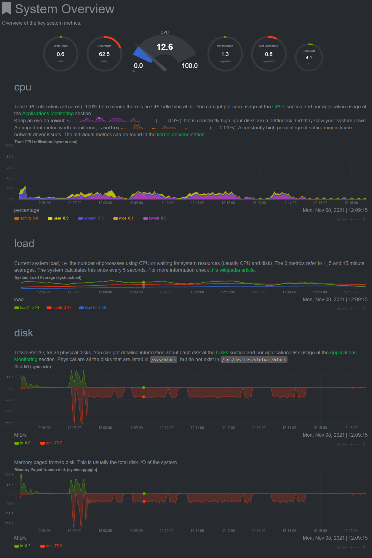

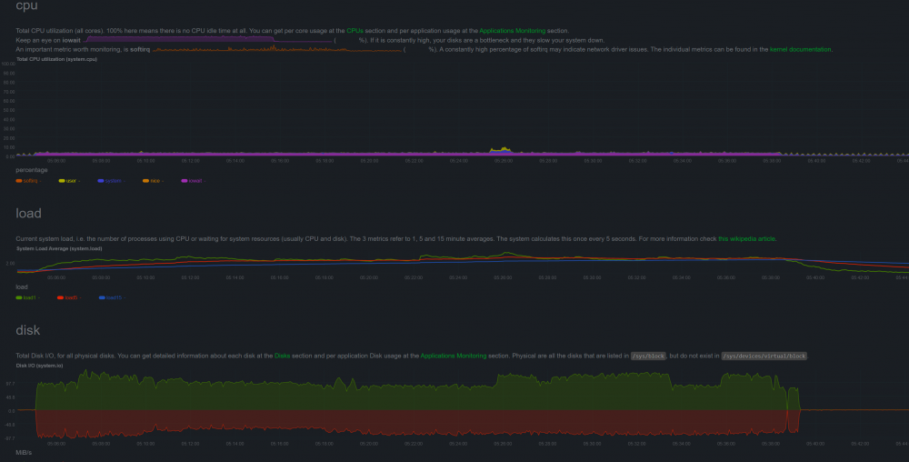

So this is last night, downloads start at 1:30... which you can see it goes up to 430'ish MiB/s... and then IO Wait goes up as high as 22% and write speeds level off at 80MiB/s

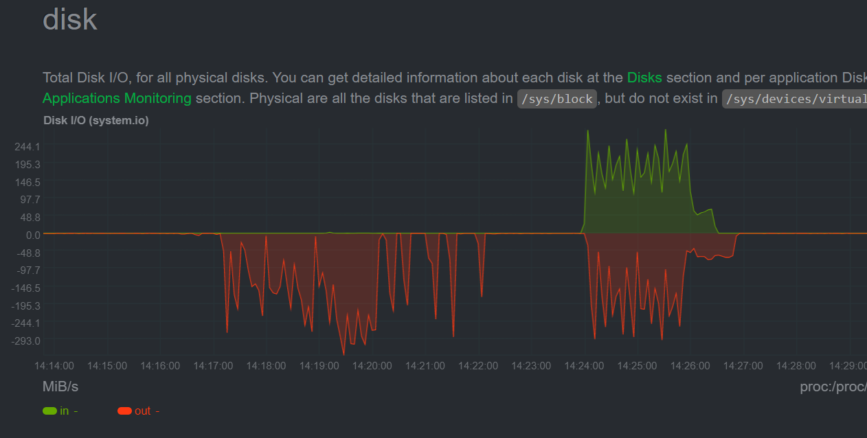

Then this is when the mover starts:

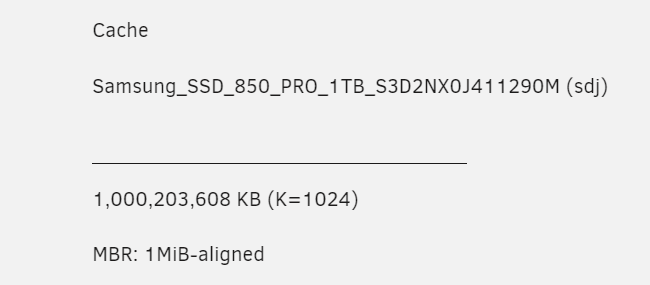

First look at your SSD disks and be sure they are formatted like this:
For best operation, they should show 1 MiB-aligned.

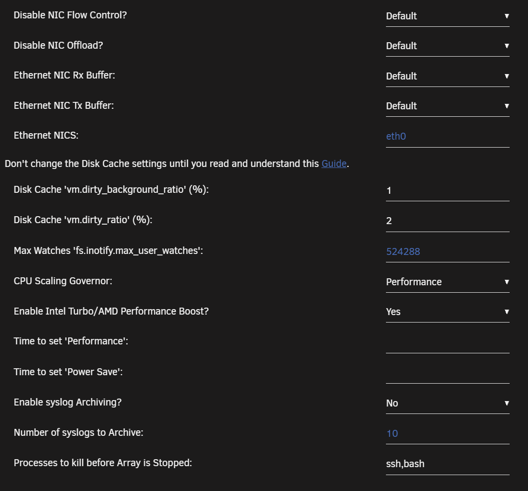

Give me a screen shot of the Tips & Tweaks page so I can see what you've 'Tweaked'.
No apologies needed, I appreciate the help!
Ok, I like all your settings.  Now review the issues with me.  Lets start with non spinners and work our way up from there.

Probably the posts on this page are a very depiction of the problem as it appears currently. But essentially, with any file write process to cache I end up with high i/o wait times. I will see the cache drive able to write at around 300MiB/s for just a minute or two and then after that it will only give around 80MiB/s after.
This shows up in netdata and on the unraid dashboard as in the following posts:
And in that second one you can even see the CPU temps rise, which as was mentioned here was thought to be odd since it's just "waiting" ... but I monitor CPU temp / Fan speed with IPMI and then send that data to influxDB where I can trend it (which is that graph in the second post)
Happy to conduct any tests you think are meaningful and post the results here. But primarily I see this with cache drives only (spinning disks don't obtain the same sort of speeds so I guess the system can keep up with them). And, I also see this if it's Sab downloading / unpacking a file, or transferring data to or from a non-array / non-cache SSD.
What you are seeing is the disk caching happening with Linix.  It will initially fill the ram disk cache and then start writing to disk when the disk cache gets to a set threshold.  These are the Disk Cache settings iin Tips & Tweaks.  If I recall, you have 128GB of ram.  @ 1% dirty background, that's 1.28GB.  A file transfer will fill that ram cache before committing to disk.  That's why you are seeing high speeds on a reboot, because the disk cache is empty.
You're theoretical max is about 100MB/s your 1GB network.  Honestly, the 80MB/s is reasonable really.
I want you to do some adjustments in Tips and Tweaks to the network though and let's see if it helps:
  • Disable NIC Flow Control.
  • Disable NIC Offload.
  • Set Ethernet NIC Rx Buffer to 1024.
  • Set Ethernet NIC Tx Buffer to 1024.
These settings help on Intel NICs at times.  See if that improves your speed.
