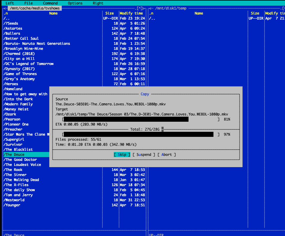

So in my scenario i can write with almost line speed to the cache (125Mbyte/s) . However moving from the Cache to the disks seems super slow and the wait IO goes through the sky.
I will try tonight to copy from Cache to the Disks via i.e. unBalance. Lets see what happens then.
If i copy via "mc" the speed is within the expected range.
No wait IO either.
Brings me back to the point - something is wrong with the mover ?
Btw. the array is up, and 2 persons streaming (locally) from disks 1080p.
I am easily reaching speeds >170Mbyte/s - so i would exclude neither the sending controller (LSI 2008 IT)
nor the receiving controller ( Perc710P ) .
So what's wrong with the mover and BTRFS ? Looks to me as if I should try as well to move to have my two SSD's converted to XFS and get over it?

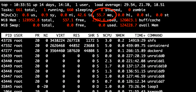

Oh and i should add - of course this is while the "mover" is running... And IO wait is >30% .

THe server is all of a sudden suffocated with Wait IO .
