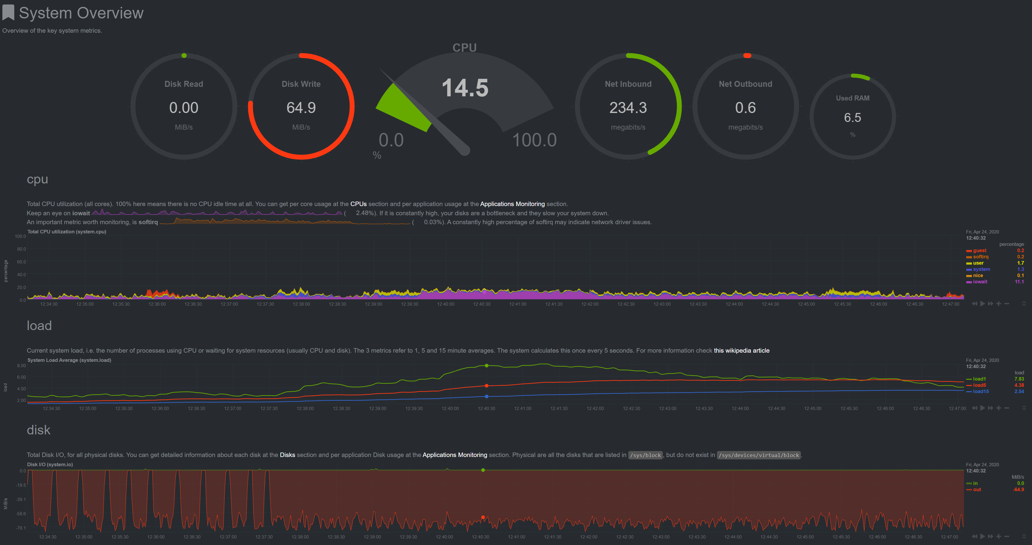

For me, basically it's any time I'm doing file operations of size on the cache drives that I have this issue. I guess I could split the pool and have a single cache drive formated to XFS. My Optane card is XFS and it doesn't exhibit the issue. However, I'd kinda like to have it work the way it's supposed to instead. I have a pool so that everything is redundant.
Since this seems like something that's not going to be fixed for a while, could someone help me understand the correct way to split my cache pool and then make use of a single drive formatted to XFS?

Results are in.... DEFINITELY an issue with BTRFS (and something?)
(This is a 26G file)
Now... who can help me get rid of these horrid looking triangles? ( i know, it's because there's no pool now)

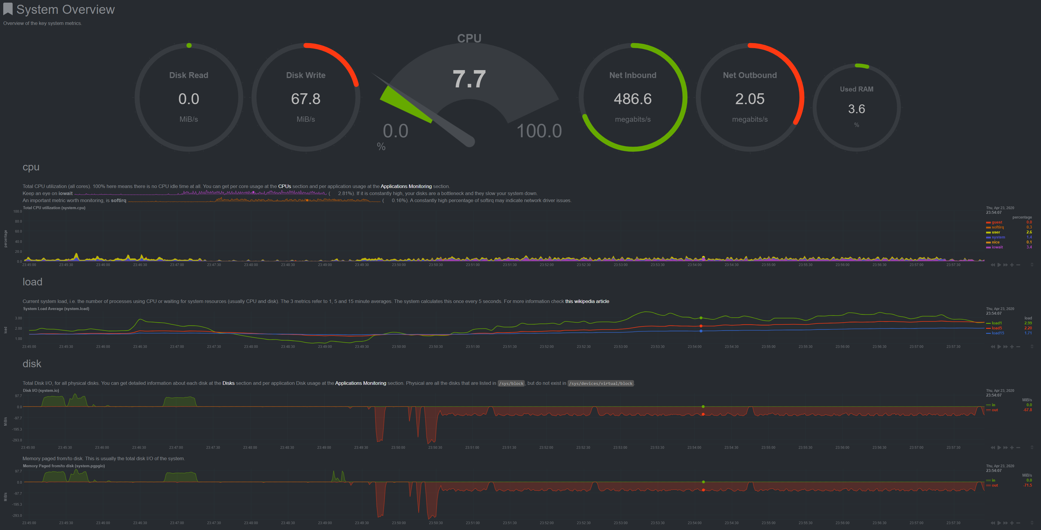

Back to my problem... I see what I've done here with the single drive on XFS as a work around. How can I get back to a cache pool with the same performance?
I did beat up on it a bit with about 100G... results show the issue as MUCH less significant... still a good amount of IO Wait, but I'm not sure what's normal.
