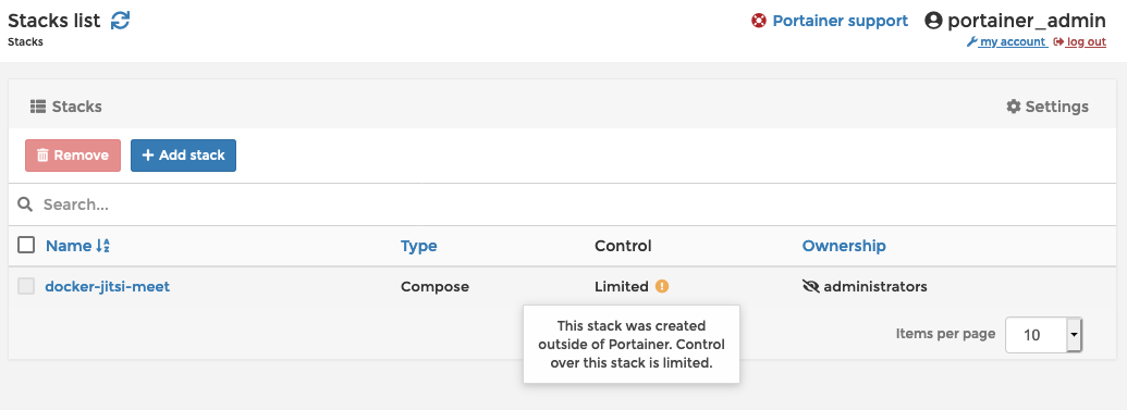

4 questions.
1. How do you remove a user
2. Is the previous post for updates the recommended method for updates (then re-setup authentication)?
3. Having problems when 3rd person joins we loose video to person who joined second.  I'm running on a G4900, is it a CPU limitation? (I have a i3-9100 on order). Seems to be a related issue but not sure how it relates to our install method: https://community.jitsi.org/t/not-working-for-more-than-2-people-in-the-room/18821/115
4. Is the below "limited" message correct/normal for Portainer?
Thanks
Edited by Flyinace2000
Added #4 and a picture
9 hours ago, Flyinace2000 said:
4 questions.
Thanks
Did some digging
1. and 2 still would like input from the community.
#3 - My router UDP forward didn't save the first time.  Added that back in to forward 10000 to 10000 to my UnRaid server and I was able to get 4 clients into a meeting.  The little G4900 is feeling it though, CPU load doesn't drop below 50% will sit around 80 to 90 for stretches.
#4 matches the video so the "Limited" is as expected

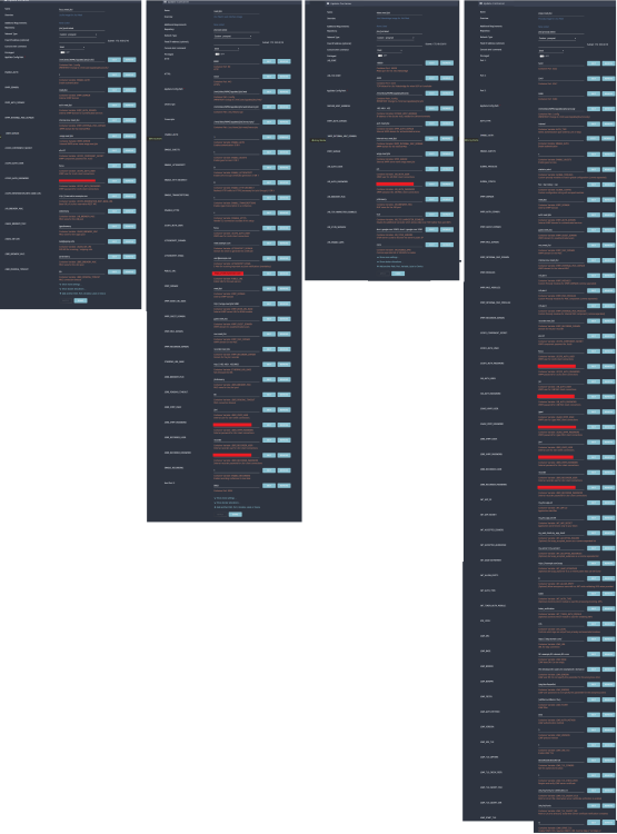

I'm now having the "something went wrong" error that I've seen posted elsewhere. And i'm getting this even after wiping the entire configuration (uninstalling everything including Portainer and letsencrypt and starting over.) I can get to the subdomain on my server, create a meeting name, click connect, allow my camera and mic, then endless loops of "something went wrong" without being asked for credentials.
I am using DNS verification with a wildcard, but i still have the ports forwarded on my router for now: 80-to-180, 443-to-1443, 4443, and 10000 all pointing at my Unraid reserved LAN IP. My plan was to start closing them down and rely on DNS verification once I got everything working. Not there yet :)
I've subbed out actual IP addresses with logical names below. "myunrainlanip" and "mydesktopip" are what they sound like
The issue I had earlier where Portainer lost the ports magically went away after a reboot. They were always showing in the Docker containers, but they weren't showing in Portainer. Clicking on them now: "8000:80" under meet.jisti pulls up the meeting creation screen. Clicking "8443:443" yields a "400 Bad Request. The plain HTTP request was sent to the HTTPS port." Clicking either the "10000:10000" or "4443:4443" under the jvb ports yields "Unable to connect. Firefox can't esablish a conection to the server at myunraidlanip:4443"
In the logs:
letencrypt - is running with no errors
Portainer error: http error: Invalid JWT token (err=Invalid JWT token) (code=401)
focus.meet.jitsi error: Jicofo 2020-06-13 13:28:13.407 SEVERE: [368] org.jitsi.impl.protocol.xmpp.XmppProtocolProvider.log() Failed to connect/login: SASLError using SCRAM-SHA-1: not-authorized
meet.jitsi log (e.g. not an error): mydesktoplanip - - [13/Jun/2020:13:23:27 -0400] "GET /images/watermark.png HTTP/1.1" 200 33340 "http://myunraidlanip:8000/css/all.css?v=4127" "Mozilla/5.0 (Windows NT 10.0; Win64; x64; rv:77.0) Gecko/20100101 Firefox/77.0"
video.meet.jisti log (e.g. not an error): Jun 13, 2020 1:33:33 PM org.jitsi.utils.logging2.LoggerImpl log INFO: Performed a successful health check in PT0.003S. Sticky failure: false
xmpp.meet.jitsi error: focus.meet.jitsi:component [1minfo[0m Component authentication failed for focus.meet.jitsi
mod_component [1minfo[0m Disconnecting component, <stream:error> is: <stream:error><not-authorized xmlns='urn:ietf:params:xml:ns:xmpp-streams'/><text xmlns='urn:ietf:params:xml:ns:xmpp-streams'>Given token does not match calculated token</text></stream:error>
jcp5614e797b580 [1minfo[0m component disconnected: focus.meet.jitsi (stream error)
This is all after a clean restart.
Any help is appreciated.
