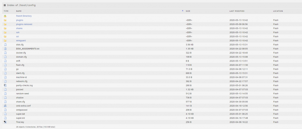

So i coppied the config file and its up and running.  None of my shares are there, and all the disks are Unassigned.  it does say "too many devices" at the bottom, is that because my license isn't linked?  If so, once i link it, i should be able to assign all the drives back and its GTG?

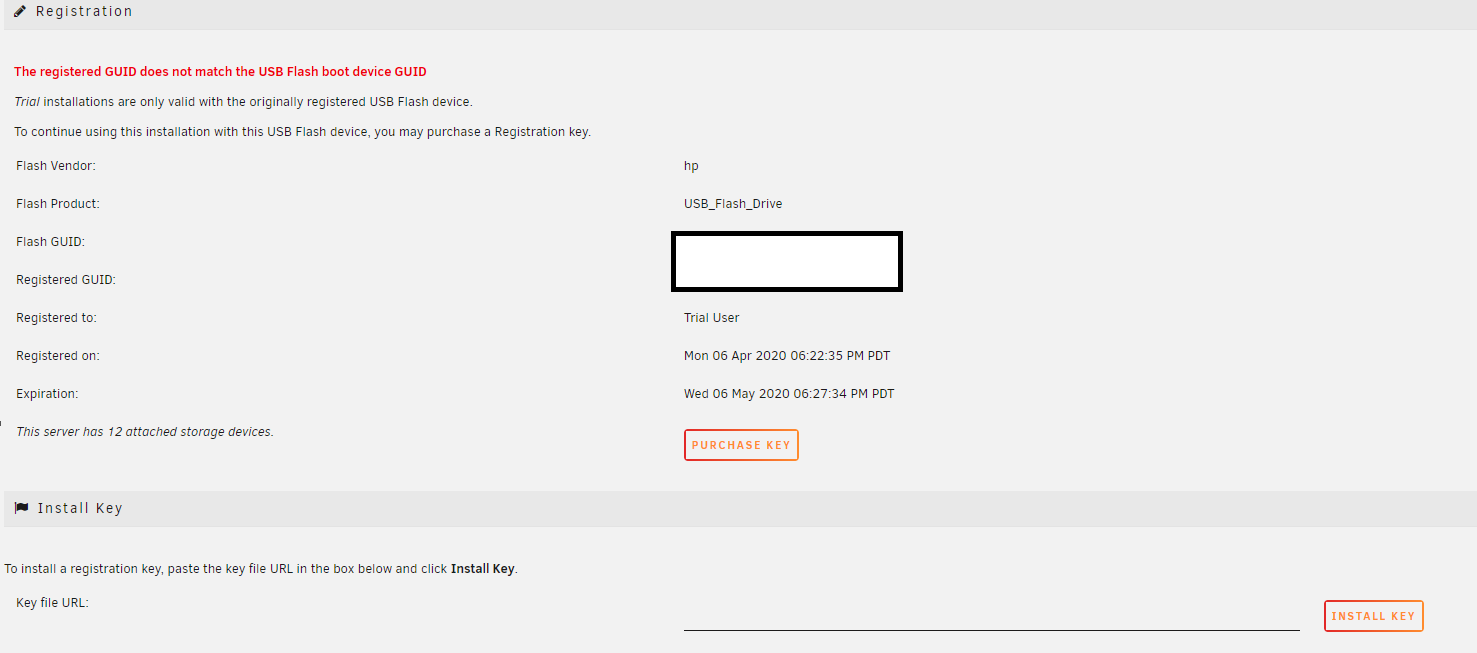

also, to register the license, do i just do what i did before and paste the key address from the limetech email in the "key file URL" area?

The disk assignments are in the file config/super.dat on the flash drive. If you got a good copy of that file from your backup then all your drives should already be assigned, or at least all the drives that were assigned when the backup was made. If you have to assign them yourself then Unraid doesn't remember how they were assigned because config/super.dat is missing or unusable.
For example, if you click on any of those dropdowns for your disk assignments, it will probably allow you to choose any attached disk. If you are sure you know which disks are parity then make note of their serial numbers so you can assign them correctly. The main thing you want to avoid is assigning any data drive to a parity slot since the data would be overwritten with parity.
Also in the config folder is your license .key file. When you boot up with the .key file for the old flash, then it is going to make you get a new .key file for the new flash on the Tools - Registration page.

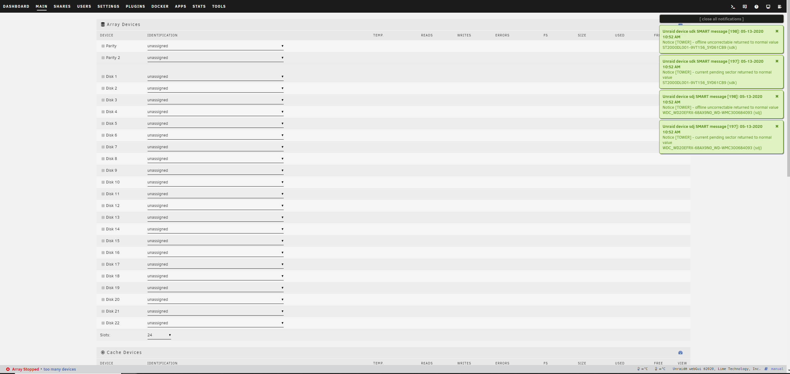

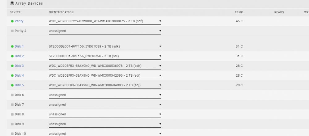

They are not automatically assigned.  I was hoping this was because i dont have a valid key (cant you not start the array until you register a key?)
I do know which of the drives is parity 1 and 2, so those shouldn't be too bad, but as far as the others, i dont know.  You are right that when i click on the dropdown it shows me all the drives.  Do they need to be in order, or can i just select the ones that were on the array yesterday (that aren't the parity)?
i dont think my mobo has any usb2 ports, and the little motherboard adapter i dont think works well (i have boot probelms whenever i try to use it)

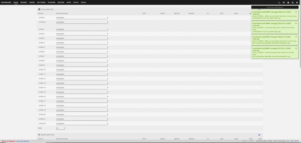

The diagnostics is attached (i haven't assigned any of the drives yet)
edit: it looks like i purchased my key on the 7th and the appdata backup was done on the 9th.  here's what my regisistration page looks like  i dont see a replace key option:
edit2: i'm not 100% sure i know which is parity 1vs2.  I know which disks are the parity's but not sure which one was in parity disk 1 and parity disk 2.  does it matter?

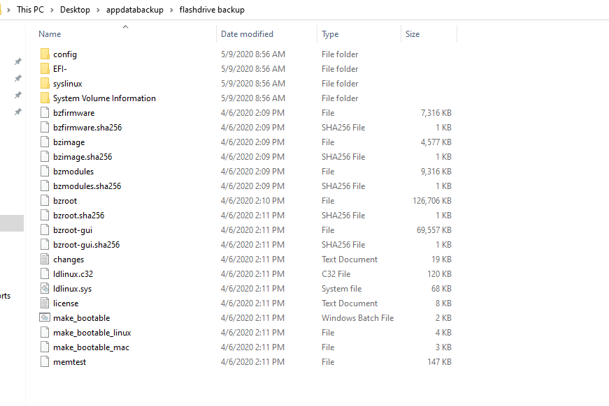

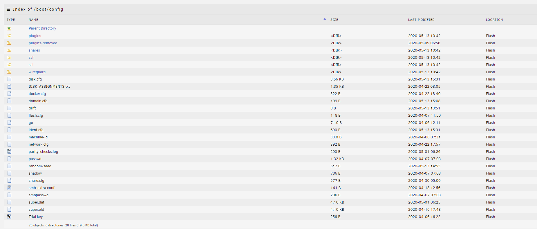

I'm looking at my bakup folder from the 9th and i see that my super.dat file in the "config" folder says "super.dat.CA_BACKUP".  Could this be why its not picking up my disk assignments or is it supposed to have the ".CA_BACKUP" there?
3 minutes ago, danimal86 said:
super.dat.CA_BACKUP
I think that might be it. The backup plugin probably names it that way so it doesn't get used accidentally. There have been cases of people using an old backup from before they changed parity drives and reused parity as a data disk. Since super.dat said that data disk was parity it overwrote the data.

So i should just shutdown, pull the flash drive and remove the ".CA_BACKUP" and see what it does?  if not i can do it from the log you found from my other post?  (thanks for that by the way)
Edit: here's the board i'm using:
https://www.asus.com/us/Motherboards/PRIME-Z270-A/
Edited by danimal86

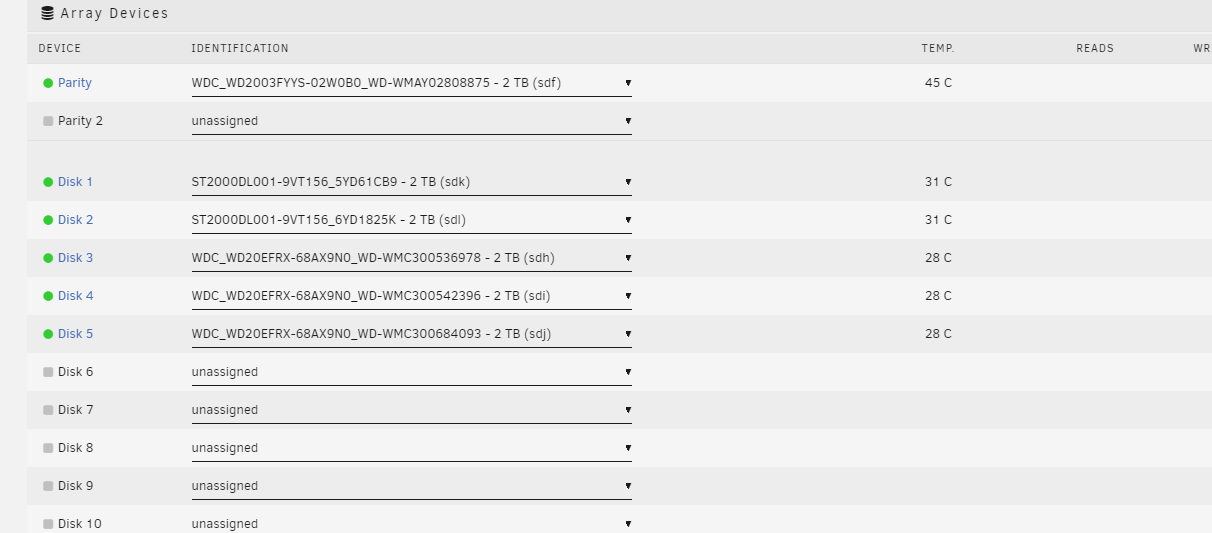

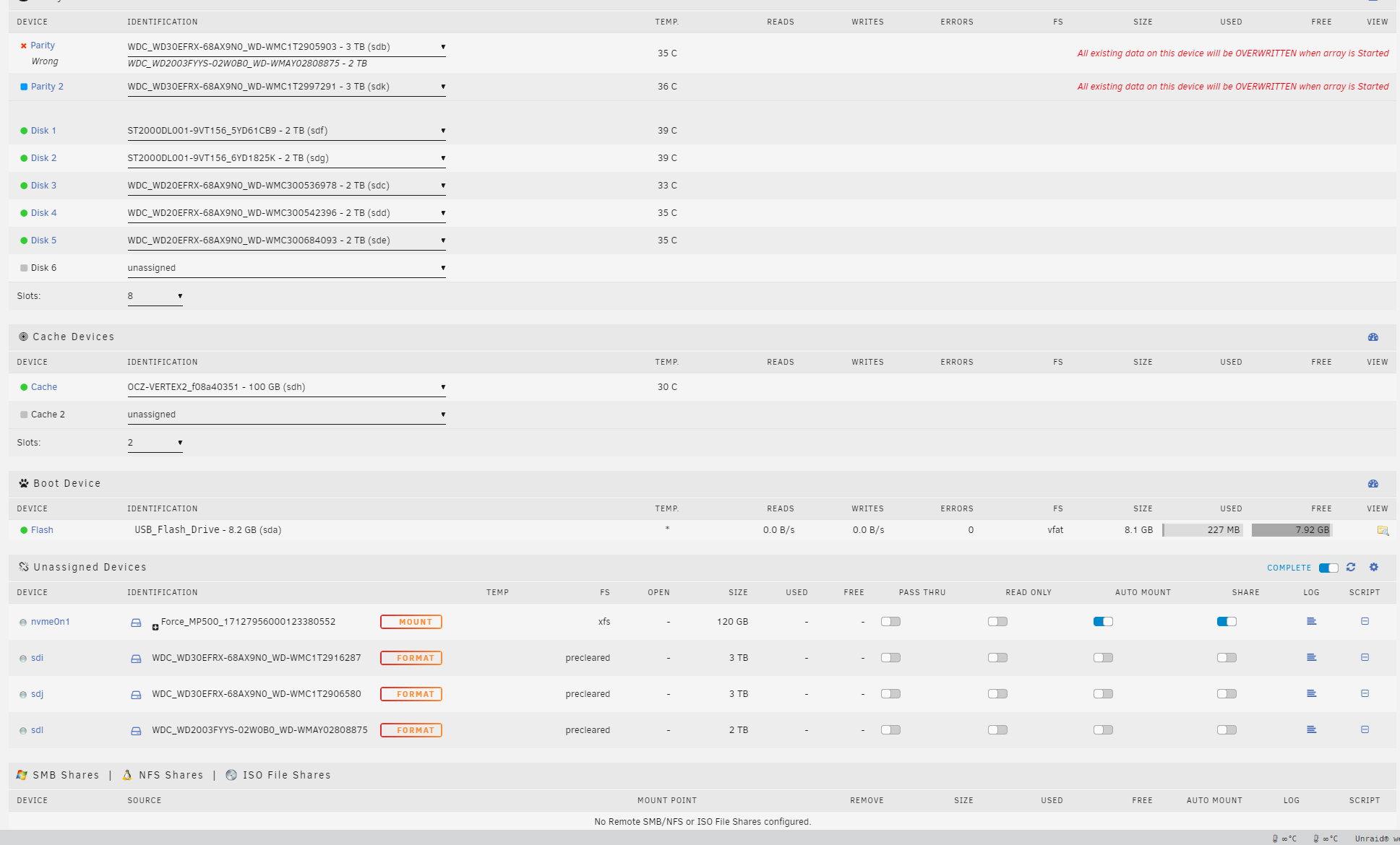

So i removed the .CA_BACKUP and fired it back up using the 4-pin usb 2.0 mobo adapter and got it fired up into unraid.  (it did the blinking cursor for a moment, but ended up firing up)  Here's the disks that it auto populated.  The parity drives are not correct though, there should be two 3tb ones in there.  Can i switch the parity drives to the ones you listed above and fire up the array?

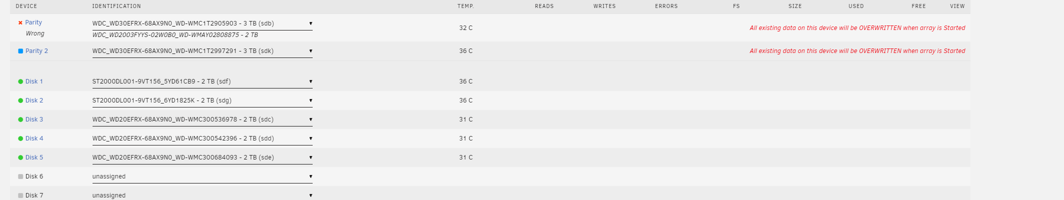

edit: so this backup must have been made before i loaded the second parity drive (3tb disk29) but hadn't replaced the 2tb disk0 yet with a new 3tb drive.  If i change those parity drives to the correct ones that were current as of yesterday afternoon to the correct 3tb drives, we should be good?
edit: this is how the parity drives should be as of yesterday afternoon:  those error worry me
Edited by danimal86

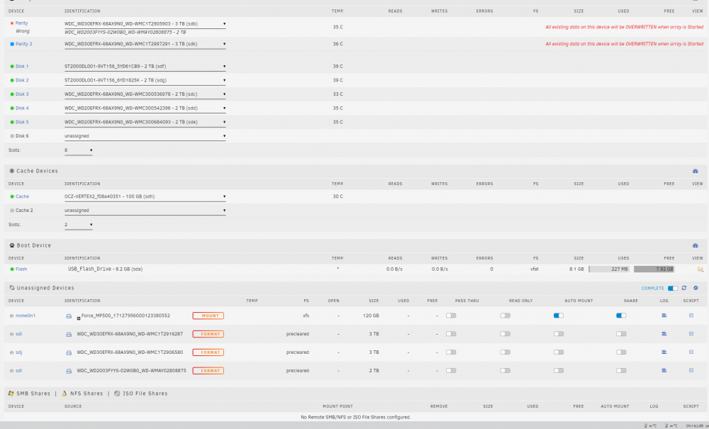

The drives I listed above were exactly those, except for parity2 was not in that backup. And parity2 I listed above is 3TB, but parity is that same 2TB in your screenshot.
Here is the inventory from the diagnostics you posted today, with (notes) of where they go:
May 13 10:51:32 Tower emhttpd: WDC_WD2003FYYS-02W0B0_WD-WMAY02808875 (sdg) 512 3907029168 (old parity)
May 13 10:51:32 Tower emhttpd: WDC_WD30EFRX-68AX9N0_WD-WMC1T2997291 (sde) 512 5860533168 (parity2)
May 13 10:51:32 Tower emhttpd: ST2000DL001-9VT156_5YD61CB9 (sdk) 512 3907029168 (disk1)
May 13 10:51:32 Tower emhttpd: ST2000DL001-9VT156_6YD1825K (sdl) 512 3907029168 (disk2)
May 13 10:51:32 Tower emhttpd: WDC_WD20EFRX-68AX9N0_WD-WMC300536978 (sdh) 512 3907029168 (disk3)
May 13 10:51:32 Tower emhttpd: WDC_WD20EFRX-68AX9N0_WD-WMC300542396 (sdi) 512 3907029168 (disk4)
May 13 10:51:32 Tower emhttpd: WDC_WD20EFRX-68AX9N0_WD-WMC300684093 (sdj) 512 3907029168 (disk5)
May 13 10:51:32 Tower emhttpd: OCZ-VERTEX2_f08a40351 (sdb) 512 195369455 (cache)
May 13 10:51:32 Tower emhttpd: Force_MP500_17127956000123380552 (nvme0n1) 512 234441648 (new disk, cache or UD)
May 13 10:51:32 Tower emhttpd: WDC_WD30EFRX-68AX9N0_WD-WMC1T2906580 (sdd) 512 5860533168 (new disk)
May 13 10:51:32 Tower emhttpd: WDC_WD30EFRX-68AX9N0_WD-WMC1T2905903 (sdf) 512 5860533168 (new disk)
May 13 10:51:32 Tower emhttpd: WDC_WD30EFRX-68AX9N0_WD-WMC1T2916287 (sdc) 512 5860533168 (new disk)
One of the new disks listed at the bottom must be parity, do you know which? Don't know what you intend for the old parity and the other 2 new disks, or for the new nvme.
Yes the WMC1T2905903 is the parity (1?).  I plan to add the other drives to the array (including the old parity), the nvme i was keeping as an unassigned drive that i had plex's appdata on, and the ocz is my cache until i get a bigger/better one.
Here's how i have it, if i start the array (i still dont have the "replace key" button on registration page), i wont loose any data?  will it just rebuild the parity drives or will it be just gtg?
(edit: updated screenshot to show entire Main page)
Edited by danimal86
The only way you might lose data is by assigning a disk with data on it to a parity slot so if you're sure you got parity right you should be good.
It is going to (re)build both parity when you start the array. I put (re) because Unraid doesn't know either of those disks ever had parity based on the old super.dat. Probably just as well then you will know parity is indeed valid. Then you can do whatever with those other new disks and the old parity(1).

Do you have a license .key file in the config folder on the new flash?
Gotcha.  Not really any doubt about what were the data drives, so we should be good.
It looks like its still the "trial.key" .can i just paste the key address from the limetech email in the registration area?
I have never needed to deal with keys since before there was a Registration page.
Go to Tools - Registration and post a screenshot.
let me know if those guid numbers should be redacted.
I don't see how it could matter but I have deleted the screenshot. I can look at the edit history if I want to see it again.
Can you go to the emailed URL directly in your browser and download the key instead of pasting it into that page?
11 minutes ago, trurl said:
I don't see how it could matter but I have delete the screenshot. I can look at the edit history if I want to see it again.
Yep, i clicked the link, downloaded the key from the email, removed the "trial.key" and replaced it with "plus.key".  I guess i just have to hit "replace key"?
