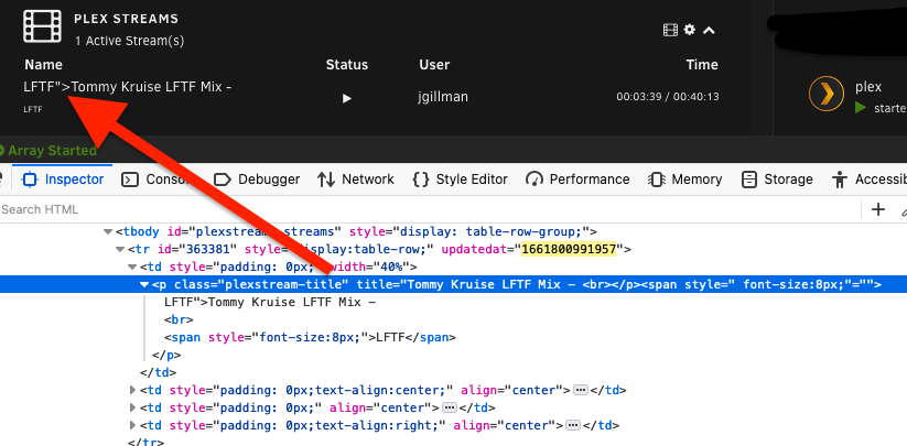

Bug report! Seems like the "title" attribute (code here) is leaking when there's HTML in the stream title. I've only been using Plex Streams for a couple days but I would imagine that "stream.title" isn't expected to have HTML in it.
I love being able to see the streams on my dashboard!
Thanks I'll get this fixed ASAP.
Updated plugin has been released to address this issue.  Sorry I dont use plex for audio too much and there is where the issue occurred.
Great! Thanks for the quick fix.

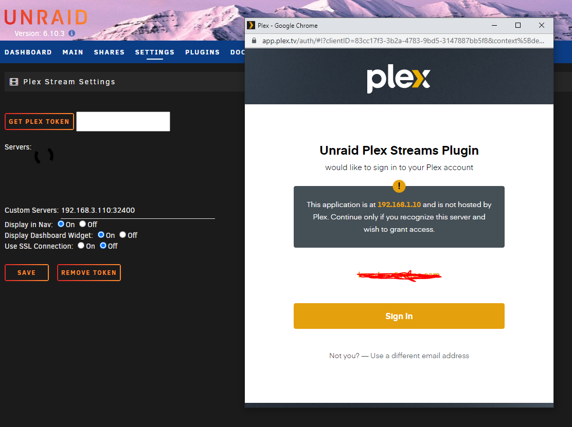

I have installed this plugin but am having trouble getting it to detect my Plex server.
My server is on a docker VLAN (192.168.3.xxx) and my unRAID server is on the 192.168.1.xxx subnet.
Plex Stream will not detect my server.  When I tell it to get a token, it wants to login to Plex at 192.168.1.10 (my unRAID server IP).
Even if I specify the custom IP:port address of my Plex server (192.168.3.110:32400) nothing happens.
What am I doing incorrectly?

Yes, you need to login to plex as that's how it gets a token.  It works against plex's apis.
Yeah, I had tried that via the popup and it got a token but still no server information was populated in Plex Streams after several minutes.  I opened the Plex Web UI first and tried it again and this time it worked.
Thanks.
Thanks.
Once it gets the token you should see it trying to reload the servers list, is that happening?  What browser are you using?  Essentially that servers list is populated by a call to the central plex API, to get the list of servers from them.
The servers list reload attempt was happening but it was just a never-ending spinning icon.  As mentioned, I tried it again (sign in via Plex Streams pop up) after opening the Plex Web UI and it got a token and populated the server list immediately.
Everything is working as expected now.

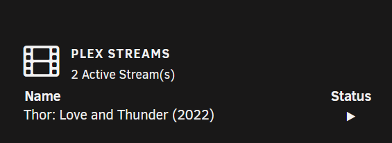

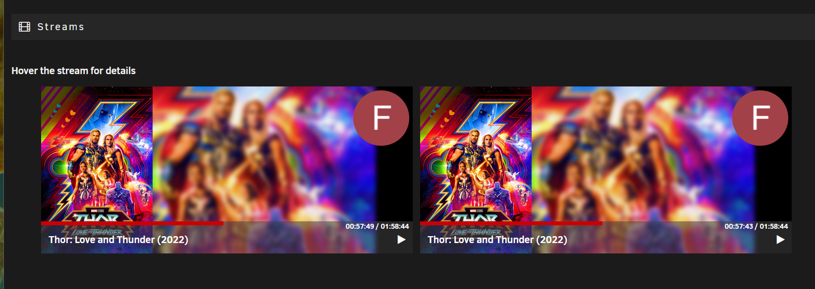

Simple question I had 1 movie streaming buy why Plex Streams report 2 Active? Is this normal?

No this is not normal, can you make sure you only have one of the servers IP addresses selected in the options.
image.png.089ac61d8f908cc60008fe88d6400db1.pngYes only one server IP is selected. It doesnt make any different wither the local or remote server ip is it?
